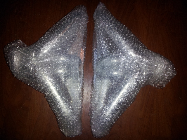

So I get the box from Summit Racing - and the box is sealed up with clear tape ( this is not a good sign ) - opening the box and pulling out the set of headers reveals that I've got this ( sorry for them still being wrapped - you can see the error - these have to be shipped back ).
It should be very obvious that I've got (2) of the bottom header and none of the top header ! ! ! At least I sure don't see any tube being routed up over the top of the header to get to the collector . . .
These are being called back - picked up by UPS at my doorstep, and a new set being shipped out when they get the order.

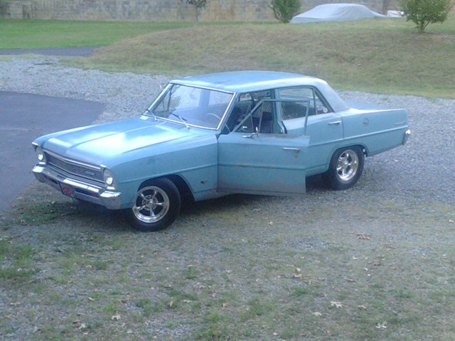

My shoe box - fun little car.
"What a pain" you sure do have some bad luck with ordering. Any pics of the "Shoebox", I really like the Chevy II's "probably one of the only Chevys I like.
Of course 747Mopar . . . first day the guy drove it over to my neighbor's house, I told him I'd buy it if he wanted to sell it . . . 1 1/2 later he sold it to me.
Yeah - it's a 4 door, but I like them ! !
It's had the bench seat swapped for a set of Honda Prelude bucket seats ( leather ) - got them for $50 !
Front drums have been swapped out for The Right Stuff disc brakes - tight fit on the 14" rims ! ! ! !
Found a guy selling a T-5 with the clutch, bell housing, drive shaft . . . would like to upgrade the 3-speed ! ! !
The "young-ins" at my office thought it was an AUTO because it had a column shifter - they had fun driving it though ! !

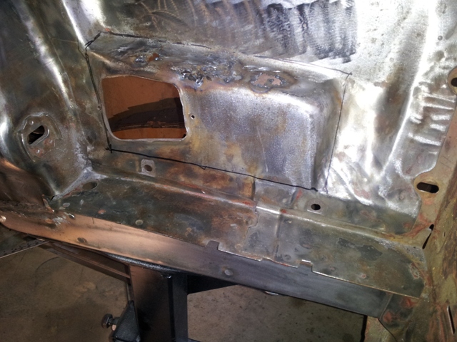

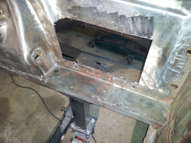

Attempting to weld the area where the battery was located, the metal was very thin and not very easy to weld. So I decided to cut the area out, and fill it in with a new piece of steel and give it a cleaner look and more strength.
Here's the area that I'm working on today:
So I cut it out to figure out how to fill it back in again ( does this seem a little odd ? ? )

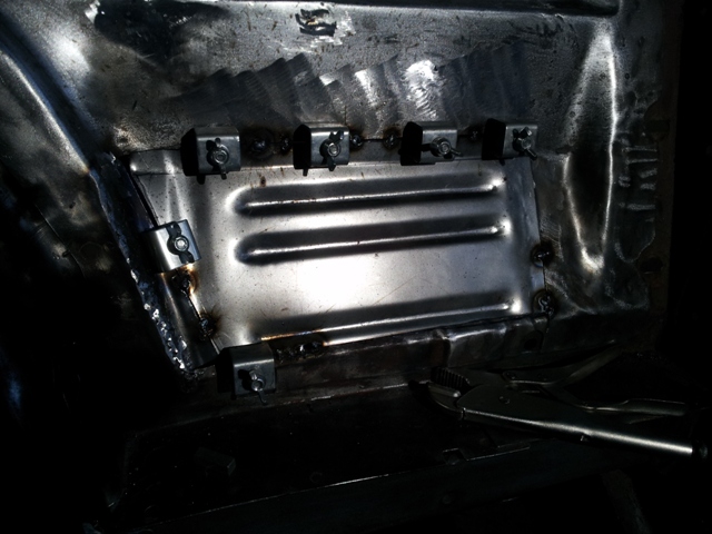

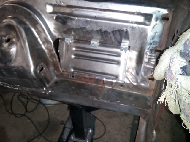

Then I got a piece of scrap metal and started the process of fitting it into the hole . ..
Then I tacked and welded this piece in to follow the curve of the shock tower . . .
Next I got it fitted in place with my neat little clamps . . . and tacked into place . . .

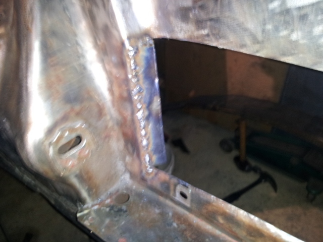

Then started doing some grinding to get the weld taken down and finish up the work.
I'll re-shoot the last picture - not sure why it turned out so dark . . .

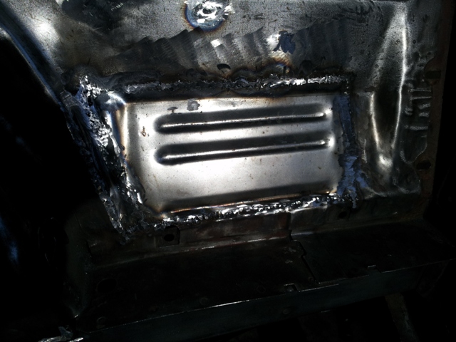

Not too bad, but still had some "fun" trying to get it welded into place ( guess I still need more practice ) . . .
Still got a bunch of grinding left to do on this area to get it presentable - but it's in place now !
I like the idea of putting a flat piece in there "should look really nice". I'm curious to see a better pic after your done cleaning it up to see how those recesses look in there.
I'll get a better pic 747Mopar . . . the beads are due to it being extra flooring that I had for the car - tried to fit it in and make it look good at the same time.
Seems to have worked out pretty well - we'll see how it turns out when I'm done . . .
Worse case - cut it out and replace it with flat sheeting . . .
