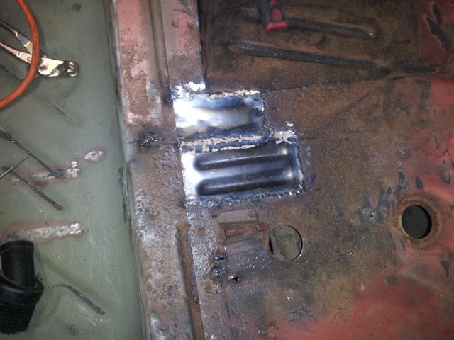

Now I've got some Questions:
The car has a bunch of holes in the floor pan with plastic "plugs" installed.
Are they "necessary" ?
What's their purpose ?
Can they be welded up solid? On the parts I replaced, do I need to re-drill them out and replace them ?
Seems it would be better to just seal them up and be done with it ? ? Any help would be greatly appreciated ! ! ! !

I didn't replace them. The big ones are drain plugs if you flooded the car and the small ones are usually for holes the factory may have used for a different seat or whatever. So just redrill the ones you need and leave the rest or weld up as you see fit.
I didn't re-drill any but then again I only replaced the trunk floor and was able to save the floors with some patching. With the plug kits being as cheap as they are it just seams like allot of extra work for something you won't see but hey "it's your car and if you don't like them then weld them shut".

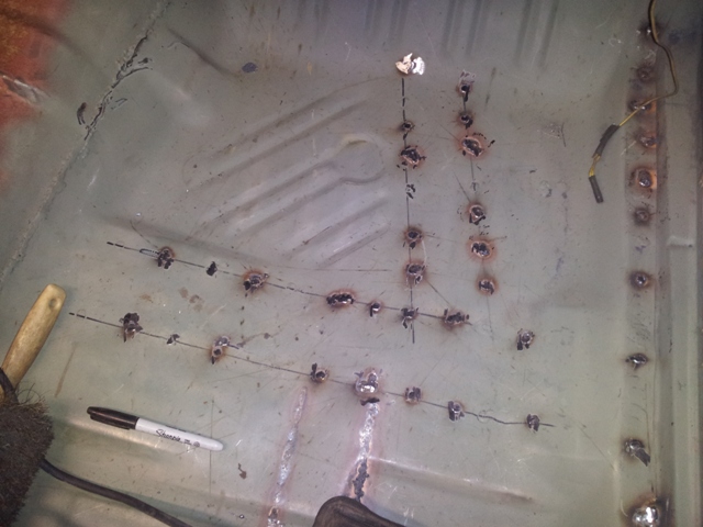

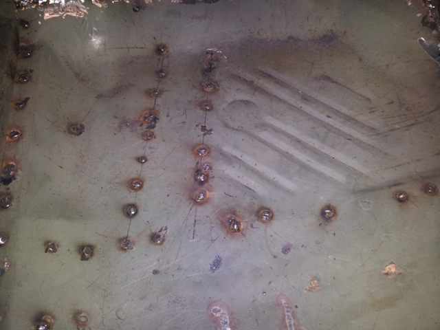

Did a little bit of re-work - had plug welded in the floors, but after seeing the other posts, didn't have nearly enough welds.
So I've gone back and added additional welds to better secure the flooring ( and car )
Driver side:
Passenger side:
And patched up some Swiss cheese flooring under the back seat ( got more to replace here too )
Just trying to keep things moving forward ! ! ! !
That's what I thought ( drain hole ) . . . Thanks KB
Thanks 747Mopar . . . you sure won't be seeing it . . .
Thinking of welding them all shut as you both suggested . . . thanks for the information ! ! !
It's a convert. You may, albeit unlikely, unexpectedly need those holes for drainage some day :)
Haha, good point, in that case don't even put plugs back in the holes.
Good point Tallhair . . . So . . . maybe I need to think about installing a bilge pump ? ? ? ( GRIN )
That works too 747Mopar ! ! ! a straight drian ! ! ! LMAO . . .
Are you guys making fun of me ?
Not at all tallhair . . . When I mess up, I usually do it BIG . . . so a bilge pump might be "just right" ! !
I think the Belvedere will be very spoiled ! ! ( smile ) . . . time will tell . . .
But if I install Dynamat - the drain plugs will be useless anyways - might as well weld them up ? ? ?
And "hope" that I don't do something stupid . . . ( sigh )
damn total fail on my part there bdere
Not at all Tallhair - VERY GOOD point being a convertible ! ! ! Others may need to consider leaving the drain plugs in place if they're reading this.
Thanks for pointing it out - it could very well help someone else out ! ! !

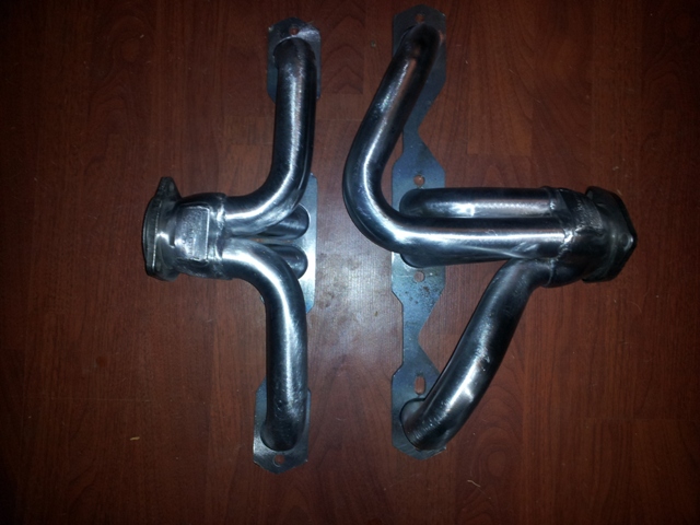

Headers for the shoe box - they got it right this time ! ! !
So Christmas came a little early . . . got my Sanderson Headers direct from the manufacturer . . . so I got the right ones this time !
Interestingly . . . the other (2) headers they sent to me were no where like these, so they stuffed (2) in a box and sent them out ? ?
Well . . . here's the new shineys . .
The left one is the driver side . . . the right one is the passenger side. Guess what I'll be working on tonight ? ! ? ! ?
Oh, and tomorrow . . . and who knows how long . . .

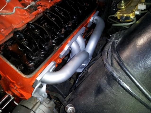

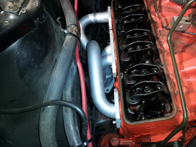

Headers in . . . VHT cearamic painted . . .
Spent most of the day working on the Shoe Box - baked the headers in the oven before painting them ( cool process ). Then cleaning things up.
Boy were these headers made "just" for this car . . . used my shoehorn to get them in ( 1/4" clearance is all I've got )
Here they are . . .
Now to work on hooking up the exhausts . . . oh boy ! ! !
