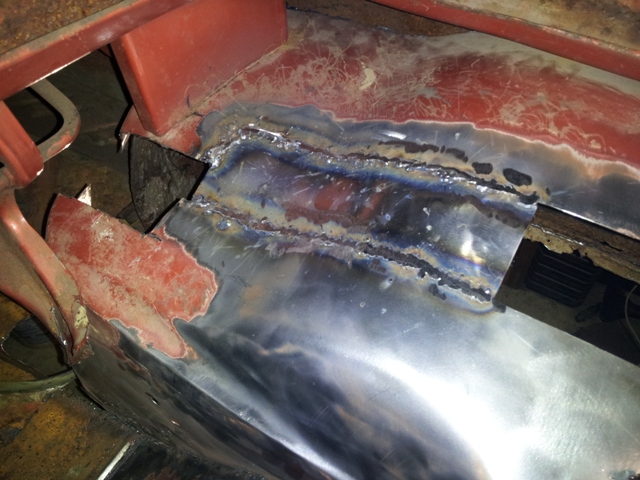

Back to the mini tub on the driver side . . .

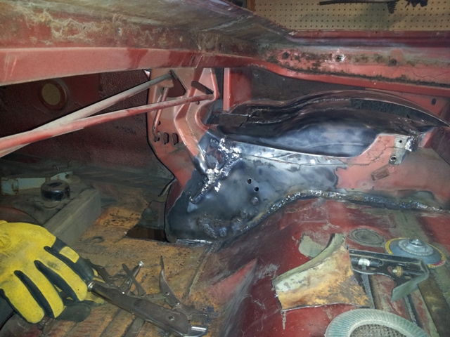

Spent some time in the shop tonight working on the mini tub on the driver side - and made a little progress.
Glad to be back on the mini tub and looking forward to getting this done.

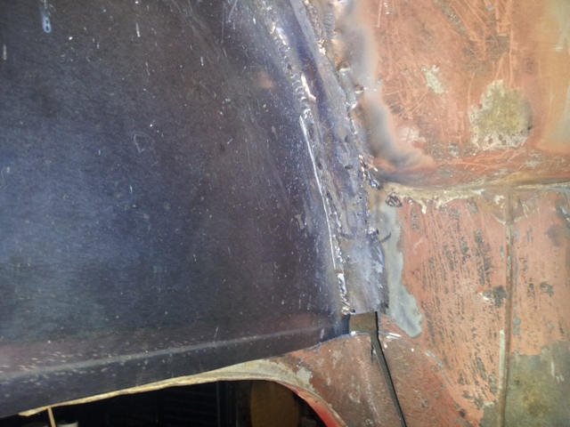

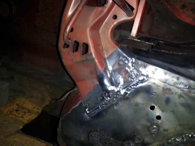

Here's what I managed to get done . . . got the trunk hinge frame re-attached to the wheel well . . . I like the way it turned out !
And a close up of the attachment . . .
Plus a whole lot more welding on the inner fender, and also a bunch of grinding to get things cleaned up a bit and looking better.
I guess the only question I have, and sorry if it's been asked before, is, do you EVER sleep?
LOL CarnalSupply . . . Why is it that it feel like I'm going in slow motion some times ! ! ! ARGH ! ! !
well had some time to go thru the last few updates you have posted, you guys are doing a very nice job, this is going to look real good when done keep updating your post ,thumbs up all the way :headbang:
I can see why you like how it turned out considering how cool and well done it is! I am not one of those great welders and everytime i see your work im more impressed, You sure have come a long way with all your fab and welding work!

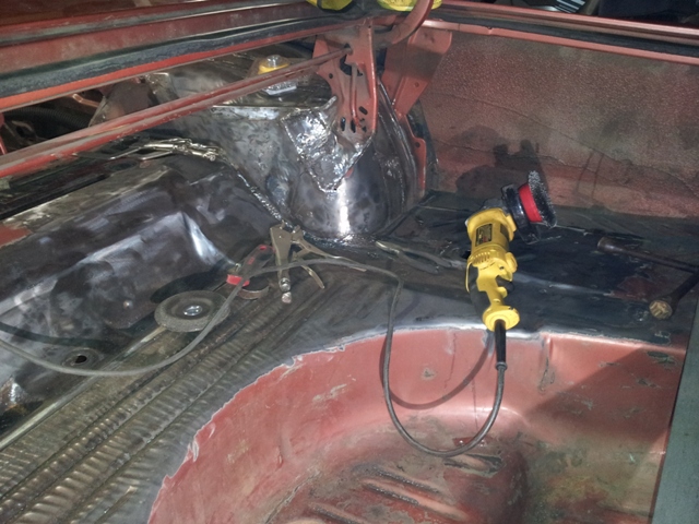

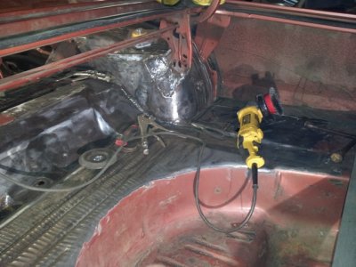

More mini tub welding, and I had to do a little trunk clean up too . . .

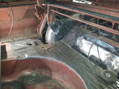

With all the time I've been spending in the trunk of my car lately ( yeah, really ? ) I decided that while I was back there I'd spend a little time digging into the cleanup of the trunk and find out what I've got under the paint and rust . . . surprisingly . . . it's really in pretty good shape . . .
and a view of the other side of the trunk . . .
Got some more things tidied up on the driver side mini tub too - but not too much to warrant another picture . . . but if I can get the rest of the trunk all cleaned out, and down to metal, I might be able to get it shot with epoxy primer . . .

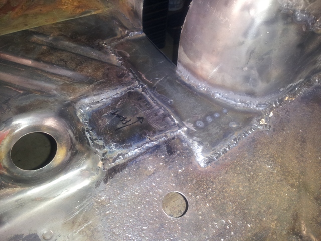

Sunday evening session . . . fab work and welding . . .

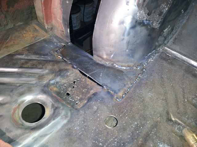

Got back to the shop tonight to try and get this hole filled in - needed to cut a piece of metal, and get it tacked in place . . .
Got it done - got the pin holed piece that'll be cut out and new metal welded in . . .
This plus a bunch of pin holes welded up, a lot of grinding on some big welds ( not as many as there use to be ) . . . and a bunch of trunk cleaning . . .
Making progress . . . a little at a time . . .
I think once you finish up here and get all your welds ground down, the epoxy primer you put on will add more inspiration for you, To get one area all done, all in primer makes all the difference, I didn't have to do much with my 73 when i did the trunk area, two patches i think but once i got done and got some color in there, It perked me up with a new out look.. The biggest difference is you've had to change things, weld grind ect and with you i bet it will be even better! Keep on keepin on bud, its looking great for sure!!!

Had the focus again tonight, and was able to get this knocked out fairly quickly . . . no more rust holes . . .
After I got that done, I was able to get a couple more pin holes fixed, some welding underneath, and some more paint cleaned out of the trunk area . . .

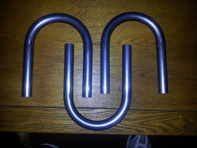

I was able to pick up these parts from Hotchkis . . . wait until you see the plans I have for these . . .
Hope it turns out as good as I plan . . . we'll see . . .

Hmmmmmmmmmmm........Smiley faces? Are you putting indoor plumbing in for those long hauls or maybe some neck restraints?

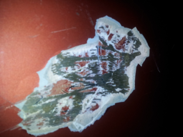

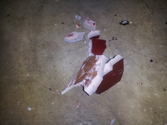

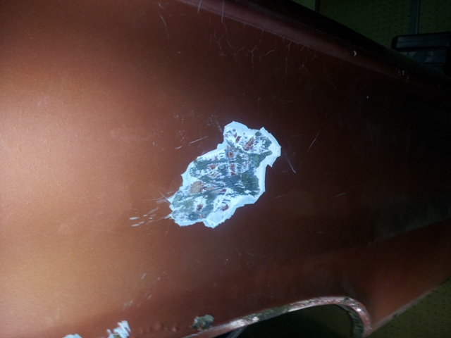

While working on the driver side mini tub, look what I found . . .
While I was getting ready to put the new metal in the driver side to remove the hump, I noticed that the body panel had some dents, and the "mud" on the fender was some pretty thick stuff . . . here's what I found
That picture doesn't really show the thickness of the plastic very well, nor the location, so I tried another shot . . .
That still does not show the thickness very well . . . so how about some of the chunks that I removed from the car . . .
Also found where they had spread "mud" over existing holes in the fender flares, and simply left all the rust ( and the hole ) - this was pretty obviously a "quick" hide the bad stuff, and try and make it look good so we can sell it job
( Or I call it putting lipstick on a pig ) . . . I despise people that stoop to those kind of tactics
Oh well . . . I'll be cleaning it all up and getting it fixed the right way now that I've found the "bad" . . . might also explain the bent driver axle too ? ? ?

Looks like one hell of a pile of bondo! Good thing your getting good with that welder. Anybody got a donor quarter panel for him?

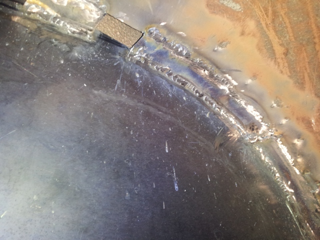

Back in the shop working on the mini tubs - and I messed up by welding the inner fender back in before getting the outer hump part fixed . . . it give me a whole lot less room to get that welding helmet up in there and get the job done.
Here's what I've got going on now . . .
working my way around the semi-circle . . . looks like I'm just about half way done with this now . . .
One this is done I'll get the rest of the 3" strips welded in . . . and we'll be mini-tubbed ! ! !
Rubba Tub Tub.............Looking good Kahn.
