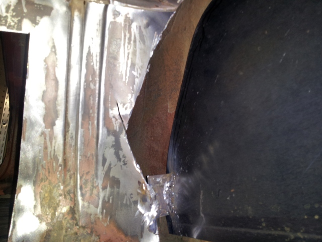

Trying to get this driver side mini tub finished up once and for all . . . first we start with the hole . . .
Then we fit the metal to the hole and tack it in place . . .
Then it gets welded and ground to fit the hole . . .
Hope to have this wrapped up this weekend . . . maybe ? ?

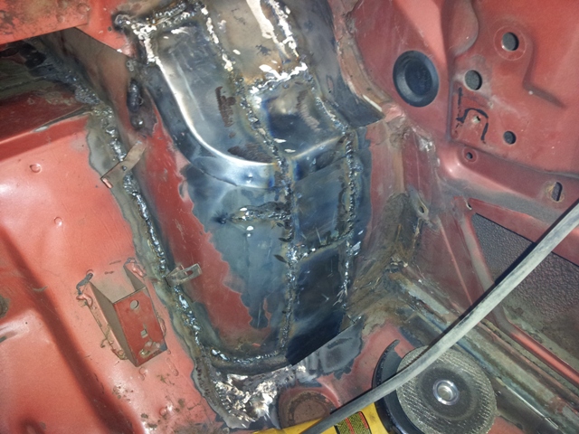

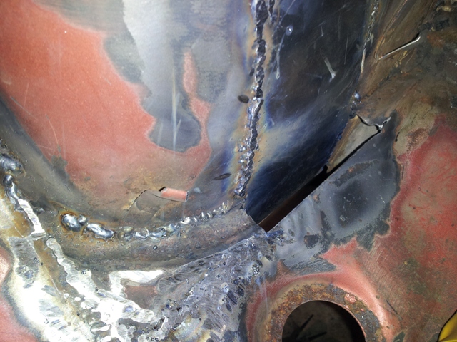

Back part of the tub is completed . . . getting there . . .

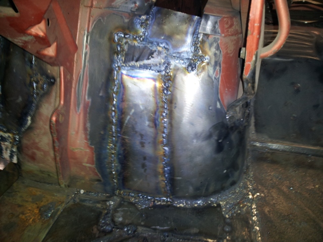

Got the whole back side of the mini tub welded in and partially ground down . . . looking good
This pic didn't work too well - will try and get another one later . . .
And a look from the trunk side . . . getting there . . .
Will be happy to get my head out of that wheel well - feel like a kid playing in his own little "fort" . . . but I'll be happy to be done with it . . .

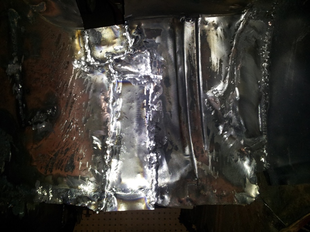

Here's what I got done before I had to get out of the shop - the sweat was dripping on my clean metal . . . that's not good ! !

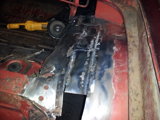

Got the new metal around the corner, matching the same style as the rest of the wheel well . . .
And got it further across the top . . . and closing in the completion of this job . . .

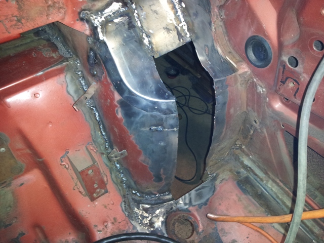

Got to the shop and got another piece put in the mini tub, and was able to get the brace re-attached too . . . ( had to detach it when the inner fender was not moved in far enough and had to readjust it ) . . .

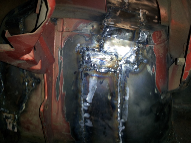

Got a good piece put in tonight . . .
And not very much left to finish up on this "Marathon Tub project" . . .
After I finish this, I'll need to work on adding the drain like I did on the passenger side too . . . that'll be a MUST ! ! !

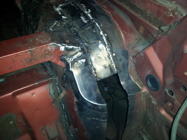

Got out to the shop tonight, bound and determined to get this driver side mini tub wrapped up . . . and I'm so close . . .

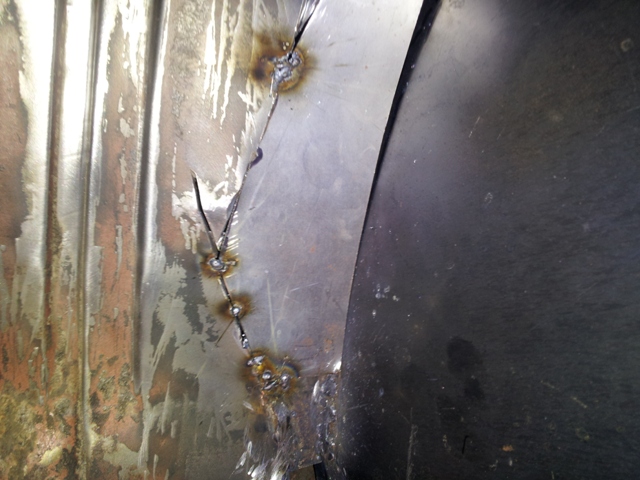

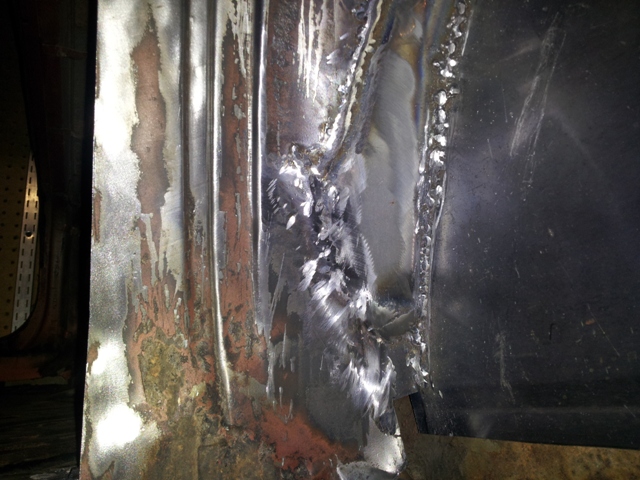

The main holes are all filled in and welded up . . . still got some grinding to do and pin hole plugging up . . .
This is the last hole left - should be a very quick job next time I'm in the shop to finish it up . . .
Then I can move on to the next project ( or part ) to get repaired . . . got a neat little update planned . . . then rocker repairs
