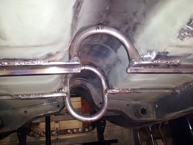

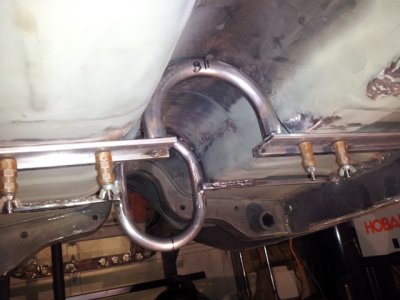

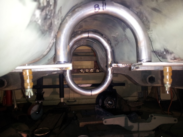

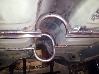

Good progress in the shop tonight on the 2nd half of the drive shaft loop . . . and most of the cutting is completed. Got it all aligned up, temporarily secured in place with a couple clecos, and ready to be tacked into place . . . then dropped down and welded . . .
Here's how it's all coming together . . .

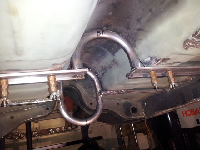

Another view - there will be no bottom on this one, as it's further back and I don't want the loop hanging down that low . . .
This project is quickly coming to a wrap ! ! !

Looks nice Kahn, that driveshaft isn't going anywhere.
Thanks 747 . . . I think that I could pick up the entire car by this loop . . . it turned out very SOLID ! ! !
Sharp work Kahn! Good feeling knowing you and your driveshaft won't be visiting with tea and crumpet's, while flying down the highway. Lost a driveshaft once in a 70's Grand Marquis...beat the living snot out of the bottom of the car in seconds. Scary Stuff.

Drive shaft loop - bucket seat supports . . . complete . . .
Wrapped up the drive shaft loops / bucket seat supports tonight . . .
the floor in my Belvedere just got more solid ! ! What a difference !

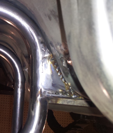

Still wondering about putting a couple gussets in the empty holes between the floor and the tubing . . . like I did on the fronts . . .
WHOA . . . these things are SOLID ! !
Thanks a bunch for the kind words Prop - Very much appreciated. I don't want to find out how much snot it beat out of the floor either ! ! !

Wow, You have reinforced the strength and made safety priority, Pretty cool thinking and looks like a good solid welding job, You sure have progressed in your skills, i hope i get there one day :)

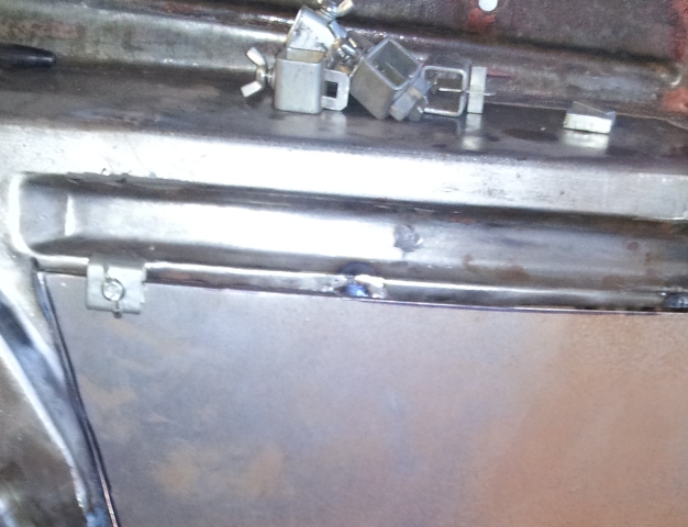

If you are doing new quarter skin panels and not the whole panel i suggest these butt clamps Daytona kid told us about, i bought two sets of them when im ready and from what ive seen and read think there going to do fine..
http://www.cjponyparts.com/intergrip-panel-clips-by-eastwood-set-of-4/p/EW19016/?utm_source=google&utm_medium=merchant&utm_campaign=shopping&gclid=CMLNheaRt8ACFcZQ7AodUFQAWw
Hey Ron . . . Agreed ! ! ! ! Look familiar . . . I picked these up a couple years ago at a local car show - use them often . . . especially with the mini tubs.
A closer look at the picture . . . and them in use . . .
They do come in handy when you spend most of your time working alone ! !
boy those would have been handy!
Yes indeed KB . . . Yes indeed . . .
Thanks Ron . . . I've come a long way in past year . . . yes I have . . . thanks too for the kind works ( smile )
