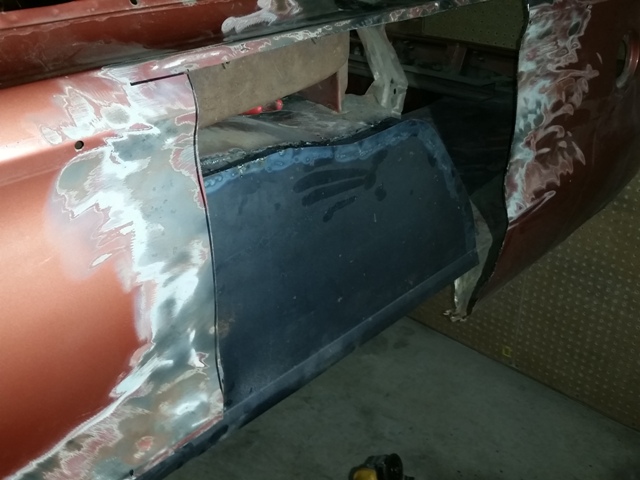

Already been spending some time on the area and trying to see what I can do with it while it is still attached to the car . . . made some good progress on the top area, bringing the low spot upwards, which moved the top seam out . . . getting it much closer so that I hoping it will only needs a skim coat to finish off and not the 1/2" they had on it before . . .
Still trying to figure what I need to do with this mess to get it respectable . . .
A body hammer and dolly with some patience is all i can think of unless you would want to replace it, If its solid at all i would try some old fashion body work with the tools and see if you can get it respectable again.. The patience is the hardest with some of this stuff, if they knew about this, yes sir, that sucks!

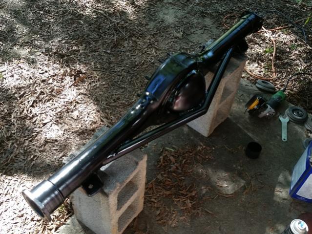

The rear end that 747 helped out with narrowing and reinforcing was beginning to surface rust, so it need to be put in primer . . .
So I spent the time today and got it in VHT Epoxy Paint . . . going to love the way this looks under the car ! ! !
And, of course, a BIG THANKS to 747 for all of his help . . . no I have got to find a posi for this thing
( my open carrier is welded and will not go back in the car )
That looks real good to... you say your going to like the way this looks under the beast, if i can ask, is this the color its supposed to be or are you just liking the shade of the color, i guess it sounds like a stupid question but i have a 3/4 rear end and the leaf springs ive media blasted and used some of "Eastwoods" rust converter and primed them and this looks like they would have looked "the" day she came down the line so i guess im wondering what is the correct color! LOL, Have to ask being im looking at one that does look right!!! I like the look to bro! AND a thanks from me to Devin for the help!!! :)

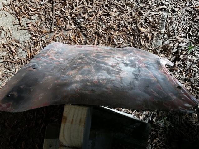

Looking at the rippled quarter panel, and wondering what I could do with it, got me thinking . . . what if . . .
the bad section is about 2 feet wide and two feet tall . . . how about cutting it out, try to straighten it out, then weld it back in ? ?
So I marked off the bad section . . . and cut it out . . .

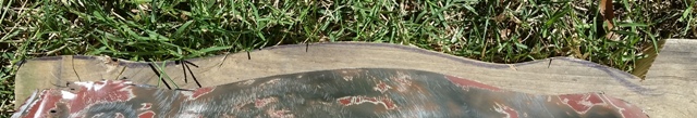

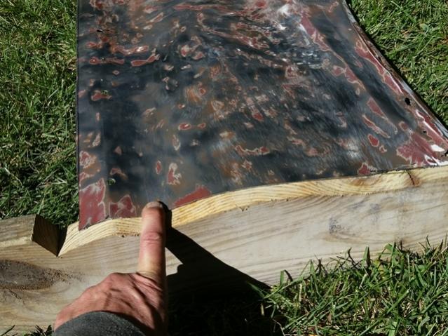

The edges had a good profile to them, so I marked the edge on the piece of 2 X 6 . . . to help with shaping . . .
then I used the length of the 2 X 6 to work the directions from edge to edge a little smoother . . .

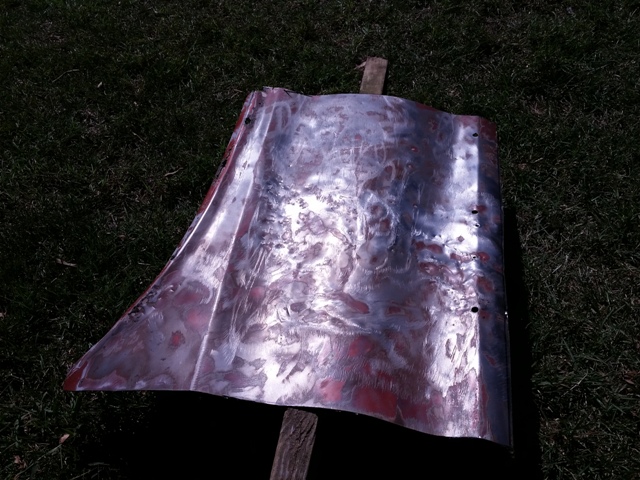

and I used the cut out contour of section of the 2 X 6 to work out the top to bottom shaping of the panel . . .
until I got a piece that looks more like the car panel and less like the Atlantic Ocean . . . still got a little more shaping to do, but it is coming along nicely . . .
That sure is looking better!!!!
Good idea! That sure is looking better than how it had been. Nothing to lose by trying it and should be a ton better
