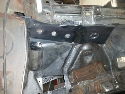

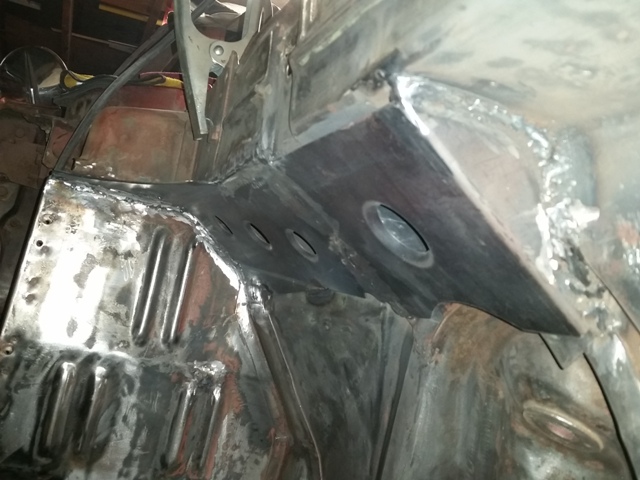

Installation of my inner fender braces . . .
Got the passenger side inner fender brace installed yesterday . . . and it went in so nicely . . . I figured that I would get the driver side one installed today . . .
WRONG . . . it has been fighting me the whole way . . .

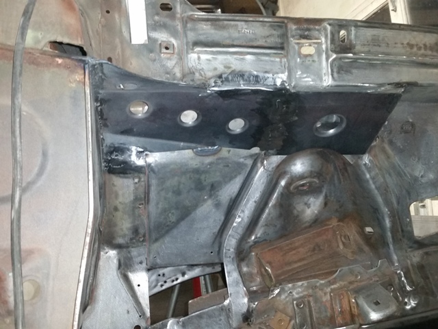

Here is the passenger side installed . . .
And another view from the front of the car . . .
As for the driver side . . . it is still fighting with me and and I am still working on it ! ! ! It won't beat me . . . ( grrrrrrrr )

Khan, ill wager some store bought whiskey that brace wont beat ya! lol, You should know doing the first, the second one will be like your worst date, it seems to always work that way, the wife asked me once why i was stopping for the day after changing a shock mount on one side because how well it went, i told her the other would be the problem... guess what, :)
Hi Kahn, say where did you get that brace?
I have to say I have not seen any that look like those.

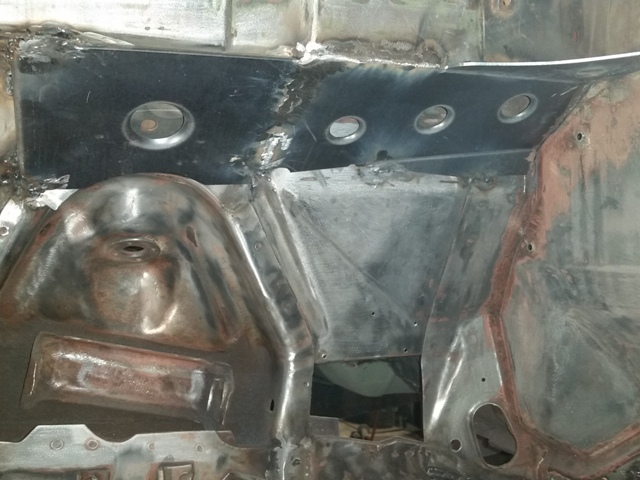

Driver side inner fender support installed . . .
It was a battle, but I think I won the war . . . and I got it installed . . .
Still got to get back at it and finish up securing it all in place . . . but I think it's going to work . . .
Oh, and then the grinding of the welds to make it look nicer . . .
Looks good Khan! Seems these cars can be a real battle all the time, even when waiting to get parts, Christmas coming is slowing me down with a couple things but i imagine im not alone.. Keep it up and you'll be havin some fun going down the road! ;)

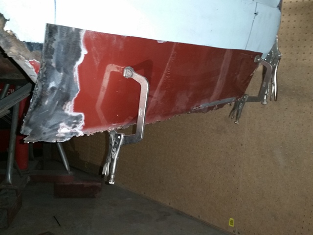

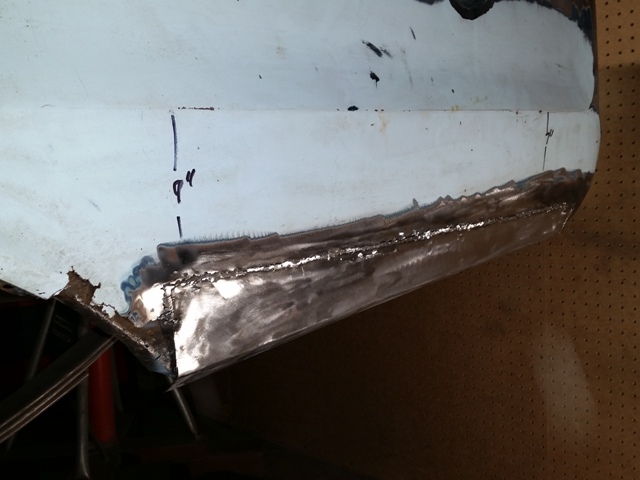

Quarter panel direction . . . I think I have a plan . . .

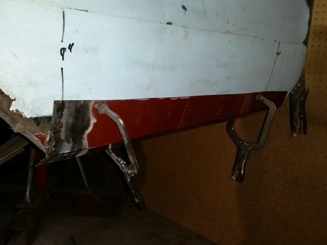

Been trying to figure out how to fix the bottom rear of the donor quarter panel that is going back in my car - and I think I have an idea - the old panel, that was removed, had a pretty good section in the rear, just not the piece at the bottom that was all rusted out . . .
So once again I found myself removing undercoating from the old panel, so I could cut the good section out of the panel and use it for replacing the bad part . . . does that make sense ? ?
Here's what I've ended up with . . .
The plan is to take this to my neighbors break and put a bend in the bottom like the original panel, then fit it, cut them both, and weld the old part into the donor panel . . .
( this kinda sounds like Frankenstien - but Speedy already has that name claimed . . . ( smile )) . . .
Then it's on to fixing the wheel well lip and putting the panel back on the car . . .

Looks like you have a good idea buddy, beats all the small stuff that i know you have had yourself cutting and patching, Im certainly glad my day ending lol.... It's been one of those days when anything that might go wrong...... Have a ggond one :)

Cut, and bent . . . and clamped in place . . .
I think it's going to work - the metal has the same contour as the rest of the panel and it fits in nicely . . .
Now for the fine tuning . . . ( sorry - needed more light on the subject )
Looking more and more like a car . . .
Got the pieces all cut, tacked into place . . .then the process of 1000 welds . . . and it's starting to look like an original quarter panel again ! ! !
Got more grinding to do but I think it looks like it will work . . .

That did come together nicely! Well done as always brother!
I sure do feel for you guys that don't have the option of buying good panels....................... Looks like you got it covered!
I do myself Dev, with all these cars you would think they would come out with other models you can get parts for, With your welding though it seems by the looks of it you have it covered Khan.. I didn't think this would slow you down any.. I see how much guys put into there work here over the years and wonder if the guys building there Cameros have the same determination... You finish this your going to be smiling plenty for sure.. not to give you a big head i hope you know.. Heck, you are working for it and deserve big time credit, most would have said "enough"....
