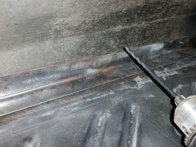

Got a piece of metal and bent it like a piece of angle iron - that will attach to the floor and up the quarter - it will add strength to the quarter panel too.
If I can get this in place, get the back side of the panel in primer . . . then I can get this thing installed once and for all . . . slowly, it's coming . . .

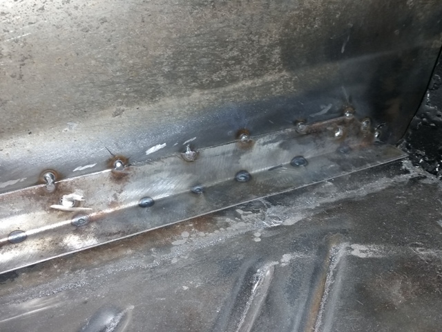

Angle bracket welded to panel . . . now I need to get it in primer and it's cold here
Got the angle bracket tack welded to the quarter panel and I'm very pleased with the result ( and the welds )

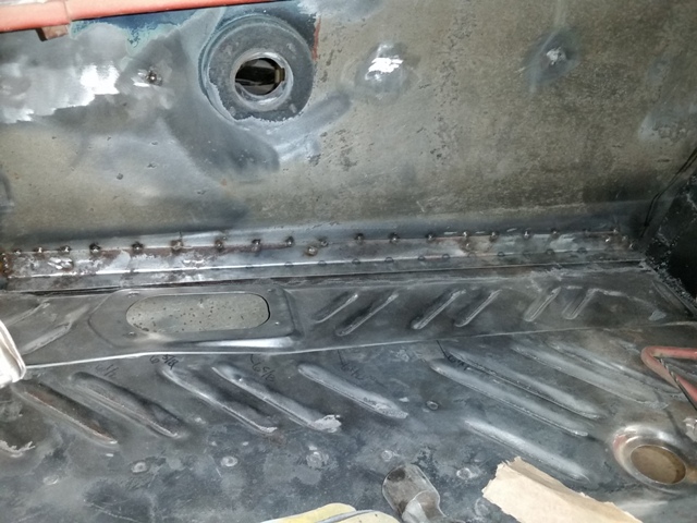

An over all view of the trunk connection . . .
A closer look at the bracket attachment . . .

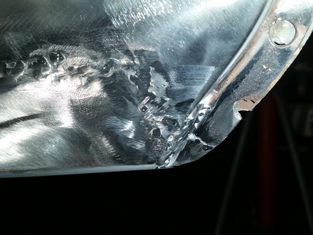

And the rear bottom corner of the pane that i needed to rebuild - it was rusted out . . .

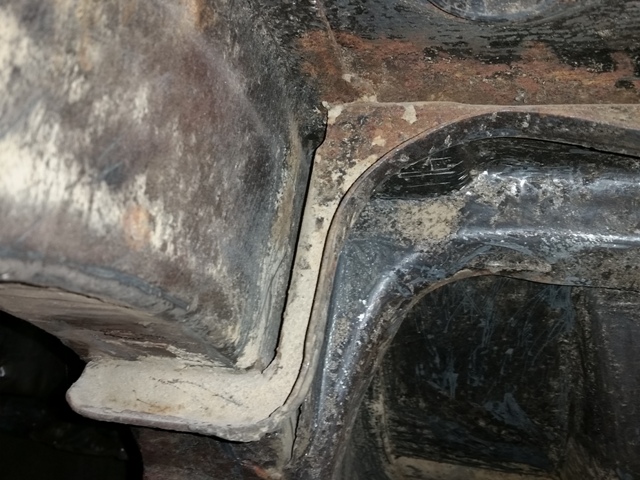

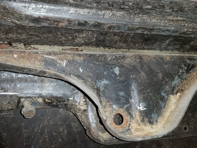

My next question . . . concern . . . the rear shock cross member . . .
Was out in the shop working on miscellaneous things and one thing that I've read, and always had in the back of my mind, is the strength ( or actually lack of strength ) of the rear cross member that holds the shocks . . .
Got some pics today while I was working on the car and want some advice . . .
see the gaps above . . . ( looks like I got missed some undercoating - sigh )
and the gaps beside the cross member
Filling in the gaps would greatly strengthen the cross member, and the car . . . seems like a pretty simple mod - and easy now that the car is stripped down ?
Thoughts ? Suggestions ?
I don't think it should make a huge difference to be honest. The shocks don't support vehicle weight and only dampen the suspension which does impart load but some flex there won't be felt in the handling of the car (or at least I am not thinking so). If I was to do anything back there I'd drill the spot welds and have somebody bend me a piece of DOM tubing to weld between the frame rails. I'd gusset that to the trunk floor in a few spots and then add my shock tabs back.

I think your right Tallhair, one in the front and one in the rear at angles would dampen any axle windup (wheel hop) although I've never experienced any wheel hop in mine at all but I don't have huge tires like your planning on either. I still say if your going to fart around you might as well put a triangulated 4 link in it................. Lots of advantages to a coil over like easily adjusted ride height, easy tuning, virtually no windup at all etc but it's more work and more money.
Thanks 747 Mopar . . . I'm riding the fence on this, my Uncle said he drove a car with a 4-link and he didn't much care for the ride . . . likes the ride of springs much better . . .
So I'm still not quite sure what to do here . . . but the current state of my car, NOW would be the time to get it done . . . still thinking on this . . .
Which 4-link would be the way to go ? ? ?
About the extra welding,, I put more/extra welds on my car everywhere I thought it needed., filled gaps, went over factory welds, added pieces of metal in gaps, etc... It can't hurt and doesn't add hardly any weight. I put twice as many spot welds as the factory on my floors, panels, etc.. The only thing negative I've ever heard about extra welds is that it will be harder to take it back apart.... I don't plan on taking mine back apart!, duh.. Weld on bro!
