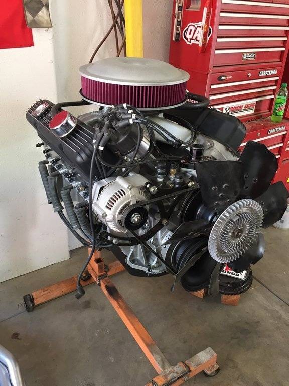

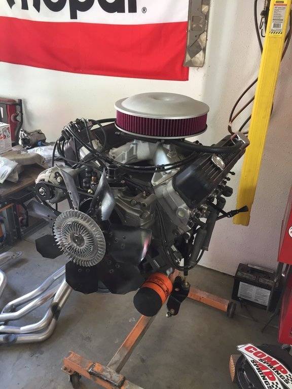

My 470
The 383 that spun #1 and 2 rod bearings had 100 cold on the drill and after I broke it in, 95 at hot idle.
This should be just fine.
Once I get it on the engine lift, flywheel, clutch/pressure plate and bushing will be installed and then drop it home.

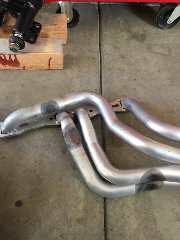

Here's the drivers side header and all the dents it took to fit it with s QA1 k-frame and Borgenson power steering box.
According to TTI krylon makes paint that'll match the coating. I'll be damned if I can find any though. Looks like your getting there!

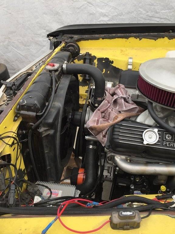

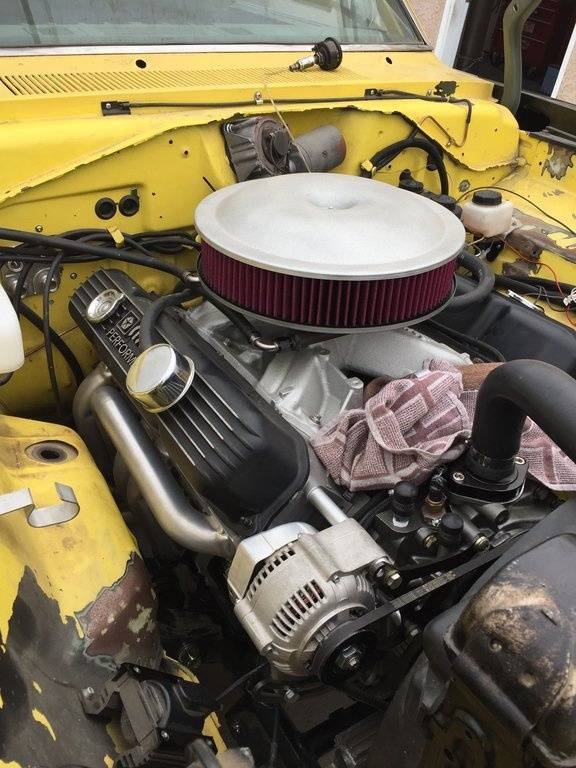

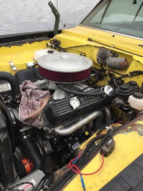

Just finished installing drivers side header, still had to shim the mount. I was trying to get away from the shims, oh well, it's done. Now to finish hooking up the electrical and other loose ends. Might be able to break in the cam on Friday.

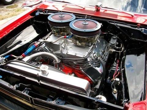

Looks awesome 5.7! What color is that in the block?
It's cast iron gray and the timing cover, intake and air cleaner are textured argent silver.

Engine is broken in! A tiny leak down at the pan/timing cover. Temp never got over 213 with a 22x19 brass copper 4 row radiator with direct fan and shroud. After it was broken in, temp settled at 200 at 2k rpm's with a 180 t-stat. Still have some timing issues, and need to replace a spark plug boot. I have a small video but don't know how to post that, so if some can post it, I'll send it to ya.
