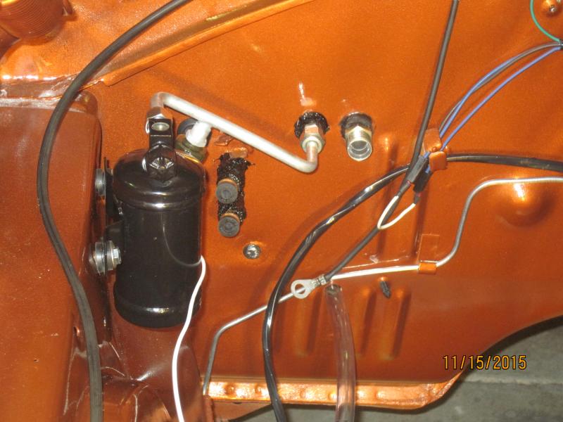

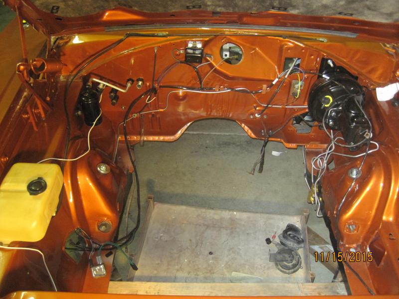

Installed all new brake hard lines from The Right Stuff. They fit nice, just needed a little bending coming out of the m/c to clear the shock tower. The windshield washer system is in place. Ordered new M&H wiring harnesses from YO. These are beautiful sets; factory color coded, all the right connections. I highly recommend the investment. Hard to see next to the harness but the fuel line is in, as well as the gas tank. The car still had the original tank pad. The original composition pads are unobtanium because of the asbestos content; I kept it instead of going to a new rubber based repo. Got a new filler neck grommet from Rick Ehrenburg's Ebay site. Installed a new sending unit. Ohm'd it out and it's within spec; the old one was so corroded it didn't even give a reading.
Started mocking up the Classic Air system. Can't do too much until the engine is installed but got the drier bolted in. So far between the under dash assembly and just mocking up the engine compartment, I've very impressed with the quality and attention to detail.

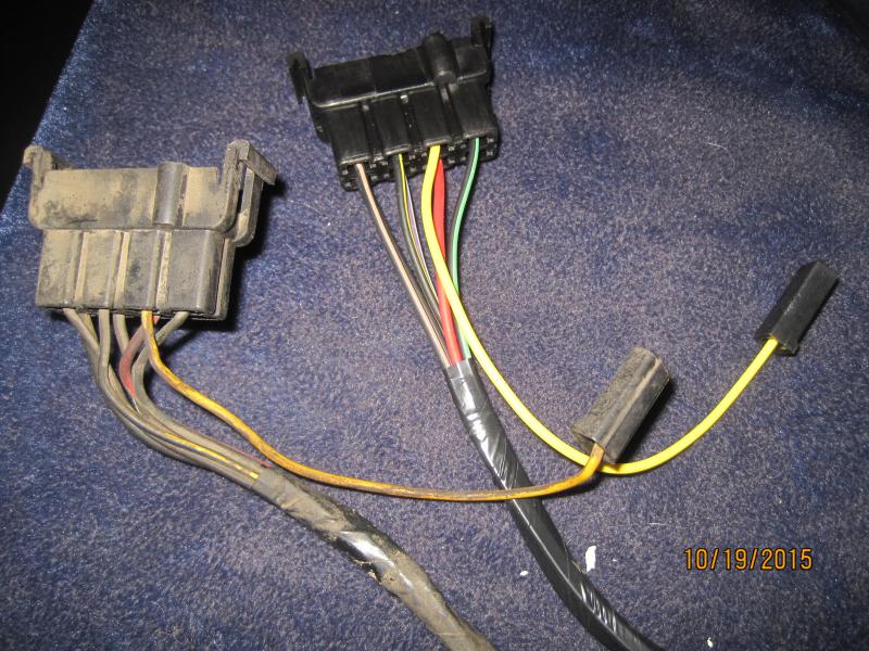

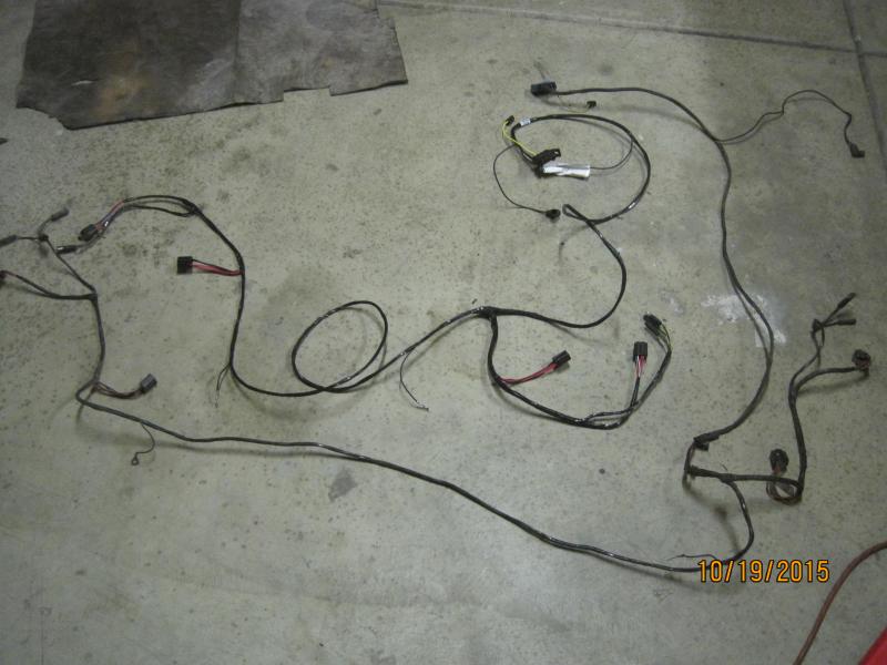

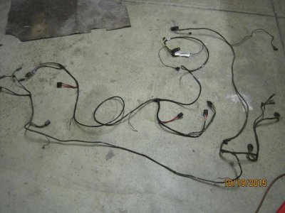

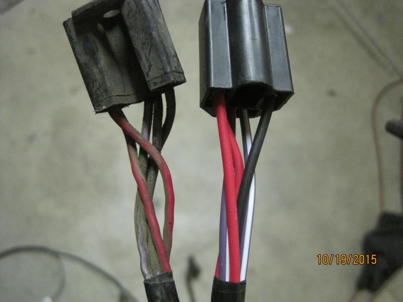

Wanted to give a little more detail on the YO wiring harnesses. The new harness is encircled by the old one.
What a difference!
Some of the original wires were so faded and dirty you couldn't tell what color they were. So that's what violet w/ tracer looks like…lol. Notice how the electrical tape starts at the same spot as the original - again the attention to detail on these harnesses is amazing.

Fortunately none of the harnesses had been hacked over the years so I only replaced the engine compartment harnesses for safety sake. Too many stories of engine fires resulting from old wiring. You can buy individual harnesses from YO. They're the exclusive distributor for M&H. I am using the old fuse block but I will be adding another one for the additional accessories: A/C, elec fuel pump, FI ECU.
Attention to "detail" . . . he states . . . WHERE is all the dirt, and crud to make it really look like the original wire harness ? ? ?
LMAO . . .
WOW - that looks great CoronetDarter - nicely done ! ! ( even if you missed a little detail ) . . .
and I would trust your harness much more then the original one !

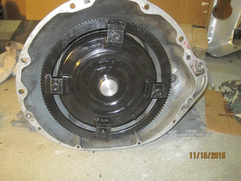

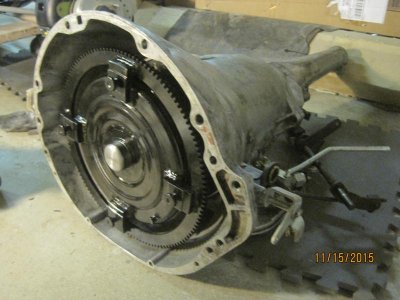

Took the tranny down to the local self serve car wash and degreased and power washed it. That's a Frank Lupo (Dynamic Converters) 10", 3,000 stall converter. After we talked about my build and he recommended the 3000 stall I was concerned running that high a stall on a street driver. But he assured me the converter would act like a lower stall unit during normal driving but would flash to 3K when I jumped on it.

I had a 3,500 stall in my last car and it was perfectly fine on the street with 3:89 gears so I wouldn't worry. Smart move on freshening up the wiring, you may dodge a few electrical gremlins by getting nice new clean terminals. Looking great!
Thanks for the info on your converter. And I'll be running a trans cooler and monitoring it with a temp gauge.

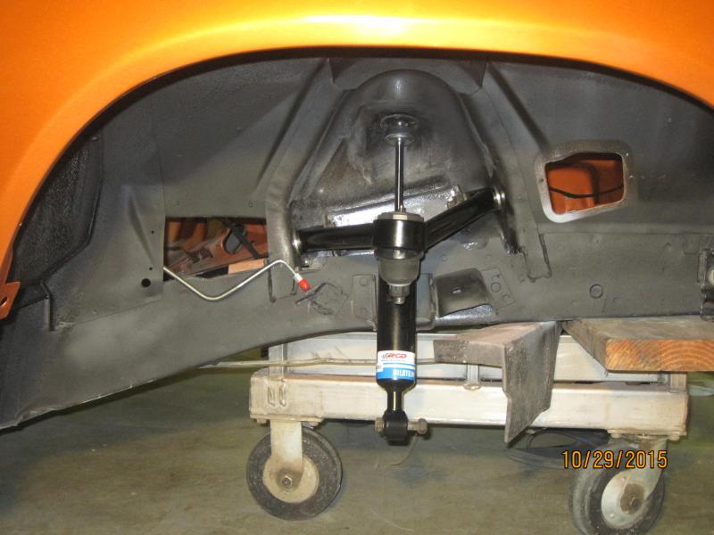

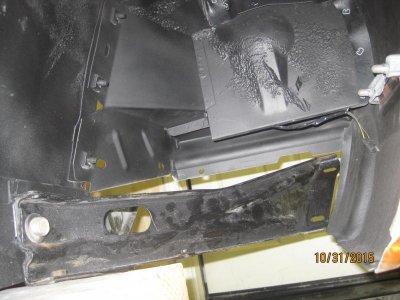

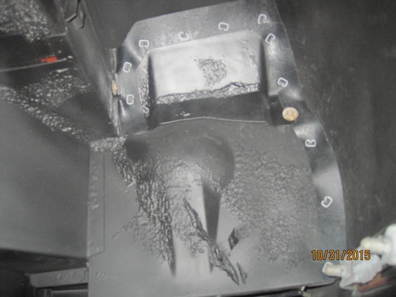

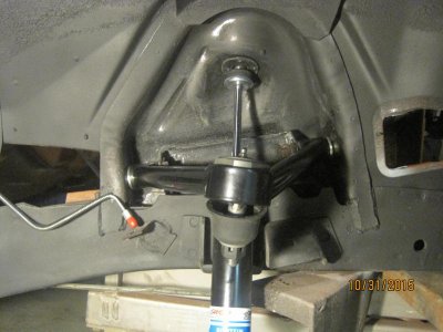

While waiting for the engine I tackle projects here and there. It feels like I'm running out of things to do, which can't be right because the car's not even half done. The original upper A arms are out, replaced by tubular A arms from PST. Installed Bilstein shocks on all 4 corners.
Installed the front bumper brackets and headlight splash shields. The bumper brackets had been painted with POR-15 months ago; they need to be dusted off. And note to self: next time hook up the fender turn signal leads before installing splash shields.
Only took pics of the passenger side. To get an idea of what the driver's side looks like, hold a mirror up to the pic.
