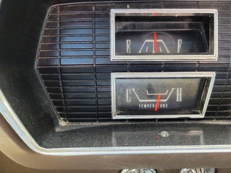

Here's a factory gauge at 222° after a 30 mile drive in 120° weather and then idling for 10 minutes w the a/c on
During the drive it never got over 182°

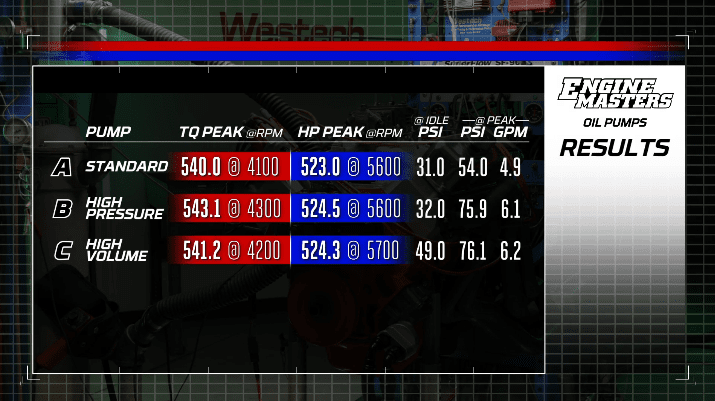

There was a interesting engine masters they found no hp loss in going to larger pump.
Thanx - Found this
Engine Masters - Oil Pump Pump Off
440
They used stock Melling oil pumps, Stock, High Pressure, High Volume, and a race Billet (Milden) one. The only pump that lost HP was the race Billet pump. The stock Melling High Volume pump increase volume (4.9 vs 6.2 gpm), increase pressure at idle 18 psi over stock pump (31 vs 49) and 22 psi at peak flow (54 vs 76) over the stock pump and didn't use anymore horse power.

Thanx - Found this
440
