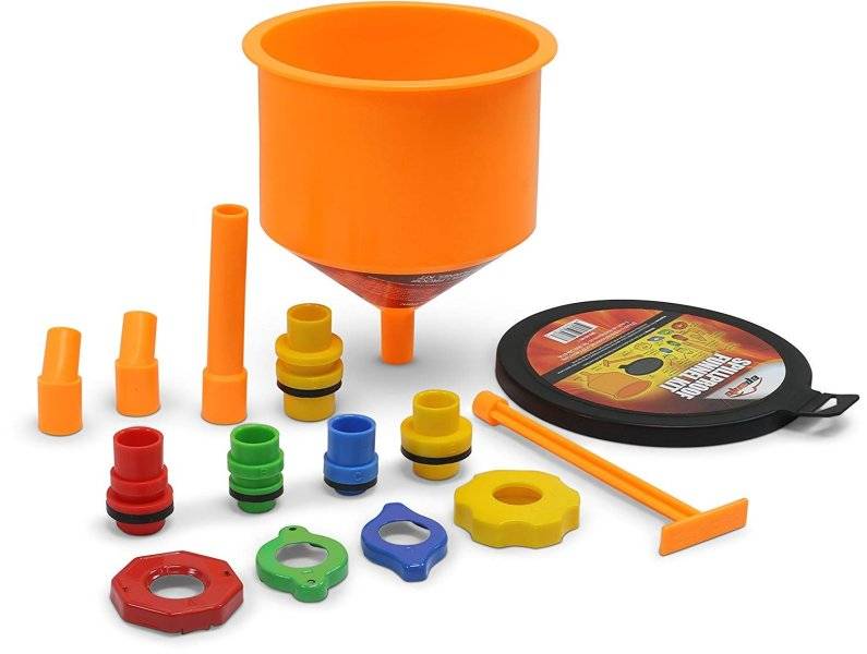

I'll try to burp the system first. You just let it run with the cap off, correct?
I use one of those special funnels and lift the front end a bit and let it run until all the air bubbles are gone. Using a standard thermostat, I also drill a 1/8" hole in it and that will allow any leftover air to escape.
