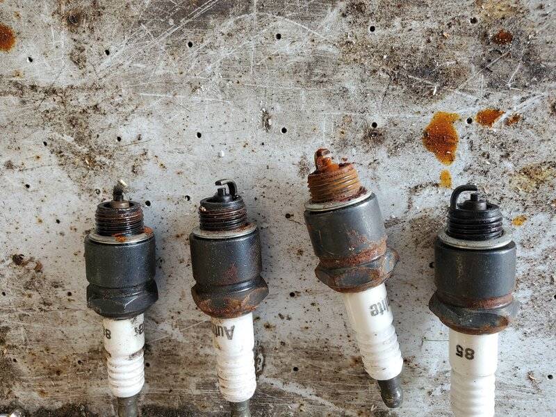

The car I bought in project state had made little progress over the last 5 years. I decided this year to get it running and stopping so that I can at least drive the thing. Bugger the full resto as I have realized that I don't have time for it currently. Once I had the wiring for the engine figured out, I went to turn it over. Clunk. WTF? Clunk. The starter engaged but the engine doesn't turn over. As I lack a 1 1/4" socket, I tried a pipe wrench on the crank pulley. No way is that moving. So I pulled the plugs and found this:
Seems that #5 cylinder had water in it at some time. Intake valve was closed. No sure about the exhaust. So, what is the best fix to free this stuck piston. I have turned the engine over in the past, so this has occurred in the past 4 years. I guess I should have turned it over by hand every so often.

also,that looks more like condensation wet rather than full of water wet.

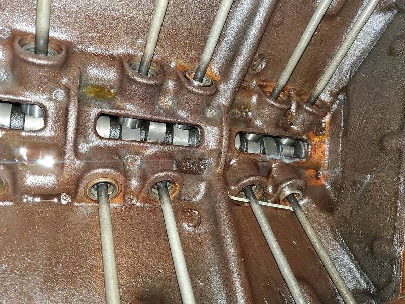

So I took off the valley pan and noted a bit of sludge and lots of orange overspray. There is some oily sludge pools in the depressions as well. Plus, lucky me, I found a zap strap that someone left behind! There does appear to be a white grease smeared in areas. I think the cam looks newish, but I don't know. the guy I bought it from claimed a rebuild, but had suffered a stroke and his memory was no longer sharp. I'll monkey around with it this weekend and keep you all posted.
Orange overspray? That's rust and that lifter valley has had water sitting in it. Lifters are rusted and corroded. Yes cam looks new, which is a shame..
Again. More to the story.
Other than a bit of sludge, both the water and the oil are gone from all the little depressions that normally hold oil for a decade.

i would agree,esp after seeing that picture.
it does look like it was rebuilt and then never fired.
at this point,you might as well pull the motor out and go thru it top to bottom.
no sense taking chances,and with any luck ! youll just have to do some cleanup and a new cam n lifters.
