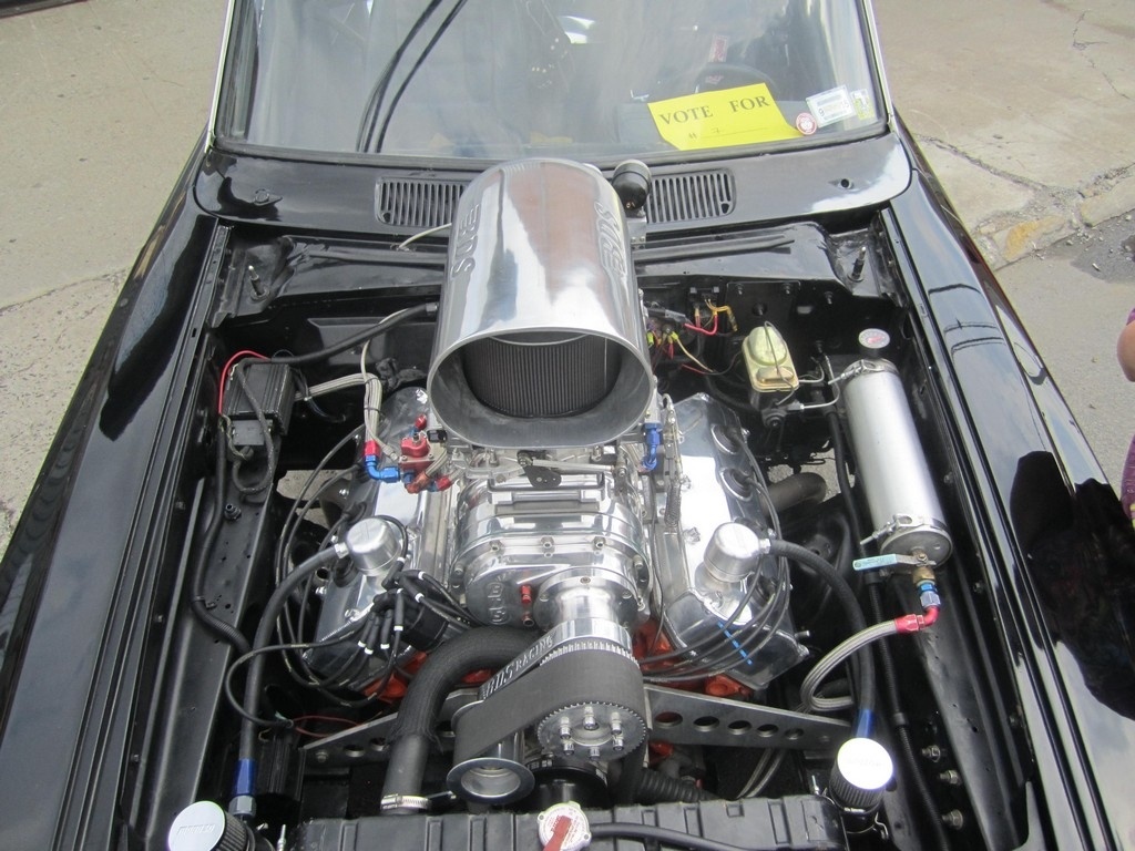

get an accumulator. It compensates for that problem.
