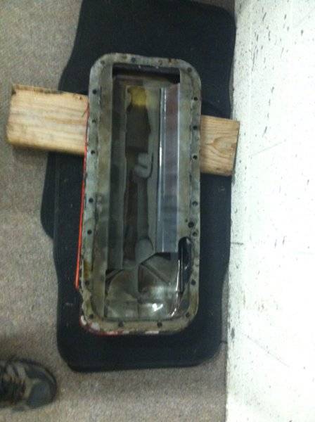

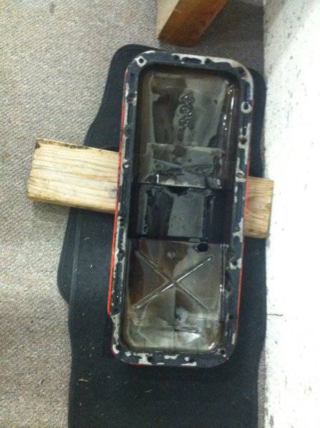

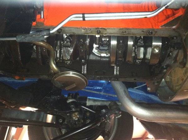

This motor is bone stock, Except for the HV oil pump. I am not racing it. I have another RR & a sport fury with 383s and HV oil pumps that are fine. I was almost sure I would find the baffles missing in the pan but thats not the case.
Weak spring on the pump relief or the shuttle hanging?
...........I have another RR & a sport fury with 383s and HV oil pumps that are fine..........
Same pump mfg.? Swap in a known good one?
I wondered about the relief spring. I do have a new melling pump I think I'll try. Then I'll cross my fingers the weather holds out to try it.
