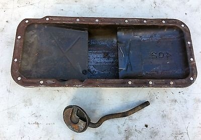

It's small, but it's there.

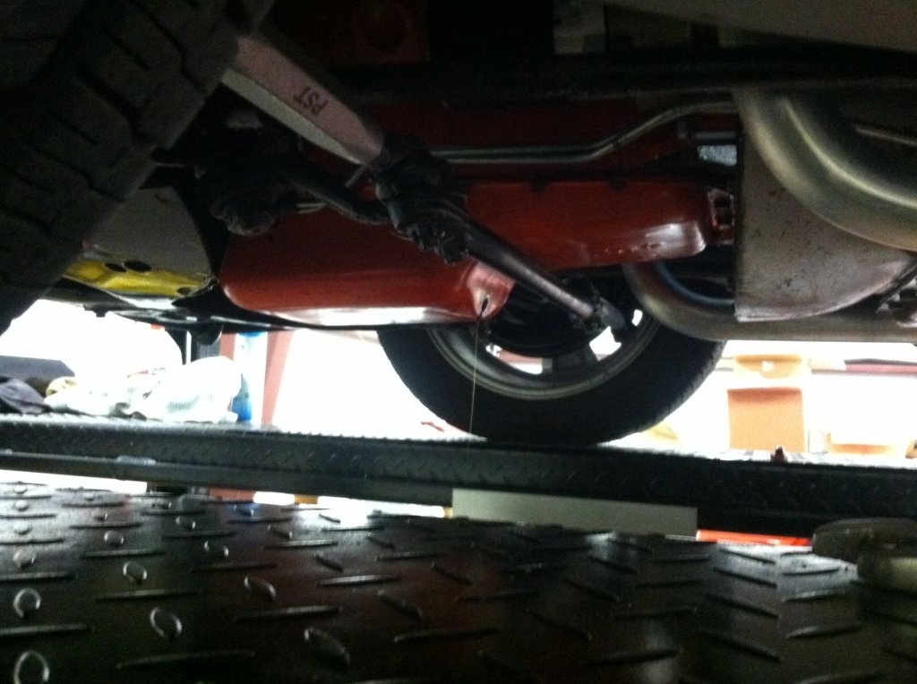

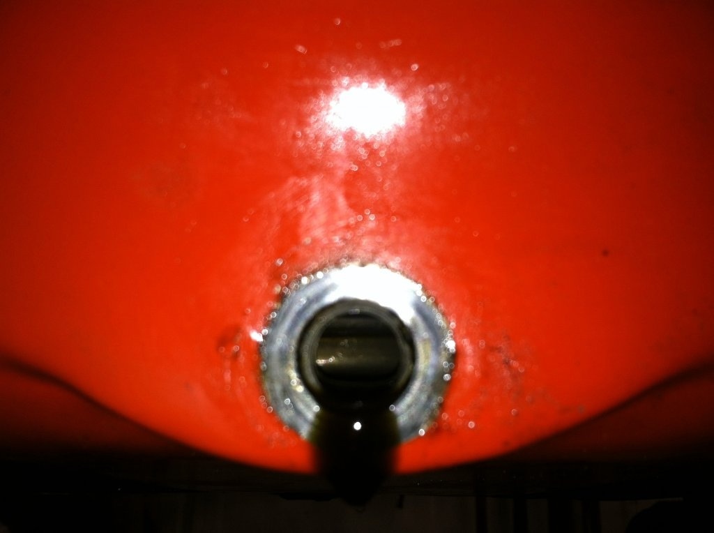

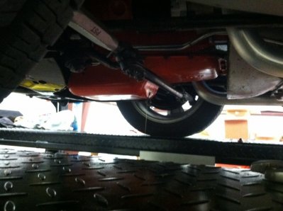

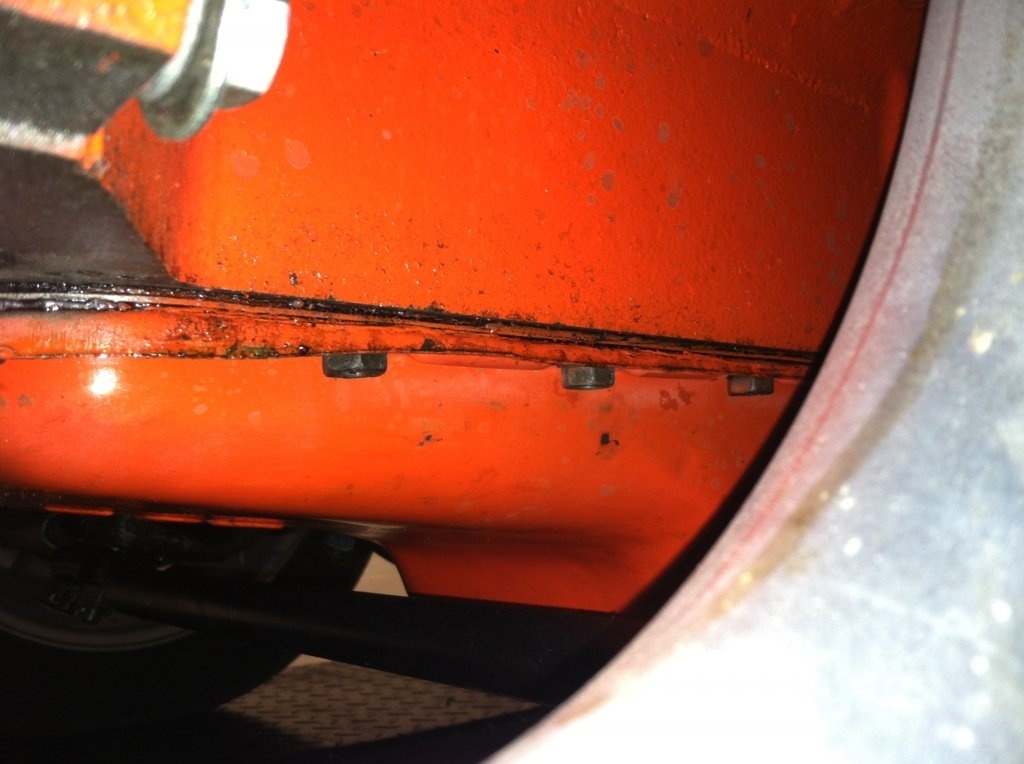

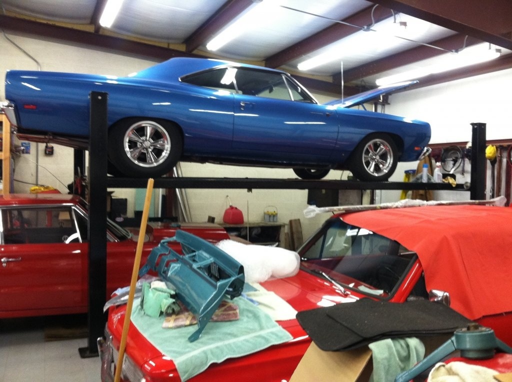

After getting it up where I can see it,I can tell the windage tray is there. When I drained the oil I could see the pick up tube was there and at the very back of the pan. Good place for hard acceleration, but not so good for hard stops. Also with the added rake from larger tires on the rear, the pan sits at an angle to put the pick up in less oil. Thanks to the picture from gdrill, I'm going to bet it has the baffel in place too. So i think with the 20/50 oil, and HV pump there is a couple of quarts hanging around the top of the motor when she's running. Leaving me with 2 quarts in the pan. So I think I'll try some 10/40 and throw another quart in like the first poster said and see what happens. If it still loses oil then I'll put a 7 quart pan on. If I can find on that won't hit every driveway approach I come to.
Well, wherever it sits it is close enough to the drain hole to see it is at the bottom of the pan and level. Like IQ52 said.
If my dim memory is correct, I agree with Miller, with my 402 pans & stock style pickups, it was in the middle of the sump. Pickup does need to be close to the bottom of pan, again if it's a stock pickup. Does your motor build (bearing clearances etc) need 20-50? If not, a lighter weight oil is better.

Well I finally took the pan off yesterday, I'll post some pictures later. It has the same pan & pick up as in grill's photo. The baffles are in place. I didn't drive it much this summer so that's why it's been awhile. I noticed it has 60-70 PSI when cold and drops to 50 after it warms up at hi way speed. At idle it goes down to 20, this is with 10w40. I know all the bearings are new. So I'm thinking the 7 quart pan would help, but also wondering if the oil pump might be weak? It is new, but I had a friend get a bad one that quit pumping all together. I don't know what brand they put on, but I have a new telling on the shelf I could try.
