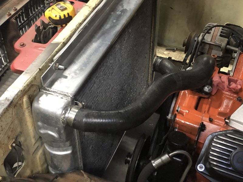

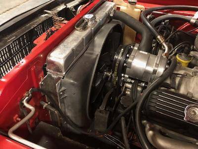

I put it together with a lot of parts that I had stashed away. I used a lot of used parts but bought new where it was needed. The 383 has been rebuilt, runs 9.3 compression with a 280-474 cam, Edelbrock RPM intake, Holley 750 Vacuum secondaries, 1 7/8" headers, 2 1/2" exhaust, the radiator is a Griffin aluminum 2 row that I used to have in THIS car:

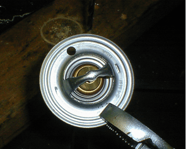

Anything else to look for? I'll replace the thermostat regardless. Some suggest to drill a hole in the thermostat to improve flow. What size hole?

I haven't seen a cross-flow like that before.
The water gets cooled by trickling down through the fine tubes.....that cross-flow will just allow the hot water to sit towards the top of the tanks on the side.
Is Ginger the same radiator - or is it a standard vertical fin flow?
Generic Motors used cross flow radiators for many years. I bought that Griffin in 2000 when I did my first 440 swap in Ginger. It was a cheaper option compared to recoring my original 26" unit, though nowadays I wish that I had kept that one!
The Griffin never failed me when I had it in the red car, never. Ginger has over 100 more cubes too.
Ginger has a standard style top and bottom tank, vertical flow unit from a trusted vendor, Speedcooling, ECP. I've driven in 110 degree heat and it never overheats. I do have a shroud on it though.

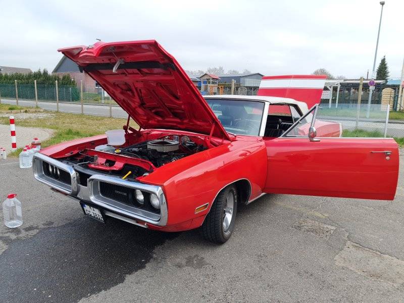

My red car that I'd hoped to drive back from Texas overheated repeatedly... I tried radiators, water pumps, thermostats, knocking the freeze plugs out & flushing the block, a couple fan clutches & a solid fan... Then a two speed dual electric fan system.... It overheated through all those attempts.... Then I bumped the timing up... A lot.... And it finally got better... In the end I locked out all advance & set the timing at 34 degrees... I used a dead stop & verified TDC, the cam isn't big enough that it should even want full advance... It's a true measured 10.2 C/R it should ping, it doesn't... I don't understand it, I still question it but a friend who is really good at making big HP commented that some engines just aren't logical... But they will tell ya what they want..

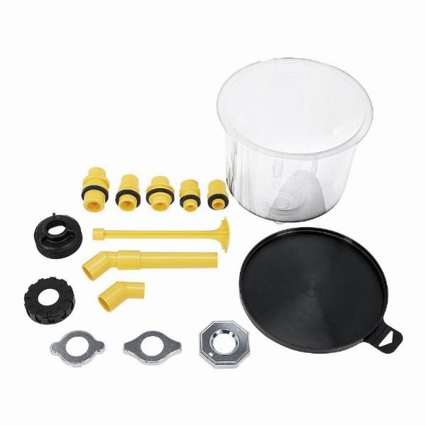

One more piece of advice, to burp the engine, raise the car a bit at the front end. The higher level will allow air to rise to the top and burp out. Or go to your local parts store and buy one of these funnels. They are brilliant and how I did mine. Good luck.
No-Spill Radiator Funnel Kit

I did still wonder about the hole in the thermostat. I've seen some with a small spring loaded sliding valve/pin.

The 'hole' in the stat must be the most misunderstood item related to engine cooling. Production engines have a bypass in the cooling system. On the BB, it is the 5/8" hole in the water pump body, directly under the stat.
It has two functions:
- should the stat jam in the closed position, it bypasses the pressure so that the pressure build up does not blow out a welsh plug or hose
- allows for quicker engine warm up because some heated coolant gets fed into the inlet side of the pump.
Stewart Components started making Chebby race pumps in the 90s & had the bypass eliminated. The drilled stats were for use with THIS pump.
Many stats have a jiggle valve that will 'burp' the coolant. Some do not but there is always some leakage around it for air to escape & drilling a hole will do nothing for cooling, but will delay engine warm up, which increases engine wear & fuel use.
