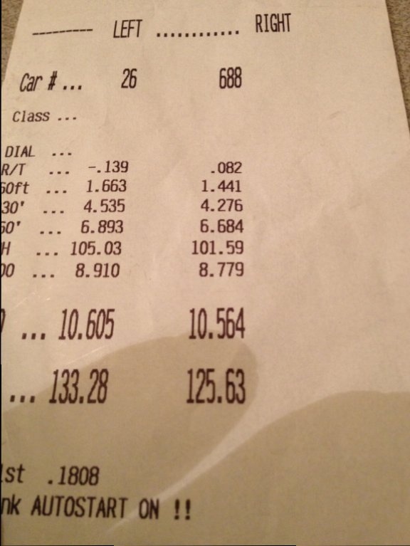

Went racing Wed. night and made a few ch
anges to the car. added more air to my tires, lowered my launch rpm Set a new personal best.
New best with the Dominator. 10.64 @ just over 127. A little playing left yet I think?

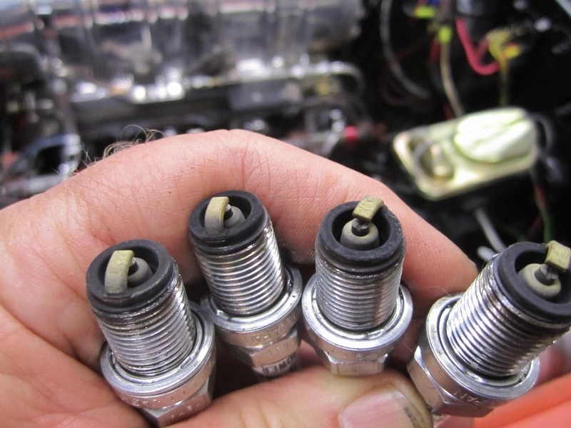

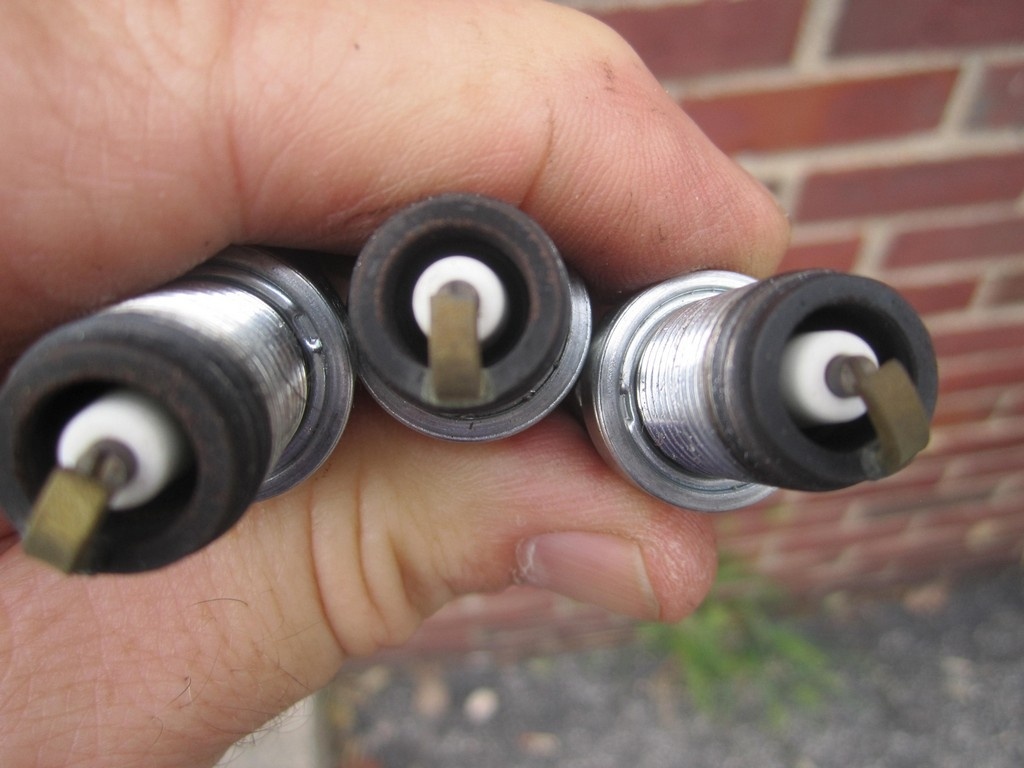

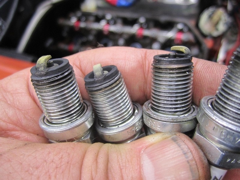

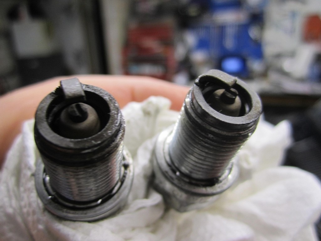

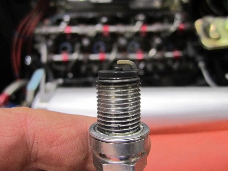

its difficult to read plugs since to read a plug you need to shut it off just as you pass through the trap. I was told that you really cant do that with a 727 so I never tried it. Anything beyond that wont give you an accurate reading I was told. I use a fast meter to record my air fuel from launch to finish. If I am doing something wrong please advise. Always open to new thoughts and opinions. Thanks
The fast is a good set up,I don't know if it records.I've been clicking off at the stripe with NO issues.It would be no different if you wer driving down the road and the car died when you were going 75 MPH.If the fast does not record,then you need a vid of your gauges as you go down the track. I have a Racepak logger dash and I STILL pull several plugs.I keep 4 extra plugs behind my seat so I switch them out and drive back to the pits.If you can't get to ant plugs without melting your fingers,then figure a way to drag the car back so it has a chance to cool off a bit.
it does record but, there may be other models. Some plugs 6 and 8 are nearly impossible without removing my inner panel.
