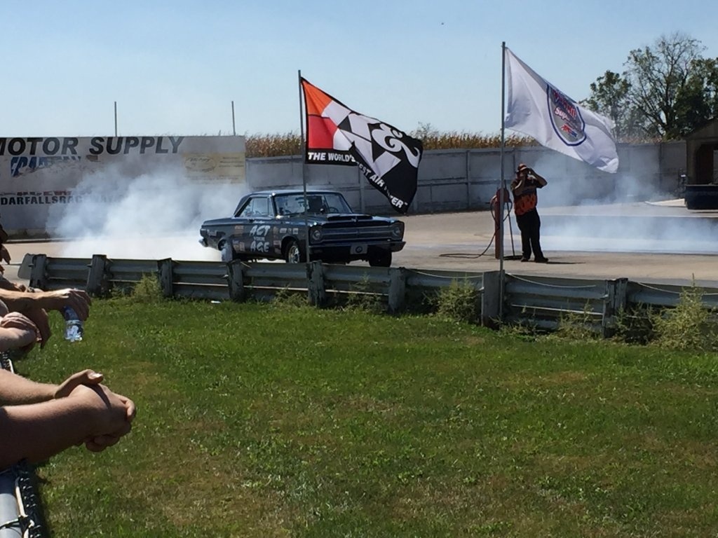

1965 Plymouth Satellite. 3750 lbs.
Wedge Stroked to 540 12 to 1 110 fuel
Indy 440-1 ported Indy Single Plane
Quick Fuel 850 annular discharge ( 72 primary 80 secondary ) AN-6 and Holley Blue
Comp Extreme Energy Cam Springs Lifters. Indy 1.5 Rockers Smith Bros. 3/8ths Pushrods 9.8
Intake 263 @ .050 Lift .606 installed @ 106.5 Lobe Sep is 108 degrees
Exhaust 267 @ .050 Lift .618
Tranz Act 727 Reverse body and brake. (do not use)
Converter is 10'' stalls at about 2500 to 3000 ??
30/9.00X15 Hoosiers. Tubeless and about 12 Lbs.
4.88 Strange Spool in a 489
Cal-Tracs under Super Stock springs with Comp Eng rear shocks
Torsion Bar front with manual discs and Cal-Trac 90-10's.
This engine was broken in on dyno and tested at 650 HP and 700 FPT.
I am running now at about 7/8 th. throttle (Less stroke on cable) and 36 degrees timing.
I have about 12 1/8th passes so far on this engine. Quickest was 6.93. It averages about 7.05 to 7.10 with current set up.
I want to add Cal-Trac mono-leafs and rear shocks and a converter matched to my needs Thanks for looking Dave
PS ( This is a pretty new deal for a pretty old guy and I take advice and criticism well ) 68 and counting
thanks for listing your build,not to many 1/8 mile guys here,that is why i asked.we run 1/8 here also and my car is also a 65,belevedere.mine is 3400 lbs with me in it,but do not have the motor that you do,i'll pm you if that is all right? thanks mark
