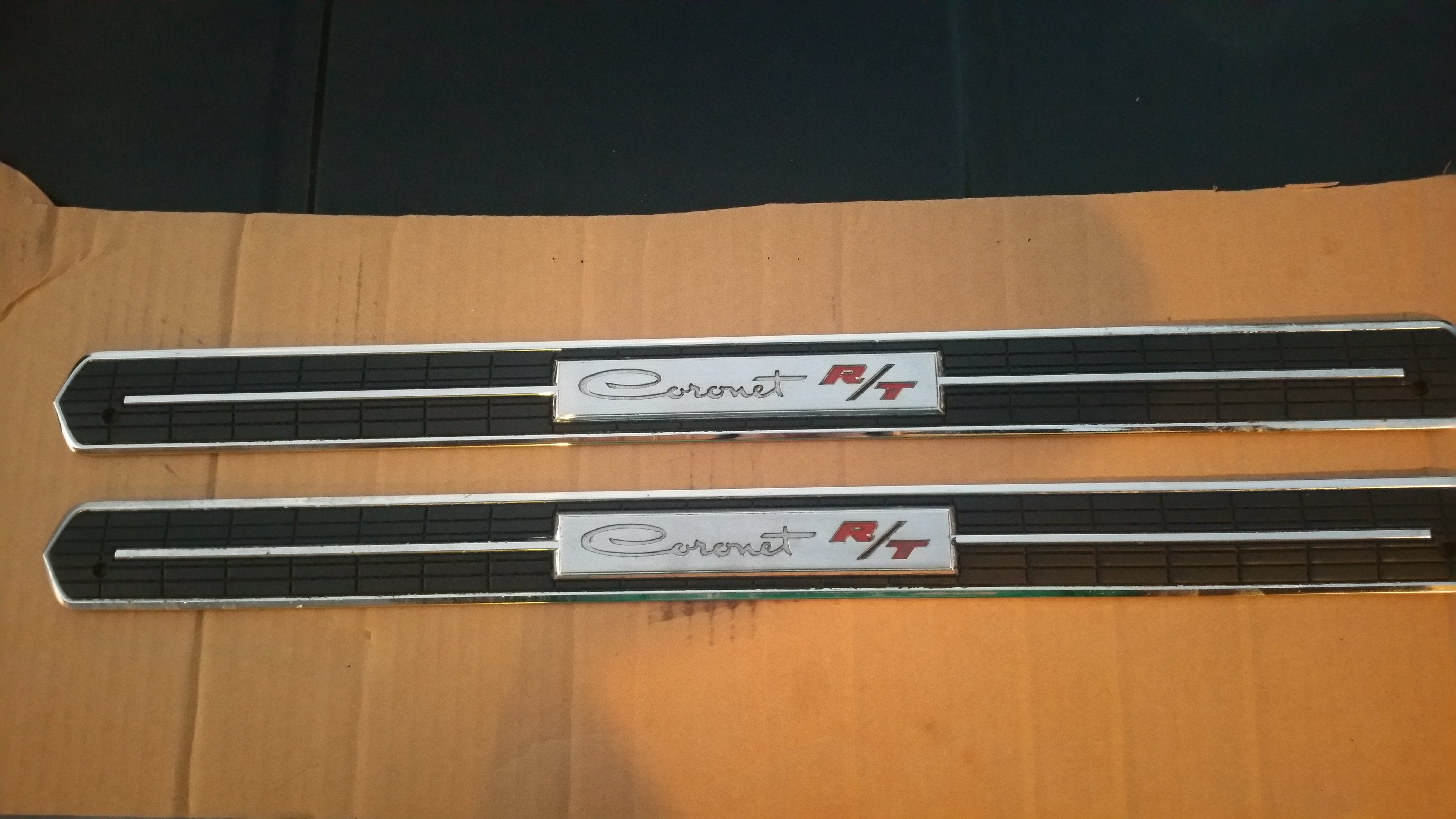

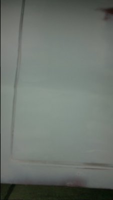

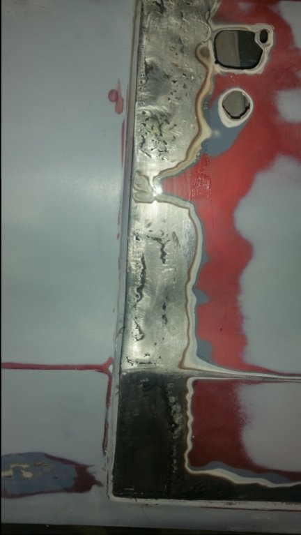

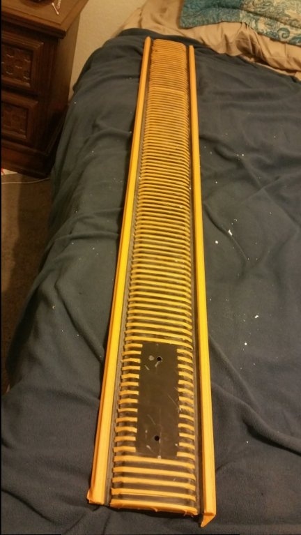

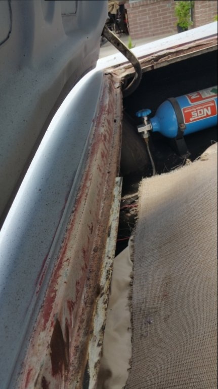

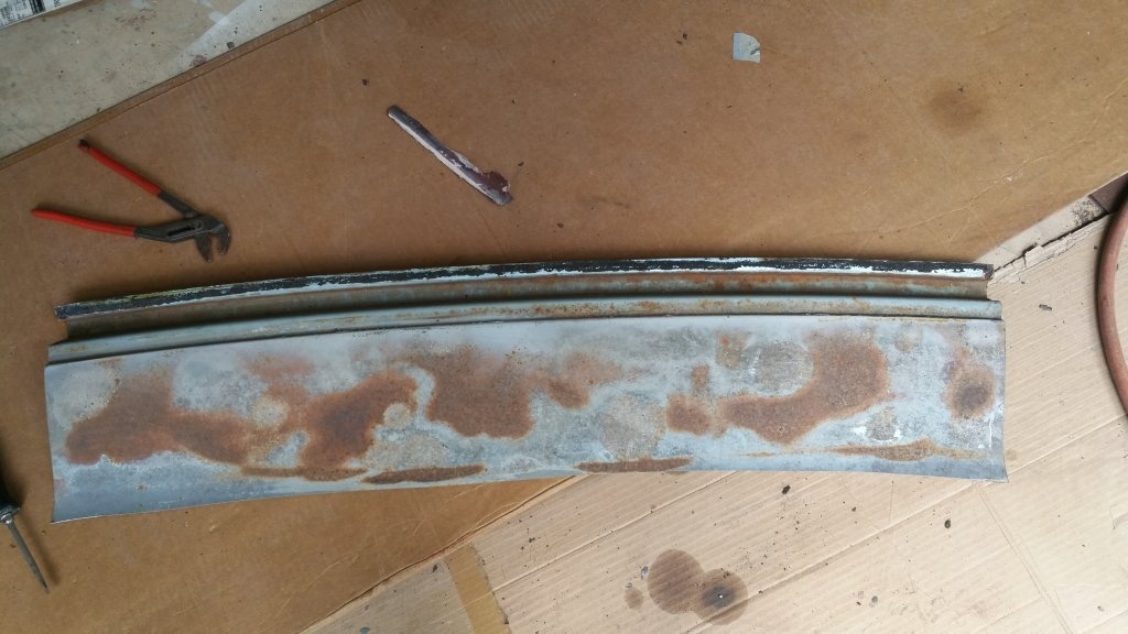

Here's the chanel and seal area I need to repair too. Along with the piece I took from the Belvidere.

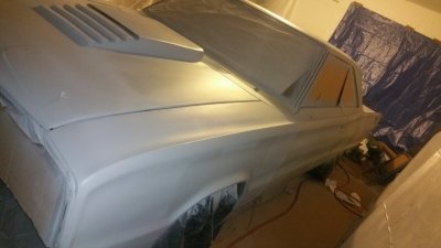

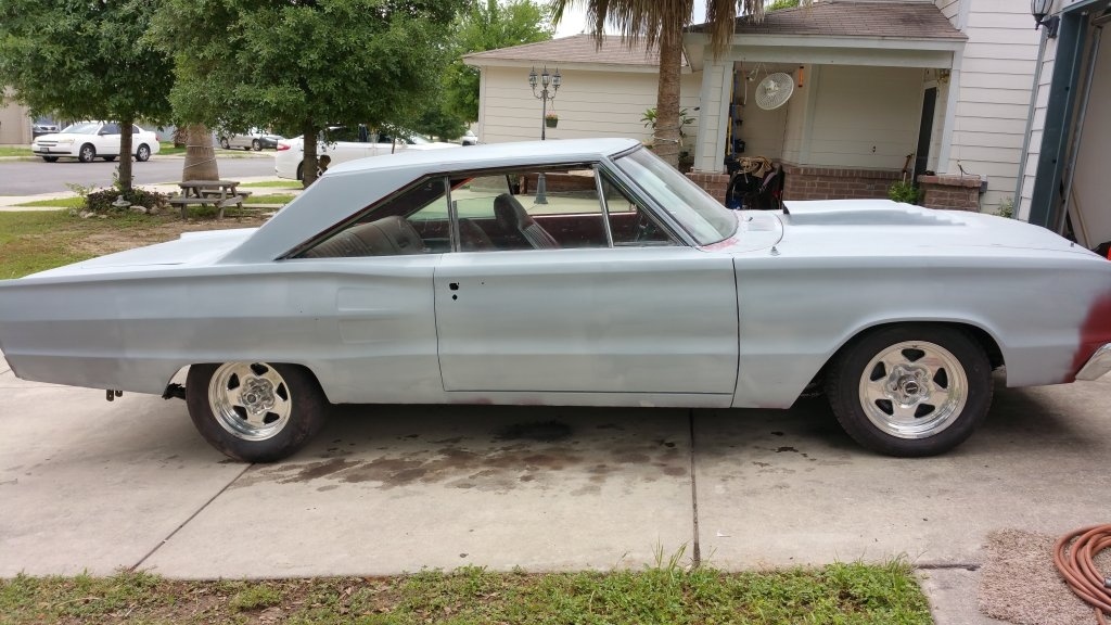

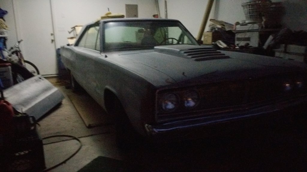

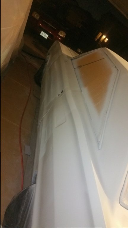

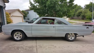

I was able to put a couple of coats of primer on both sides before the neighbor got back home. Now I can see some of the smaller imperfections that I still need to address. I still need to pull off the front bumper too. I can see the light at the end of the tunnel now

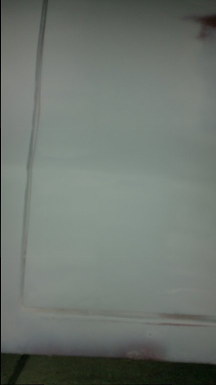

It only posted the first picture I added for some reason. Here's the other side. I only got to put one coat on this side though.

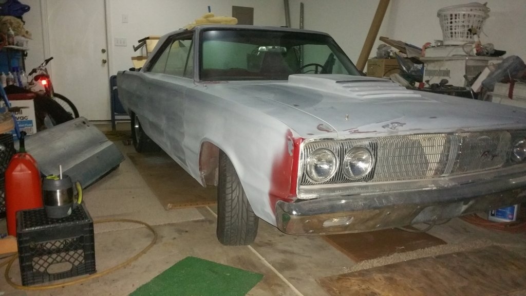

Today it was sunny so I looked at the car to determine the spots that need more attention, but mostly just relaxing this evening. Enjoying the view also.

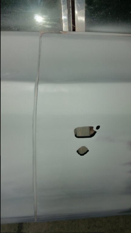

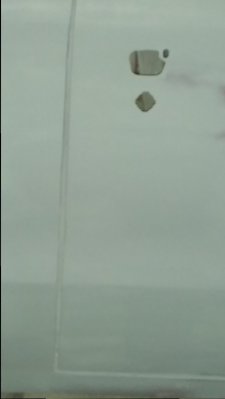

I decided to repair some problems I found on the Passenger side door. They became more noticeable with the primer applied so I cut out the problems and welded in some pieces. My welding still needs work but it'll do.

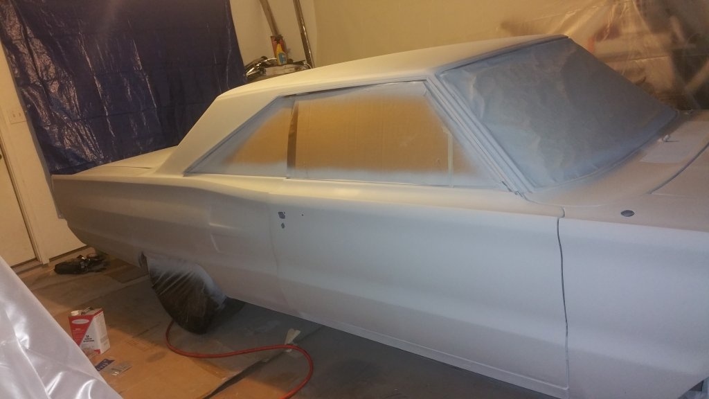

Finally was able to put 2 coats on the car. Luckily it was windy and helped with the smell. I put plastic all along the walls and floor so as not to get over spray on anything. Sprayed at low pressure also that helped. I'll post more pictures tomorrow when I take the car out.

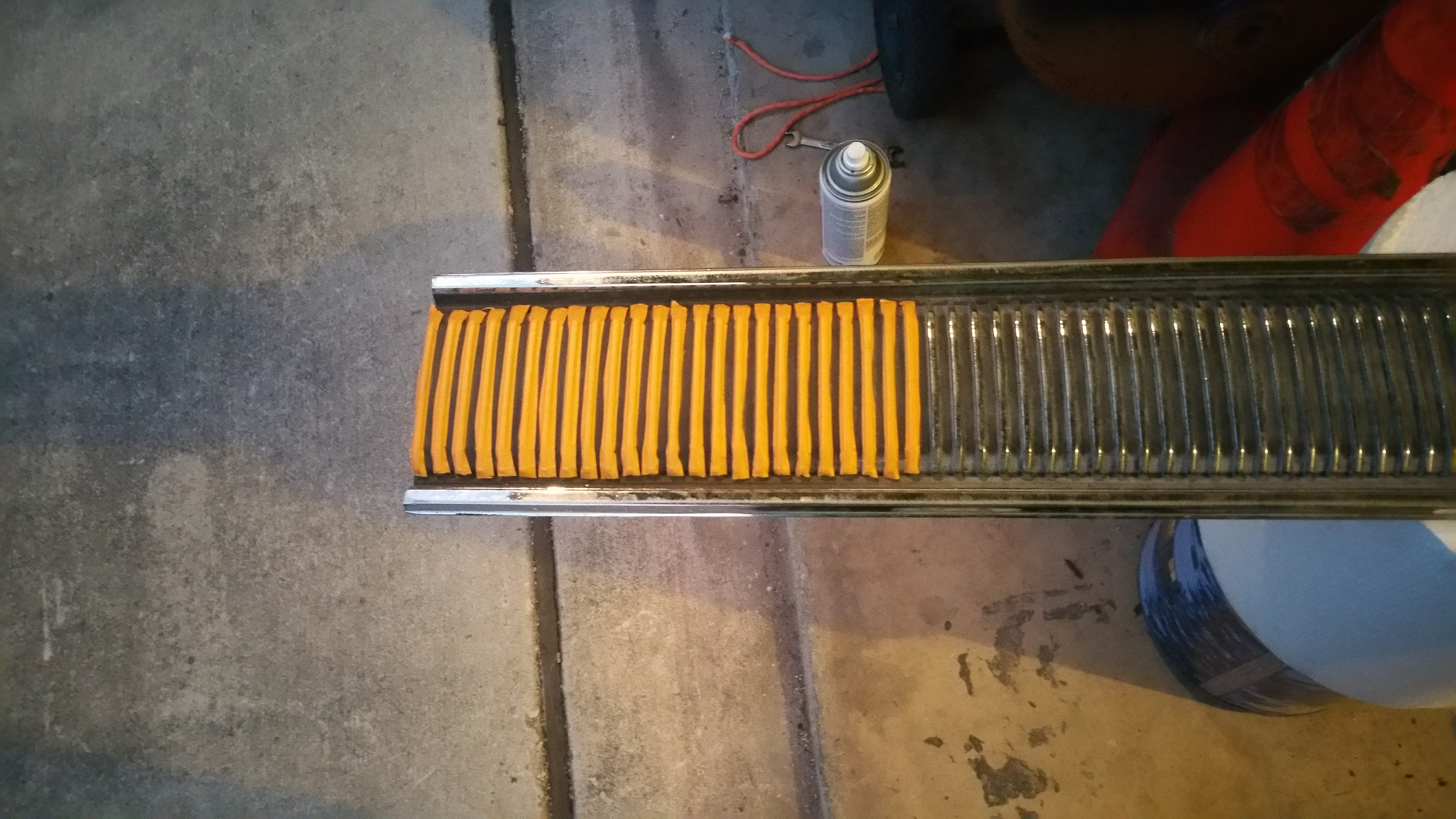

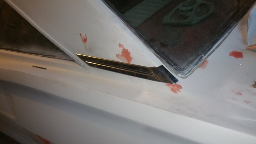

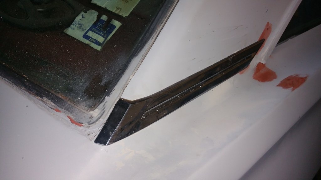

Test fit my sail panel chrome this evening and will try to wet sand the car tomorrow. Won't be long now till it's finally done. I've missed 2 mopar vs chevy/ford days at the track so far this year. I didn't plan on doing so much work on the car but seeing all the projects here gave me hope and inspiration to repair all I could. Thanks you so much f or this site.
