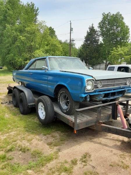

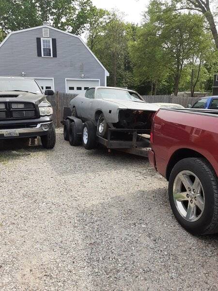

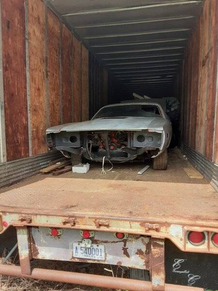

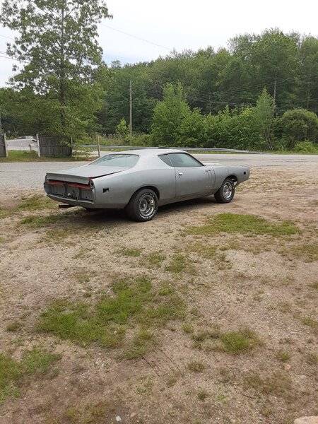

I didn't get to work on the car this weekend because I had to go help my friend swap a couple B body rear axles,then we got my rust free 71 Charger R/T that my friend brought back from the Arizona dessert out of his storage trailer,and onto my trailer to finally come home. we put my 66 Belvidere in the storage trailer until I get to it. Now I have to unload the car and get it in the garage.

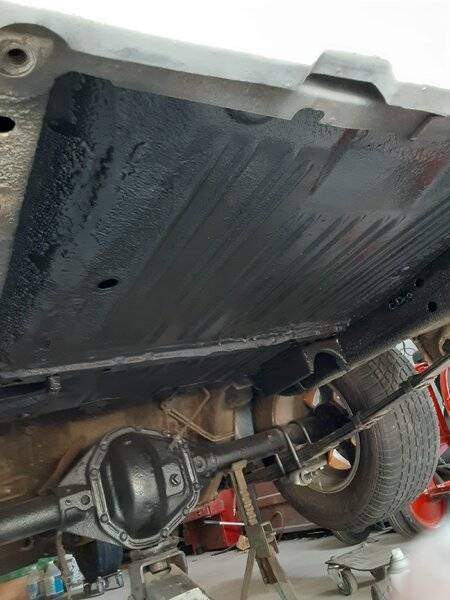

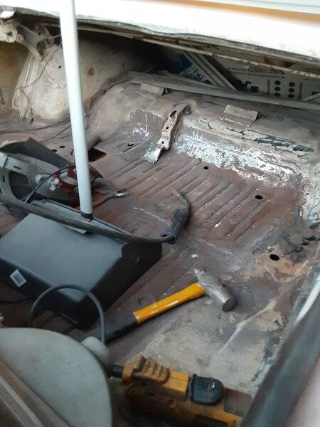

I took the day off yesterday with the hope of getting the fuel system installed in the car. So I replaced the center of the trunk floor with a piece that I cut out of a Charger back in the 80s when there were no replacement panels for Chargers. The piece was very solid for a New England piece. I went under the car,to dress the welds with the trunk lid open and I noticed that three spots on the piece I installed has a few minor pinholes, but we all know what happens when you take a welder to a pinhole.a pinhole becomes the size of a quarter! But I want the car to be 100 percent solid, so I spent the afternoon into the evening fixing the problem areas. I have to finish undercoating the area tonight and I can put the fuel system in the next available day I can work on the car.

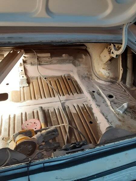

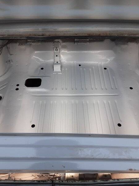

Ask and ye shall receive. I spent the last two nights doing the body work on the trunk floor pan. It was a flash back to the early eighties when I used to have to piece together trunk floor pans from pieces that came from several different cars,because there were no replacement trunk pans made. It would have been less work to put a new AMD trunk floor pan, this one required a lot of blending of the welds to finish it,but I was able to retain most of the factory spot welds, so I think it was worth all the extra work. The first picture shows all the blending of the welds,the next one is the trunk floor pan in etch primer.
We got some color on the trunk floor pan today! I might be able to get the fuel tank system installed yet!

View attachment 1113436 View attachment 1113437View attachment 1113438View attachment 1113439I didn't get to work on the car this weekend because I had to go help my friend swap a couple B body rear axles,then we got my rust free 71 Charger R/T that my friend brought back from the Arizona dessert out of his storage trailer,and onto my trailer to finally come home. we put my 66 Belvidere in the storage trailer until I get to it. Now I have to unload the car and get it in the garage.
C'mon man....there's no 'i' in Belvedere lol
I let that slide, yet see no parade for my efforts.
