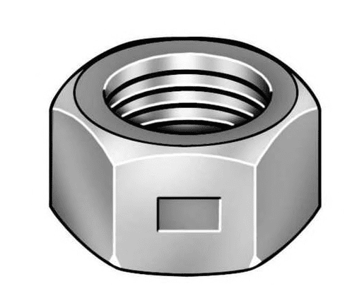

The thing about the correct original motor mount bolts is they are a fine thread with a lock nut... Not the nylon ring type lock nut but a dimpled nut... The depression on the side slightly distorts the thread causing the nut to take extra effort to turn which prevents them coming loose...

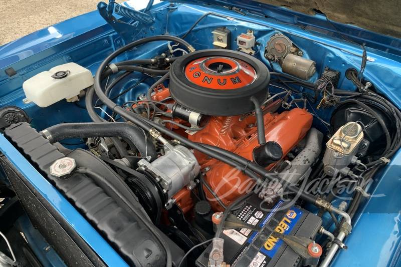

But here is a 1969 Dodge Charger R/T 440 engine bay

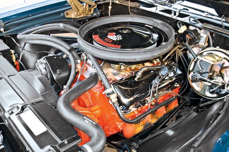

And here is a 1970 Chevrolet Chevelle SS 454 LS6 engine bay
There obviously is more working room.

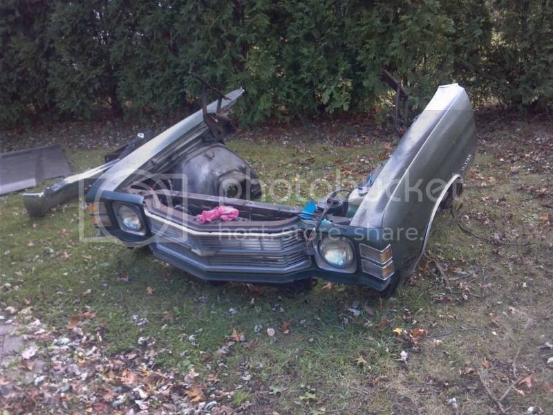

Also with the chevelle you can do this:
You can't do this with a b body mopar.
No....but you can do this if you really have to.....
On a shop hoist it takes about 3 hours for the untrained like me.....on the floor as in the picture.....about an extra hour.
Thinking about it this in combination with the fact that there is almost no working room is why i hate this job so much.
If there was more working room it wouldn't be to bad and if those bolts came off easy it would also be way easier to do...
I just replaced the tie rod end clamp bolt on the passenger side as it was bent. The driver side one was fine after a wirebrush. I was wondering what that little rectangle was for!
The USA made Moog adjuster sleeve has grade 8 bolts with the aircraft nuts. I used one of the bolts.
