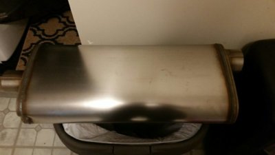

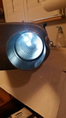

Ok, so my '66 Poly 318 has a nice set of flowmasters on it. Sound great from the outside, but the dreaded flowmaster "drone" is wearing a bit thin. Soooo, I'm contemplating changing them for something else. Here's where you guys come in....what would be a good replacement that still sounds good from the outside but quieter on the inside? I already had an H pipe installed a couple of years ago with little difference. I'm thinking magnaflow or something similar. Any suggestions? Thanks guys!
look at accurate exhaust guy has mufflers that are hemi muffler size just put two on. They are magnaflow mufflers and are getting more rumbling after couple tanks of gas
