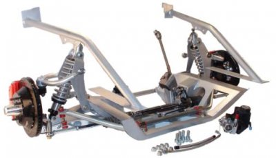

I'll tell you what my biggest hang up is with the new suspension "structural integrity". If you stand back and look at the front end and imagine everything being bared down on just the a arms, that little frame rail and the inner fenders it doesn't seam like much for rigidity. Now if you look at the factory setup where it's spread all the way back to the torsion bar crossmember you've got allot more car holding it all. Maybe I'm over thinking it but I just wonder how these cars will look after several years of being loaded on only the front end, we already know they'll hold up for 40+ years as they were. If I were to do it I would add some structure like a roll cage or something. Here's a setup that I like the looks of. modular front end.jpg

I understand what you're saying - The alterKtion front clip that I've been looking at has some additional supports.
Here's a good video of an install:
http://www.youtube.com/watch?v=KbU5vFWVscM
The upper control arms use the existing upper control arm mounting points, the support for the shocks actually bolts into the side of the existing front frame rails, and ties most of the "support" into the existing chassis. At least that's my view - did I miss something ? That's the reason I'm still researching the front clips. You're right that it does not tie in all the way back to the torsion bars, but the tubular arms and connecting points have unlimited adjust-ability. I thought it would be far better than the current set up, but from post I've been reading, and the right upgrades, you can get the mostly current stuff dead on - however . . . the newer stuff sure helps when your're trying to stuff a set of headers under the hood.
