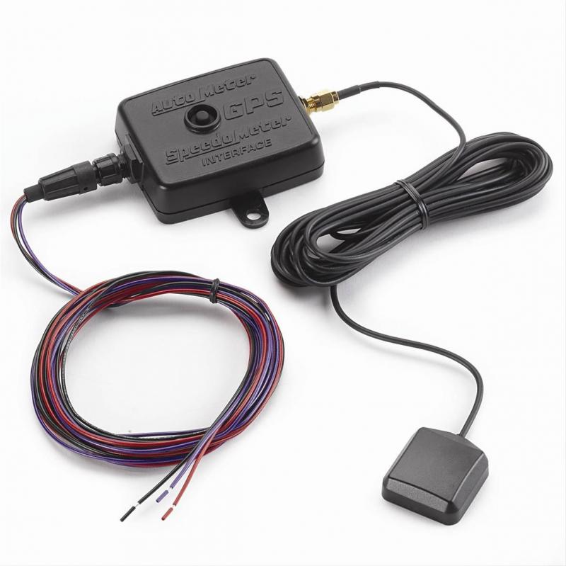

The chrome shop called Friday and said my frames were done and that they would ship that day so early next week I should have wheels and chrome for sure. I think my list goes something like this now, tires, headlights (halogen), vacuum solenoids, electric speedo sending unit, front turn signal lenses and I think that's about it. There of coarse are many other things like a stereo, A/C unit, etc but these are the things that I need before I put in out the road. Speaking of the electric speedo sending unit I'm thinking about using one of the GPS units........it's pretty cool, instead of going off the tranny it uses GPS meaning your speedo is always on even if you change gears, tire size etc. My plans for this weekend aren't panning out to well, I re-sided the front of the house last weekend and the wife didn't like the color so after work today it was more scaffolding time but this time she was right beside me tag teaming it. Maybe tomorrow "yeah right". gps.jpg

747 That GPS unit sounds awesome! I know you built a custom dash, but i cant remember what speedo your running? Im guessing you have to have an electric speedo and this GPS unit cant be made to work with an original cable drive type unit?
Thanks, I used all Auto Meter Carbon Fiber gauges. I'll be switching to a 5 or 6 speed in the future so going this route will save me from buying another sender down the road.
