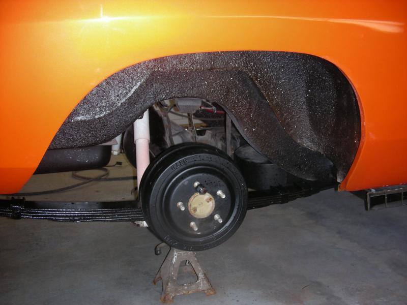

Go figure, no tires again. I'll go paint the springs and drums flat black in anticipation that they'll be here tomorrow. Sorry, really thought I'd see them today.

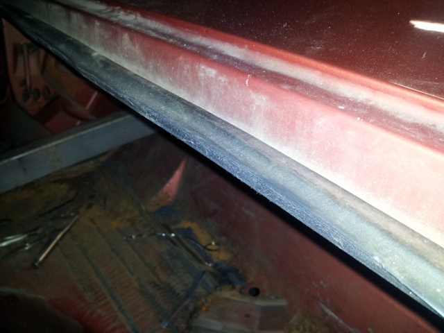

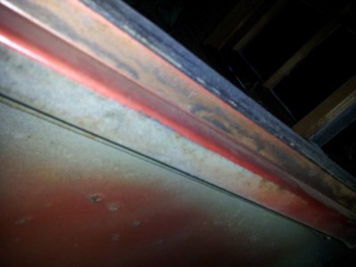

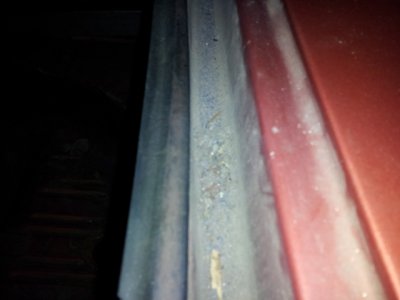

Trunk seal on my 67 Belvedere . . .
Ruh roh . . . forgot about the pics . . . didn't know if they'd be the same ? ? Here they are . . .
Looks like there's a little "lip" on the rubber seal that hangs over the edge of the metal.
Hope these help you out . . .

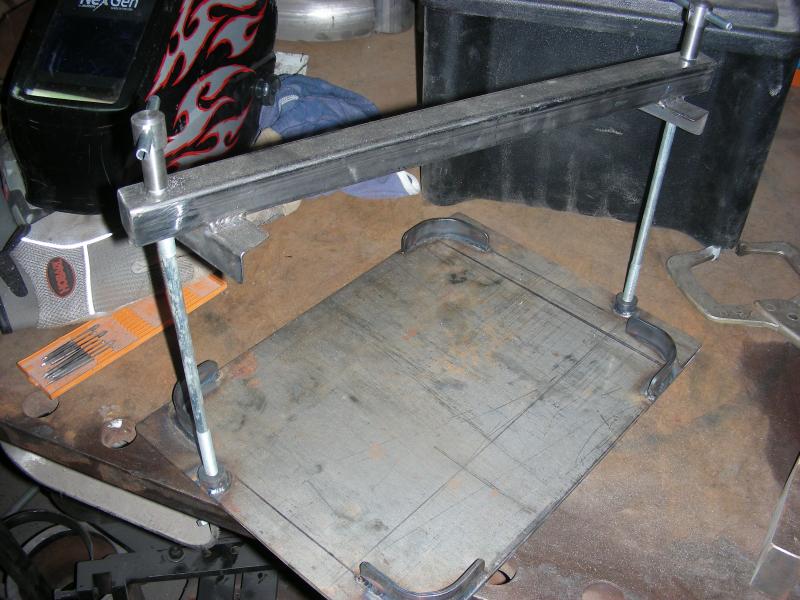

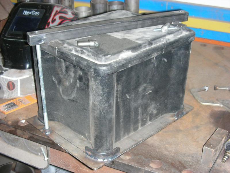

Another thing almost done, I bought this battery box at Summits scratch and dent sale for dirt cheap not thinking about where I was going to put it (can't hardly pull a battery out of it when it's under the quarter panel). Here's the solution, I made a tray with short corners and a clamping bar (remove bar, lift whole box an inch and pull the whole thing out where you can get to it). Also fixed the stripped hole in the vent window frame (drilled and tapped from a #6 to a #8-32). I then tackled the wallored out pivot pin hole in the other vent window frame, I had what I think is a really good idea for fixing it. Not wanting to take a chance of breaking it by drilling it and driving the pin in I chose to tap it 1/4-20 and I'll make up a new pin with threads on it and locktite it in. DSCN9175.jpgDSCN9178.jpg
Cool idea on the battery box! I hear ya with getting stressed on the wheels not even that it's been that long it's the over-promising and under-delivering... No point letting it stress you though you're taking the right approach.

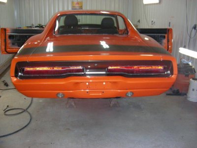

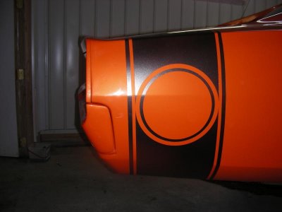

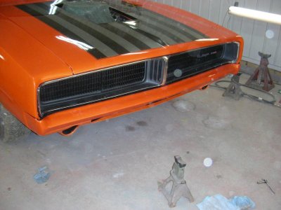

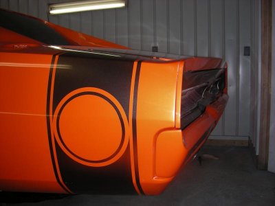

Here's the bumpers on the car, nice to see them on there after all of the cutting and welding that went into them.:eek:DSCN9169.jpgDSCN9189.jpgDSCN9190.jpgDSCN9192.jpg

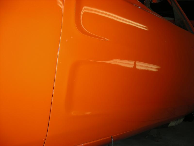

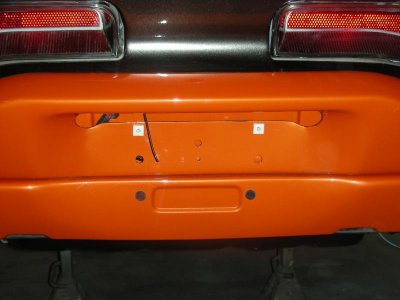

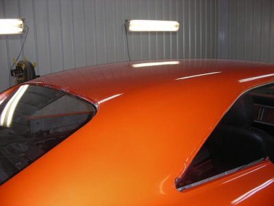

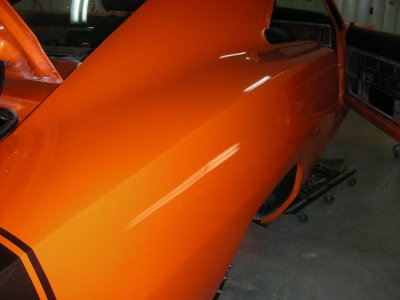

Here's some close up's of the areas that I had to touch up, finally no blemishes. Check out the top of the quarter panel where it meats the roof, I had to touch up the quarter and masked it off there. The guys at House of Kolors told me I could blend the clear in and then burn it in (spray straight thinner over it to blend it into the old clear), worked pretty slick. Anybody know if there are supposed to be any rubber bumpers in the bumper where the license plate goes? I put the plate on there but the edges of the plate were touching the bumper so I'll either space it out a bit or hopefully there are supposed to be bumpers there. DSCN9201.jpgDSCN9200.jpgDSCN9199.jpgDSCN9198.jpgDSCN9203.jpg
