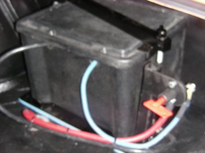

Almost done wiring, hooked up my turn signals, parking lights and reverse lights and the only issue I had was the front marker lights weren't getting a ground threw the fasteners but once fixed presto "we have lights". I was a bit nervous about it all working seeing how it was a universal kit and it would be hard to tear all the tape off to trace down but thanks to American Autowire for they're labeled wires and so so instructions it all went off without a hitch.:hello2: While at Summit picking up my Optima battery I picked up a master battery disconnect so it can be shut off while sitting and made a bracket for it and the battery (sorry for the dirty pic). Thought I'd show a pic of the cool battery terminal crimper, put your connector in there and whack it. I also soldered it and shrank wrapped it while I was at it. Almost forgot, also picked up these cool weathertight conectors for the exterior wiring. DSCN9263.jpgDSCN9264.jpgDSCN9259.jpgDSCN9265.jpg

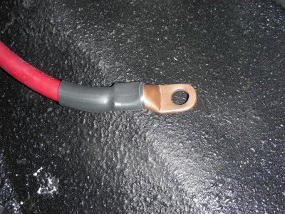

looking good 747, i gotta get me one of those battery boxes to. liked how you put the cutoff switch in there. as for the rearend i got a big sign to remind me other wise i wouldve done the same thing. lol

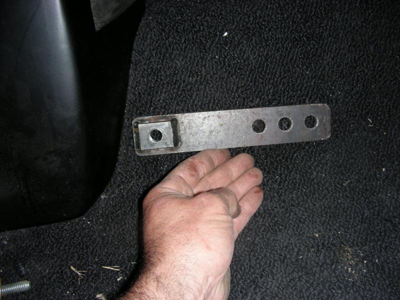

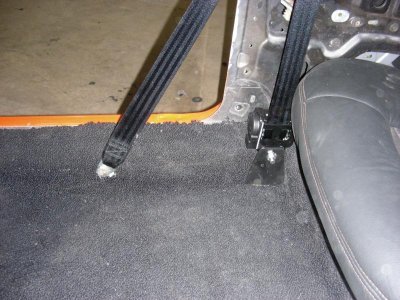

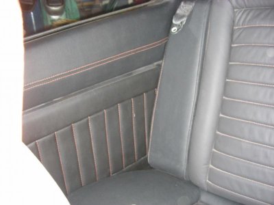

Here's the final fix for the front seat belts. The buckles were way to far back so I made this bracket that goes under the carpet to move the hole forward and still use the factory location. I think I'll have the upholstery shop make a boot to slip over the reels on the floor??? DSCN9326.jpgDSCN9347.jpg

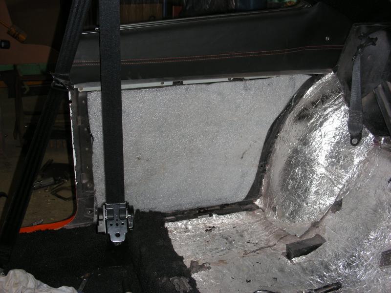

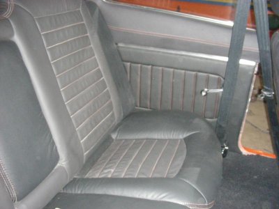

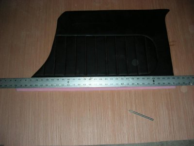

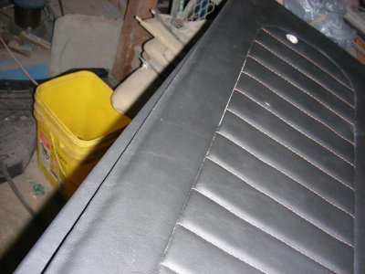

Here's the progress on the interior. The first night was a failure, spent all night coating the insides of the quarter window area with Por 15 then coating the crap out of it with rubberized undercoating (sound deadening). When I finally got to the panels they fought me and wouldn't go in. The next night I found the problem, the upholstery shop made the area that slips into the stainless trim to thick. I pealed the cover back, trimmed a 1/2 of the padding off and re-glued "walla". Don't know how good this will work but I was looking for something to seal the area up like the thick plastic they used when I saw this, it's the same thing they wrap things in for packaging and Detroit Muscle uses to make allot of the body gaskets out of "I think it's an upgrade myself".DSCN9364 - Copy.jpgDSCN9365.jpgDSCN9366 - Copy.jpgDSCN9371 - Copy.jpg

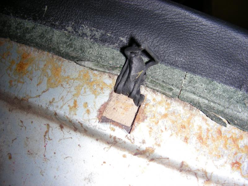

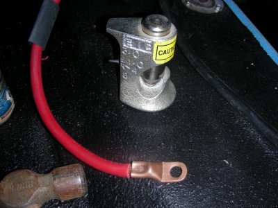

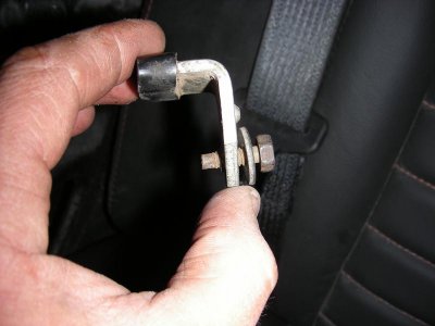

Here's something I like to do with just about everything, I keep some Butyl Rubber in a ribbon laying around and use it to eliminate rattles by putting it on most fasteners (works great for sealing exterior screw holes when put on the threads). The other pic is the culprit for all of my headaches with getting the rear quarter window adjusted properly. I used a bolt about a 1/4 to long and the window was stopping at the bolt instead of hitting the actual stop (always something simple). If your rubber is missing from your stops I found stretching radiator hose over it works great.DSCN9351.jpgDSCN9353.jpg

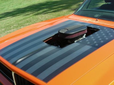

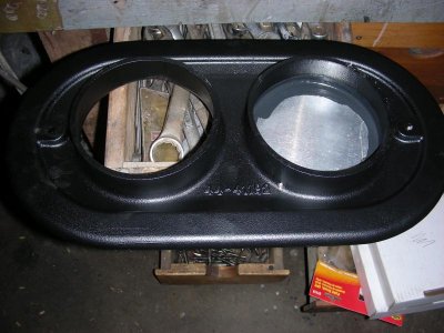

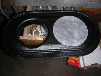

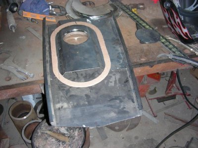

Here is the beginning of the scoop tray which will likely go in the trash. After starting it and looking at it I was happy with the 14" air filter (to close to the edges of the opening and just didn't look right). After some looking I found this duel quad filter from Edelbrock that had just the right dimensions. I made an aluminum plate and bolted it over the one hole and sealed it up, with this on I'm thinking about ditching the 1" carb spacer to lower the filter and then just fastening the shaker base to it. Wow!! this is one nice stout filter and I'm not embarrassed having it hanging out for now. DSCN9374.jpgDSCN9375.jpgDSCN9406.jpgDSCN9361.jpg
