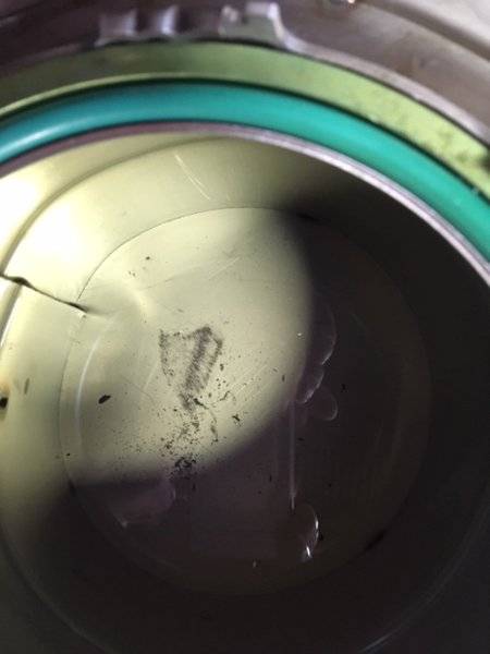

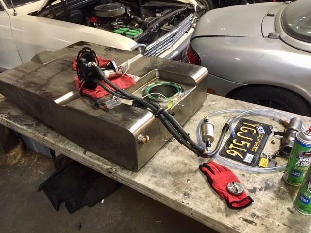

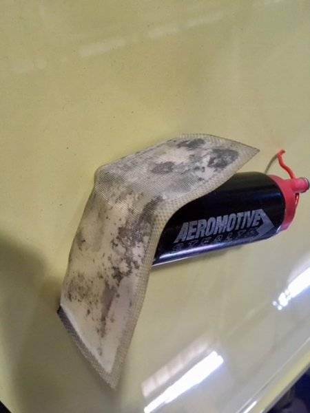

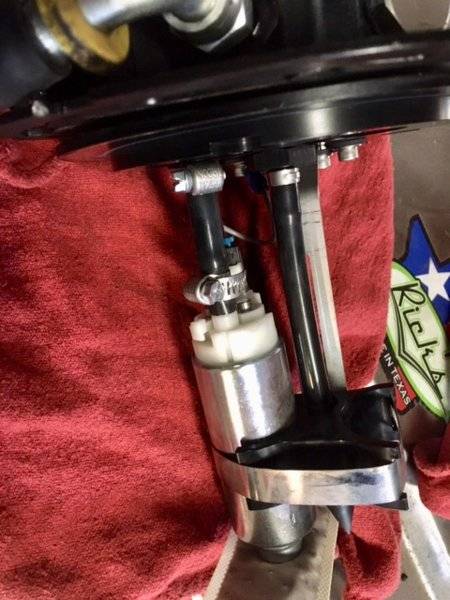

I’m confused, so I’ll let the pictures do the talking.
I know I'm looking at an in tank pump.....right? But what's the pic on the top right? Things are looking kinda nasty.
Second from top is looking at fuel in tank. Not sure.

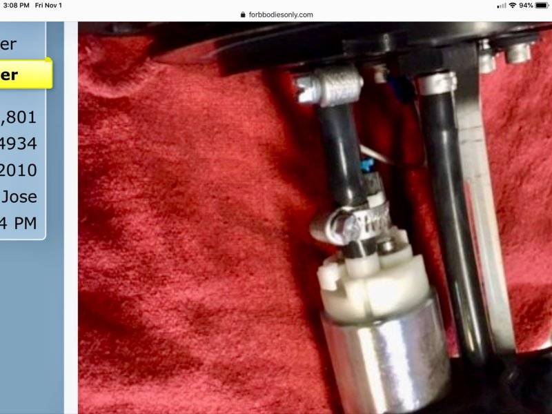

This is the second pump. The replacement AC Delco. I’m told that the clamp used here is the wrong application.
Dennis, you mean clampS....there's no way I'd use a clamp like that even on my own junky stuff!! That is just wow holy cow nuts stuff....
Screw clamps are bad?
Not all screw clamps are bad, but the generic ones tend to cut the hose and not apply even pressure...
Zebra Clamps are pretty good.... The video commercial is irritating but has good info..
Ah I dig.
I prefer the "fuel injection" ones myself, the ones with the "faded" shoulders and 360 degree contact
surface.
Your right and it has been changed. But again sometimes people forget haha
View attachment 858932 This is the second pump. The replacement AC Delco. I’m told that the clamp used here is the wrong application.
Dennis those clamps cut into the hose and expose the inner lining of the hose which is a no no. If using that type of hose use the silicone squeeze clamps it has a smooth inner clamp base and won't cut the hose. That is part of the problem that most folks don't get. It's not the big **** that kills a project it's all the small stuff.

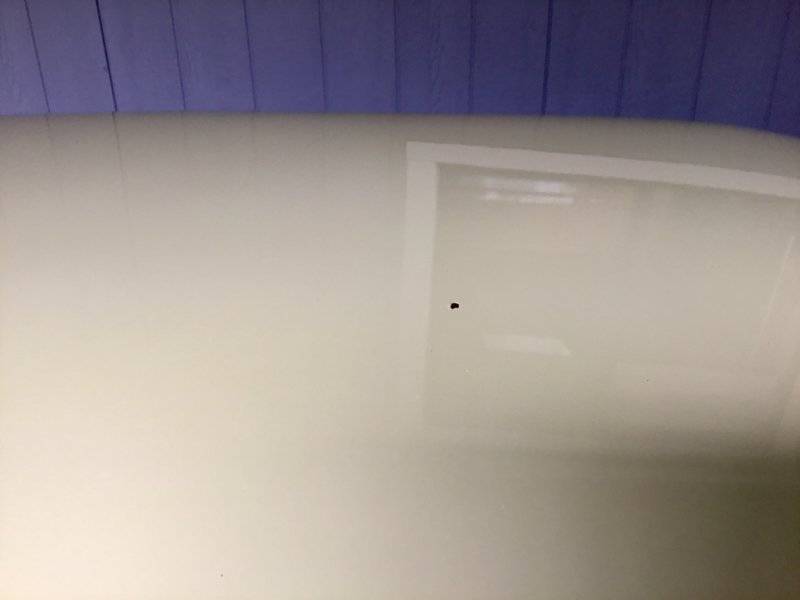

Paint chip in roof. It was loud, had it been the windshield it would have cracked.

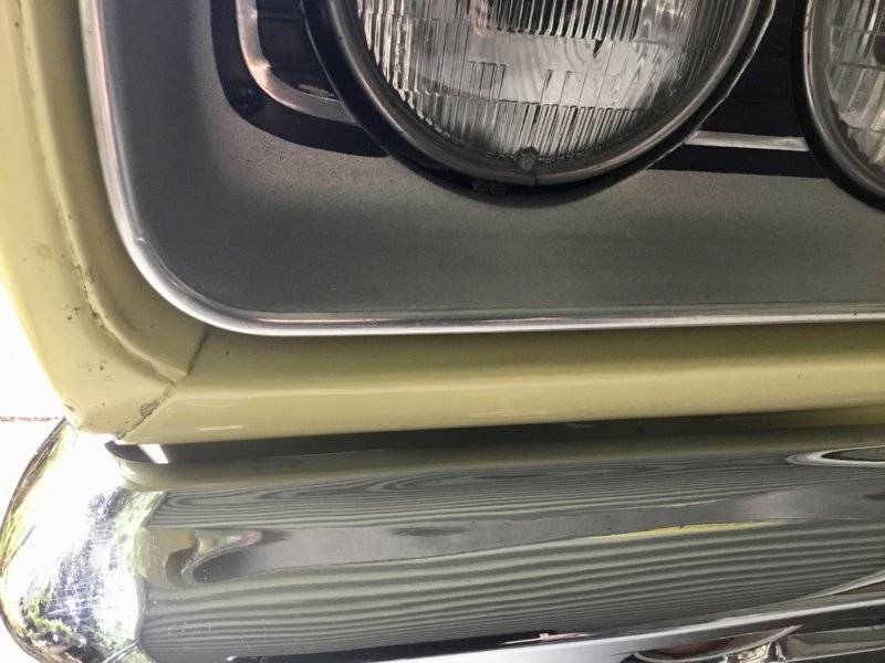

Bumper to body gap closed on passenger side. Got tapped somewhere.
