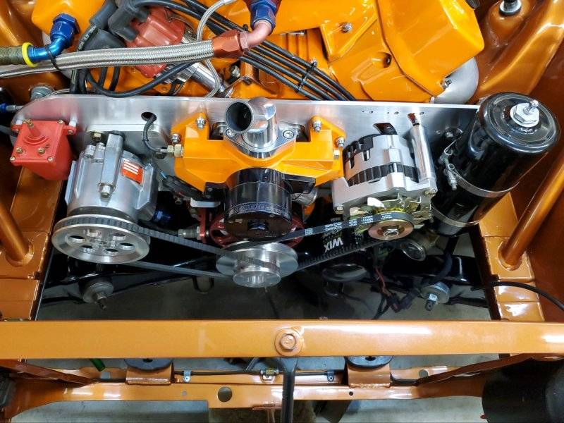

I run them there. In fact my racecar has the wiring passing thru the RF frame rail exiting by the motor plate. Very little wiring is visible in the engine compartment.

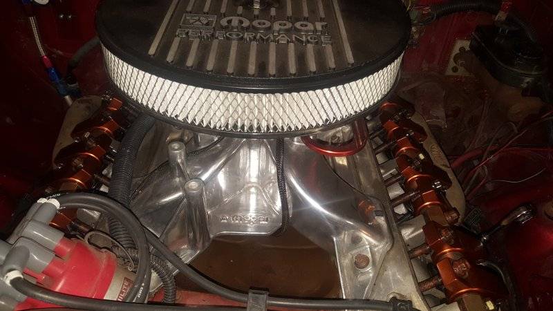

Been this way 13 years with no issue. Pic #1 all wiring forward of the firewall is installed in this pic #2; When adding a larger alternator last year the relays on the motor plate were relocated to the rear of the plate. So they don't show now either

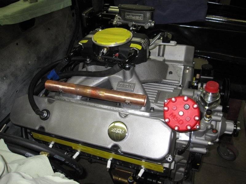

I used a piece of copper tube (because I have lots of it) with silver soldered brackets as a conduit on my 65's engine.
Mike

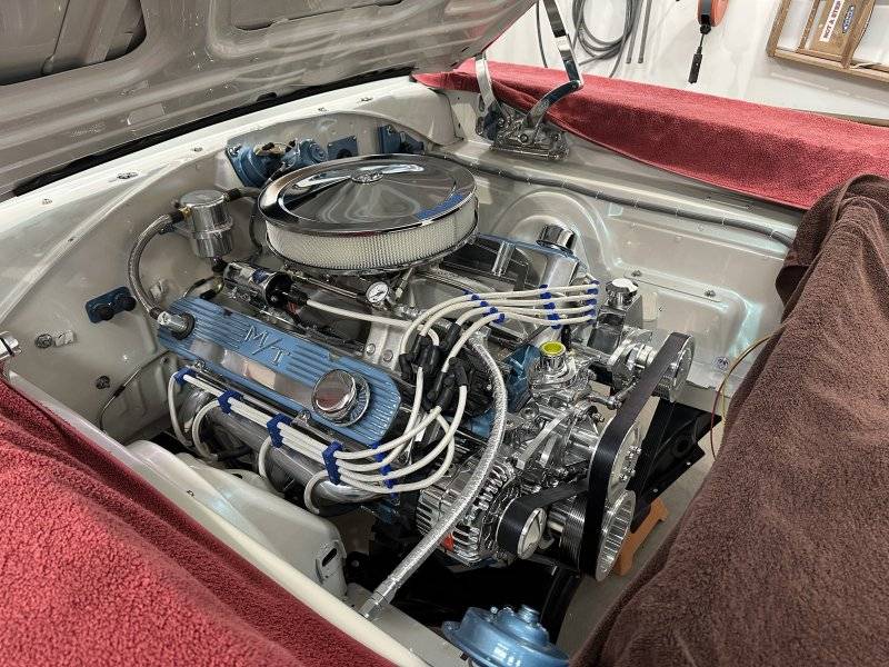

Thanks guys. Underneath it goes. Some nice looking engines here.
