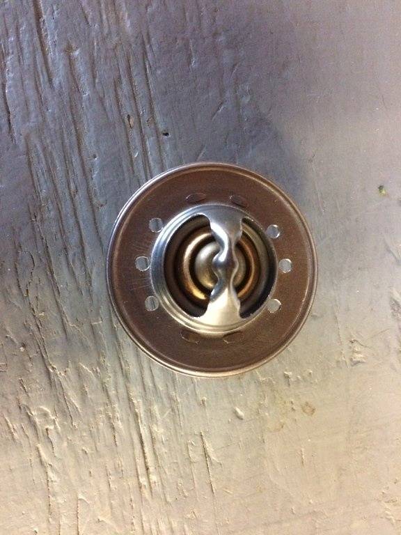

So, picked up a nice billet thermostat housing and a 180 t-stat this week and will get it installed shortly. Drilled 6 , 1/8" holes in the t-stat. Won't know how if the holes clear the rim until I get the housing off. We'll see how it all works out I guess..
So far the modified thermostat seems to be doing the trick. Ran the car up to temperature a couple times and it seems to warm up as it should and still has regulation to keep from overheating with no collapsed hoses on cool down. I'll be more convinced after running it around some.
I used 6 - 1/8" holes to approximate the open area of the 3 - 3/16" holes that Stewart uses on their thermostats.
