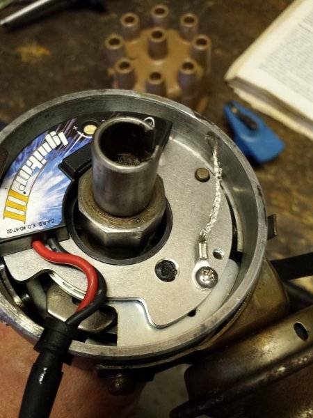

Thanks for checking in Geoff. Coil is E-core. Just checked the voltage right at the connector on the module it is 14.3 volts while running higher RPMs.
Thinking this is not the issue now. So far 3 LX301 Std Ignition and one Napa TP45 modules have failed.
Edit: I have the 1-3-5 plug wires bundled together where they pass down between the PS pump and the head. Maybe there is some cross firing there causing the problem? I will fix this next.

Hey Bob if I fry one more HEI module I am going to put in a points system!
Although all the failures I believe were my own blunders.
I'm a fan of Pertronix Ignitor III and Flamethrower coil. Multi spark, rev limiter, and gut the ballast resistor. Flawless for 8 years in my GTX. Mine is the drop in unit so it went in a factory single point distributor.
