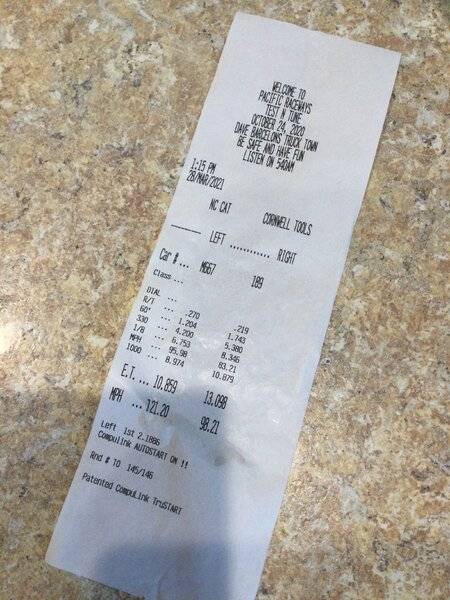

1st pass: 10.85 @ 121!! Didn’t see that coming! Brought it back to the pits, climbed under it and looked everything over, all looks to be just fine. 60-ft clocks were screwed up, and said I went 1.209 in 60. No way that’s right, and my buddy right behind me in the same lane had no 60’ on his slip, so something amiss in the beams there.

there’s obviously still some doubt. It felt like a rocket ship though. My buddy watching said the front end was nearly a foot off the ground at the hit. When I looked at the slip I thought I was going to see an 11.0X. The 121 seems low, but when you add up the 4.56’s, a 6.75 660’, and the dual plane intake @ a 6700 stripe rpm, and it makes more sense than it looks like at initial glance. Ultimately, I think the exhaust change was a much bigger gain than I figured it would be.

Here’s the slip, Tex. The incremental s do look pretty jacked up. I won’t really know until we get it fixed. But dammit, I’ve got a slip that says 10.85..... Let’s not piss in my corn flakes just yet. Hahah
Those incrementals, other than the 60 ft, are not very far off what your 1/4 shows. Maybe a little quick e.t, maybe a little slow mph.
Exhaust change, more gear, more traction, less weight, i can definately see 10.80s. The 121 just means the chassis is working good for the power you have.
Congratulations!
Edit: just looked again, that 4.200 at 330ft is quite optimistic too.
Congratulations!
the other thing that’s weird is the reaction time. New combo, so it could be right, but I think I know what .207 would feel like, and I honestly think I was better than that. I’ve never set up beams, but what if the total times are right, but the reaction and the 60 are overlapping each other. The fateful 2nd run was in the opposite lane, .015 red, and felt exactly like it looked on the slip from behind the wheel. Could it actually be a .004 and 1.47 ????

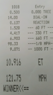

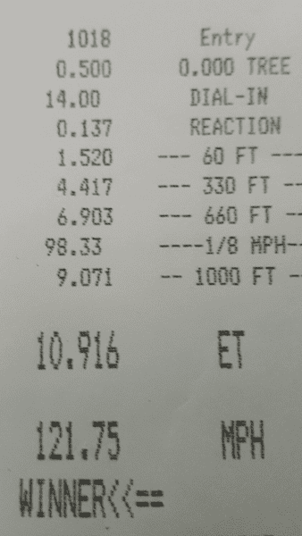

Here’s one from my friends Stocker when he has the 350 in it.
It has been as quick as 10.80, with a best speed of 123 with that combo.
