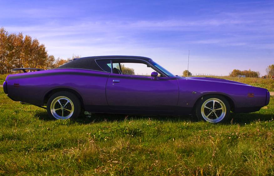

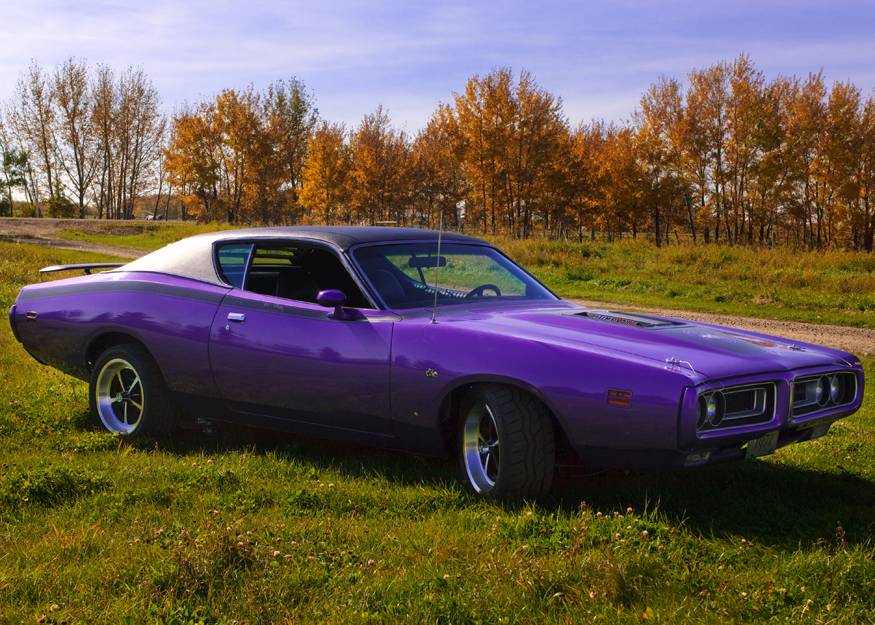

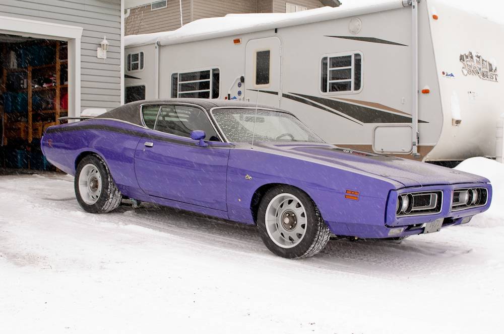

Well it wasn't washed and waxed when I took these photos, but we are real close to being done with all the cosmetics ;) Wheel opening moldings, chin spoiler and Superbee emblems to go on the fenders yet! Other than that it has come together very nice. The stripe completly changes the look of this car.

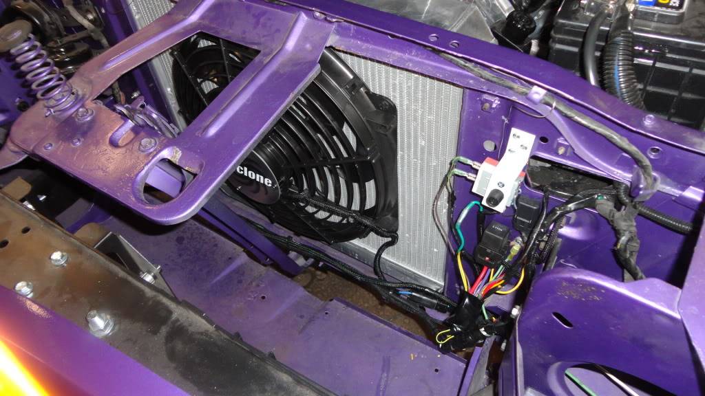

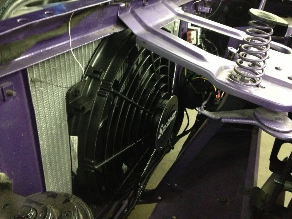

Well to help with cooling I put a 16" pusher fan in front of the rad. The twin 10" don't seem to have the cooling for the big 512 in stop and go traffic.

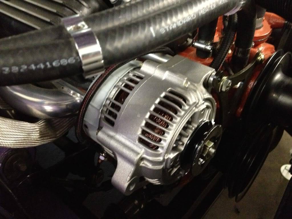

Also put a newer style alt on to help with powering the fans as well as the stereo.

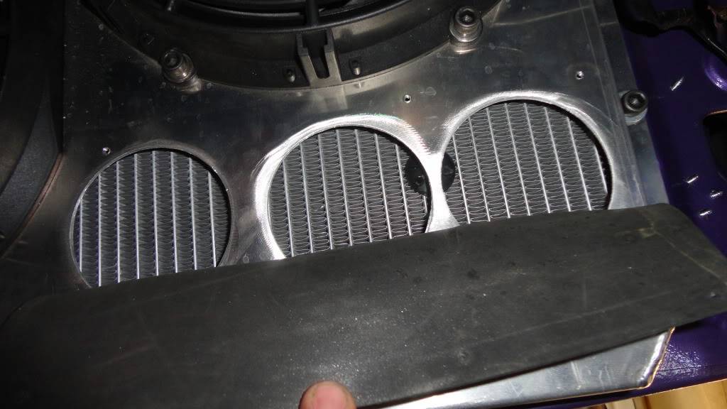

Holes cut in fan shroud and flaps installed. This baby will run cool for sure now!

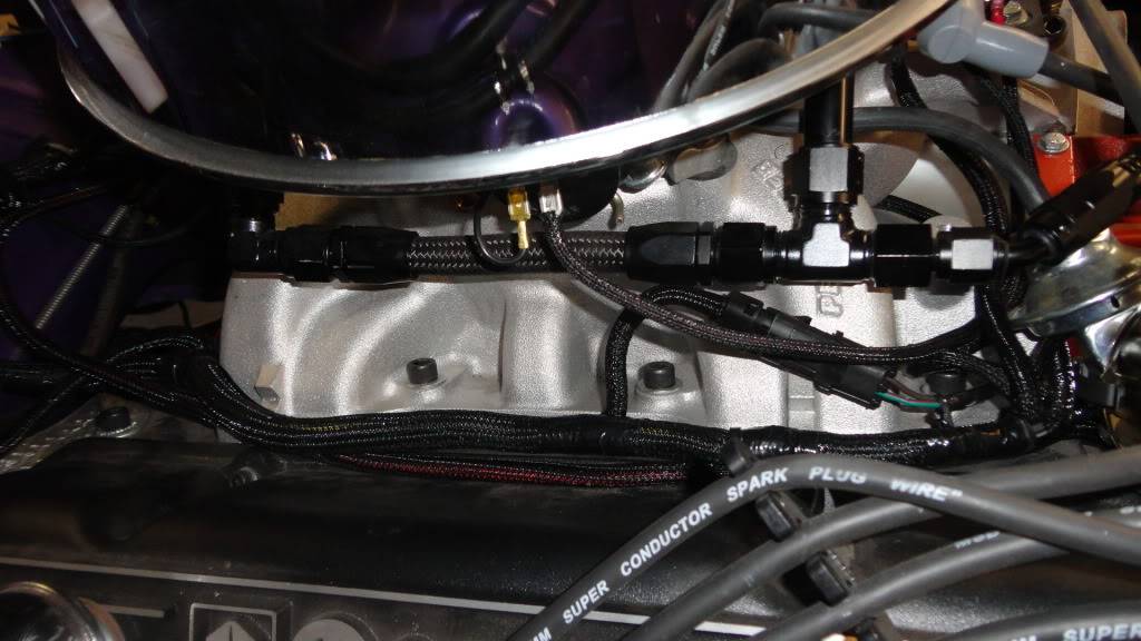

Making some of the wiring look a bit neater.
It now has an adjustable temperature sensor to regulate when the fan comes on.

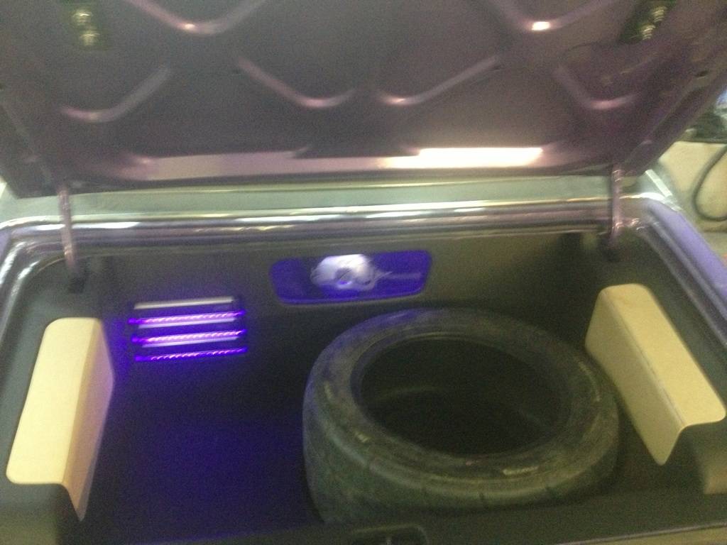

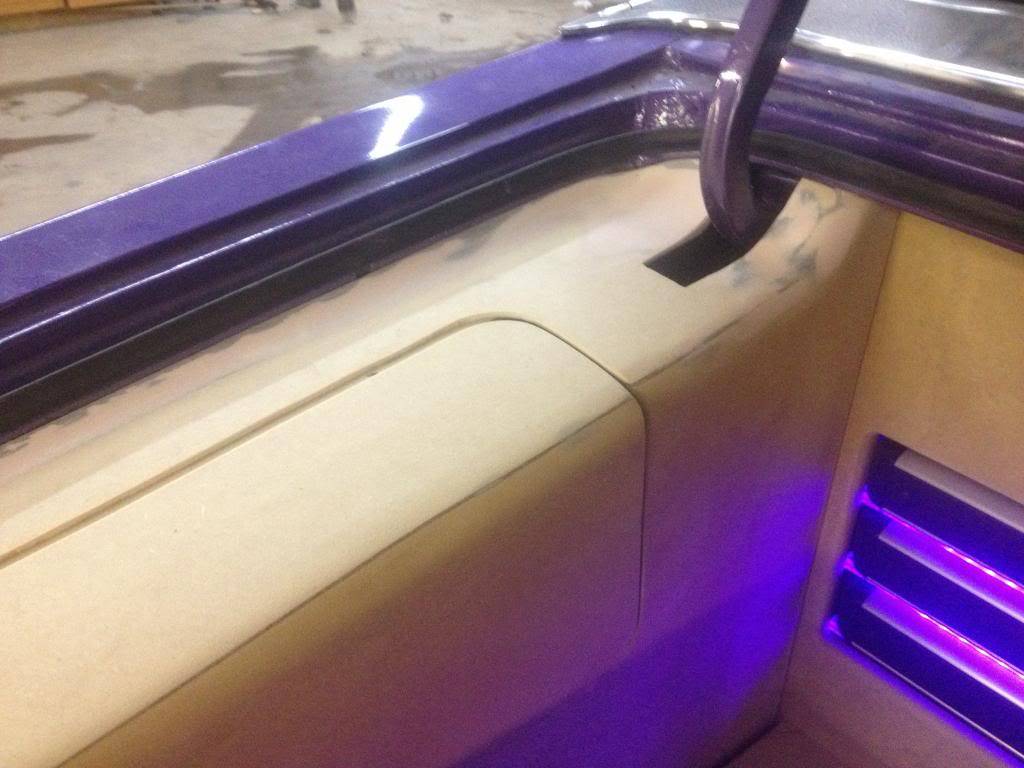

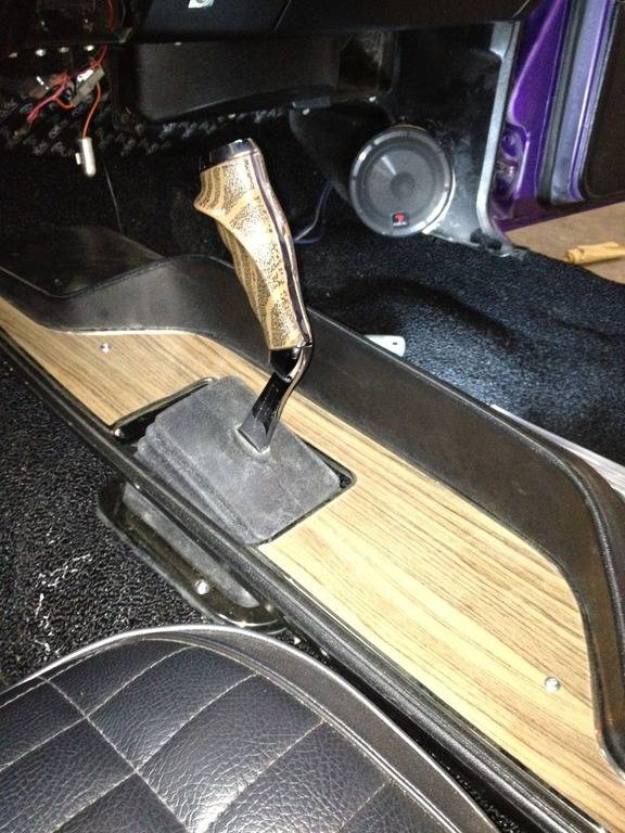

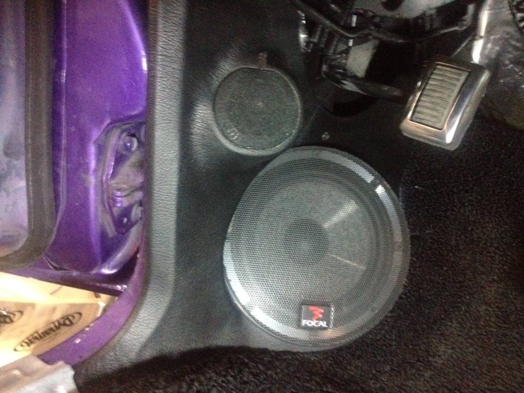

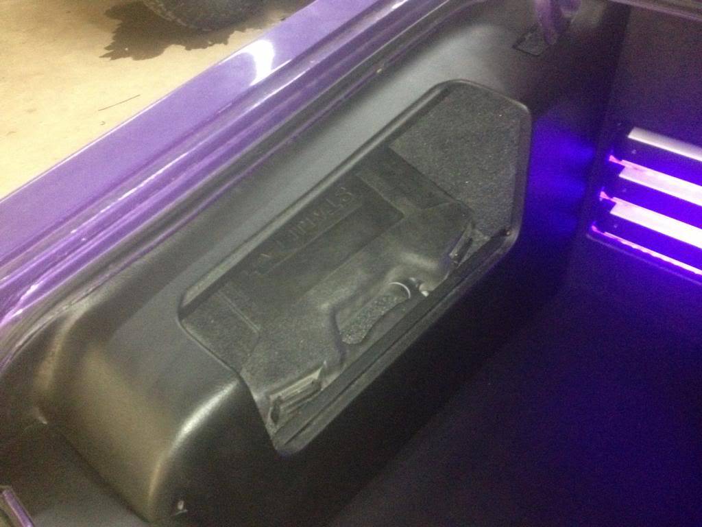

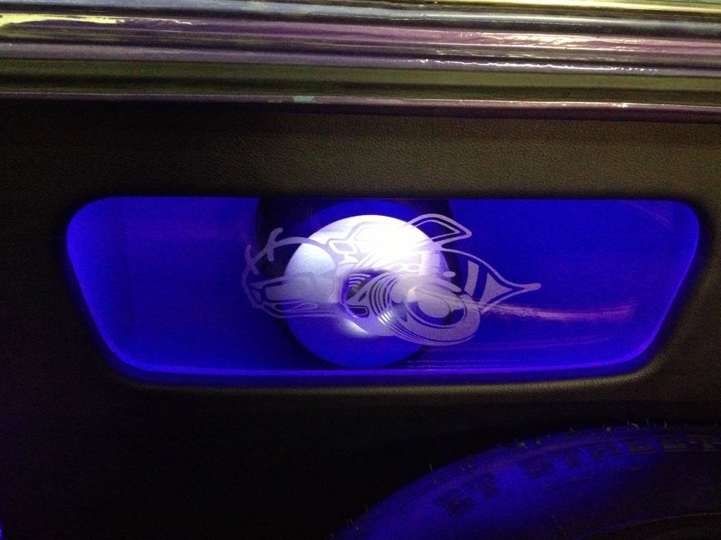

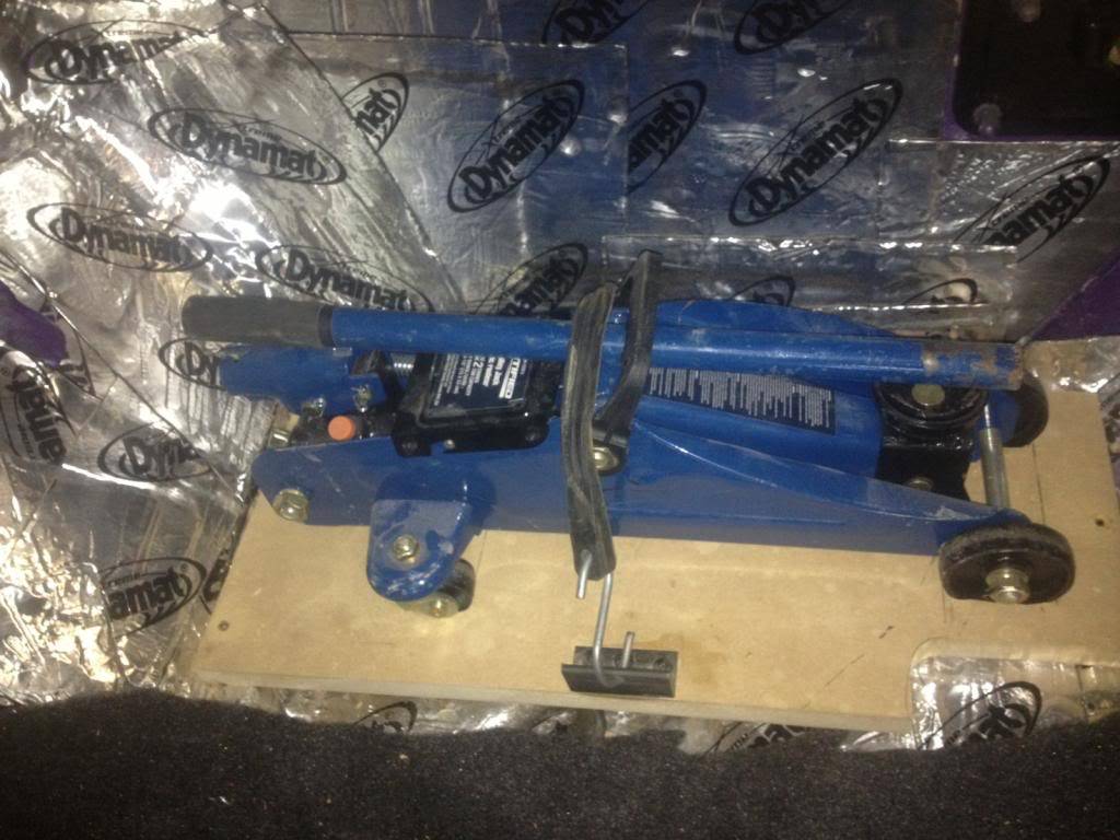

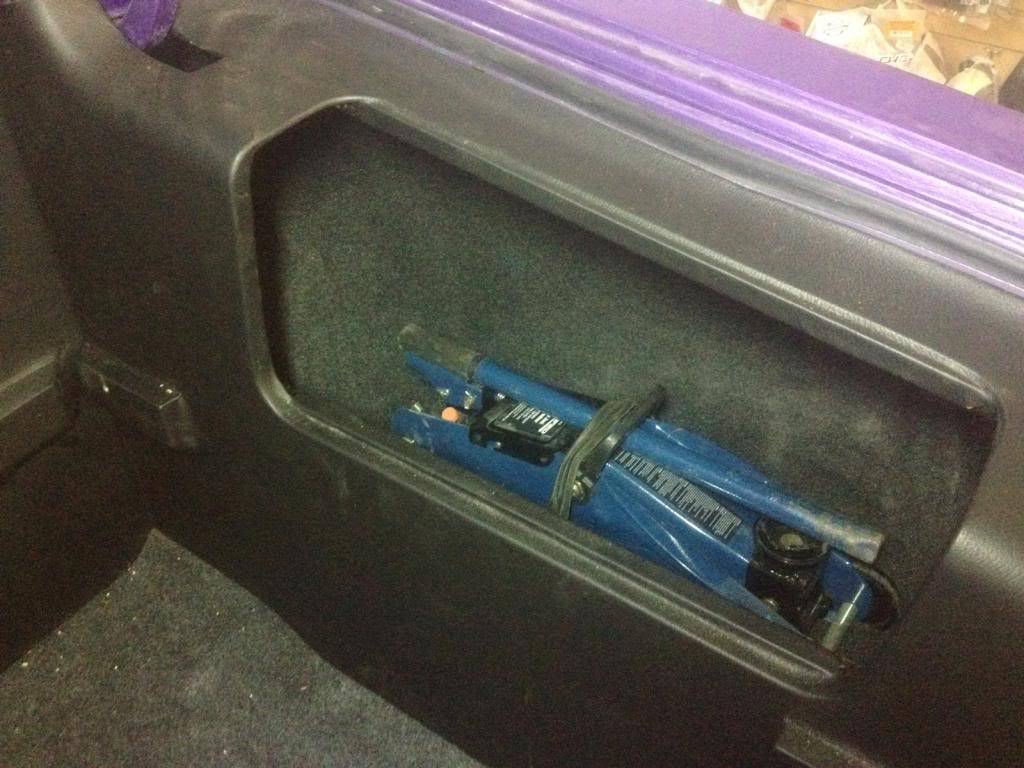

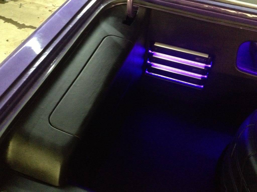

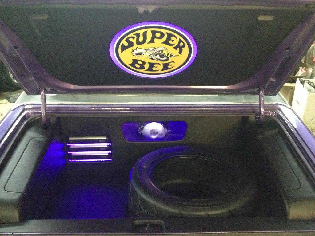

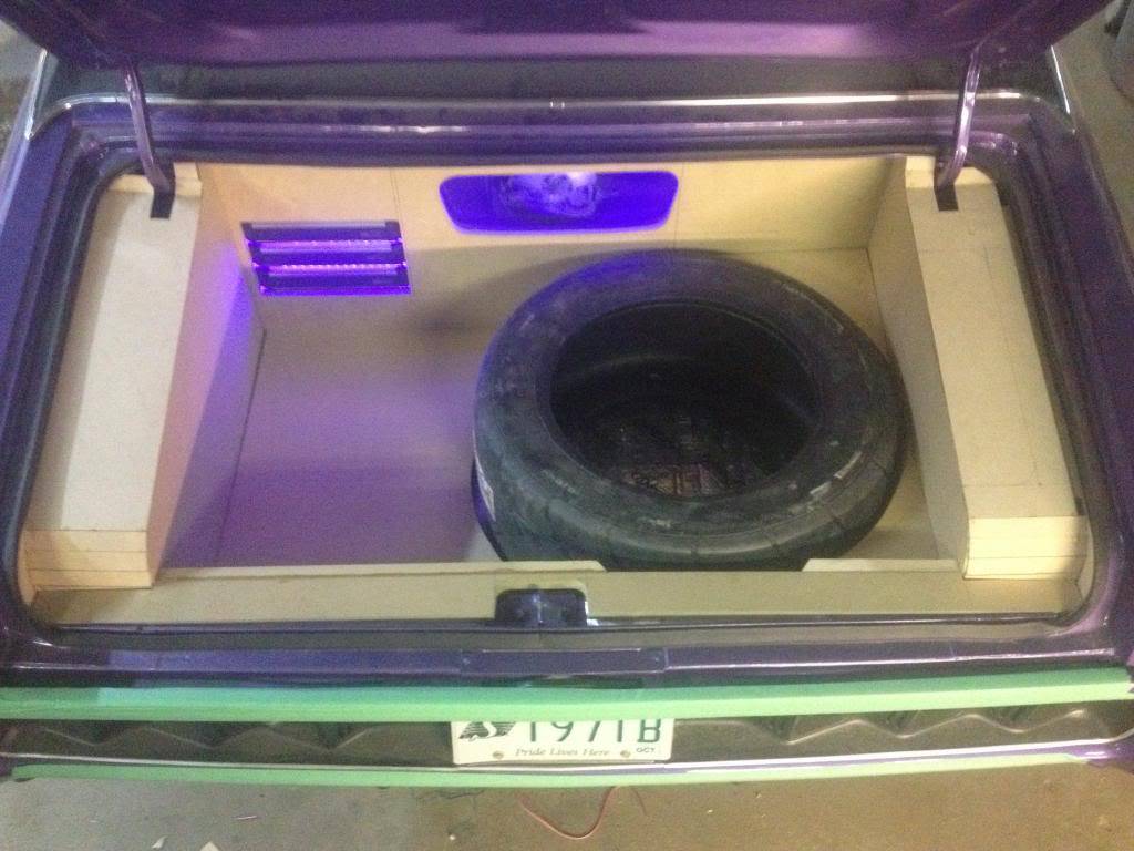

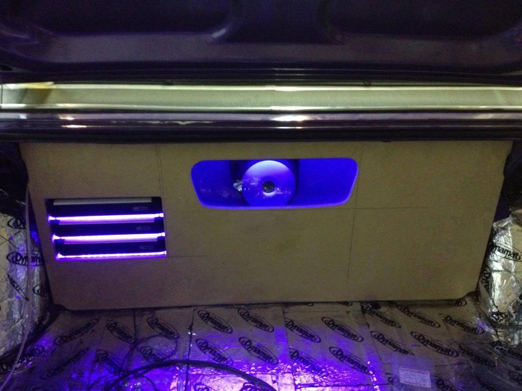

Well The audio is all wrapped up. I know some will think it's just terrible to modify a classic, while others will LOVE it! I like my tunes, so why not cruise in style. The finished product is AWESOME!!!! Photos speak louder than words though!
3 JL Amps With a JBL MS8, JL 12W7, Focal Utopia front end. iPod hids in the console. SOUNDS GREAT!!!!

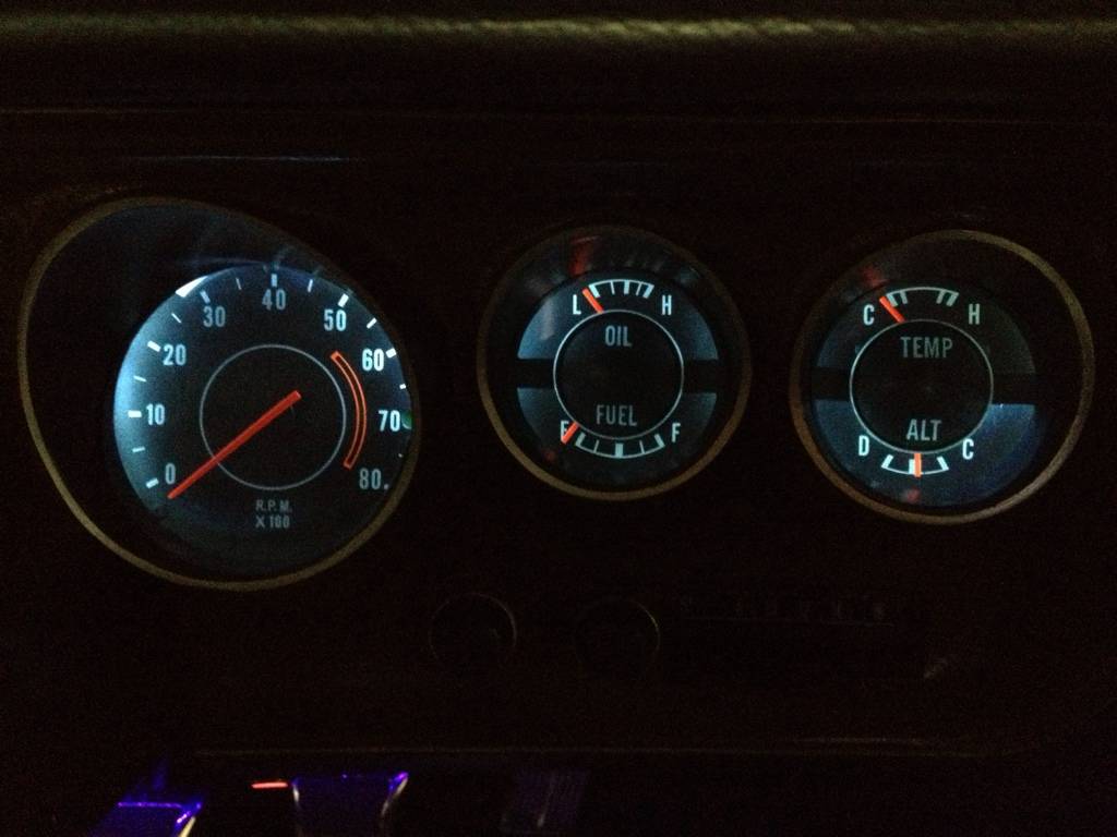

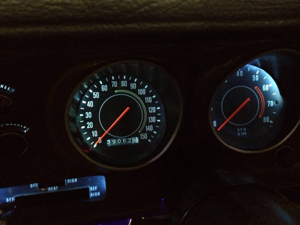

Even LED's in the gauges now too!
I think it looks good, I like my tunes myself but liked the way the original radio looks in the dash and left it that way, my after market radio is on the front of the console, speakers in the kick panels, just 6x9 in the back all is good when i ride, ill bet money yours sounds much better! love that Super Bee decal, Enjoy the ride!

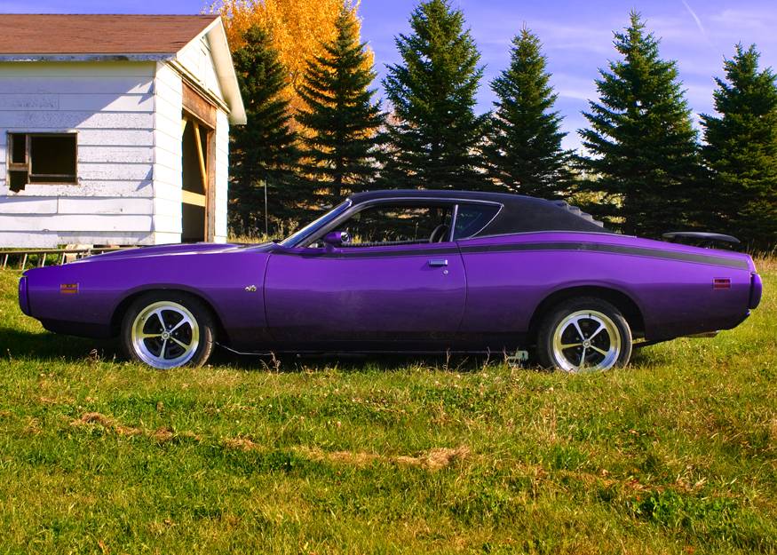

My 71 with 17" Year One Rally Wheels. 17x8 front 255/50R17 Nitto 555 & 17x9 rear 295/45R17 Mickey Thompson. Huge improvement I think. ;) :)
