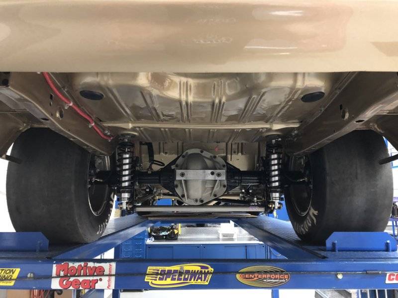

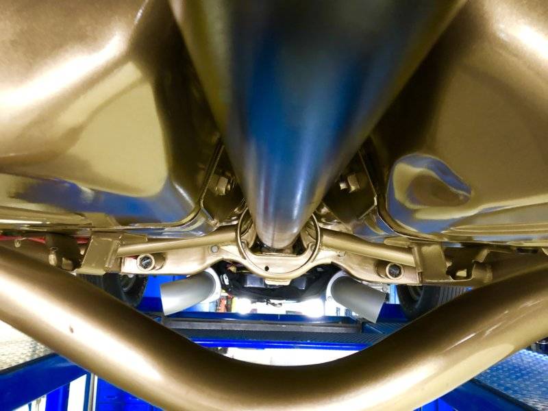

Right after racing season ended last fall I went to work, removed the cal tracs and split monos and installed triple adjustable ladder bars with Strange double adjustable coil overs under the back and that is where we are starting off now. So going into the season and starting all over with a new set up and I'll likely meet up against that red hot Wooks first thing.... Can't even pick on Mr. Gaines now cause he sold the Coronet!

Ladders are set and ready to go. Superstock racer has helped me a lot with the initial set up of these triple adjustables. He's got a load of experience with these exact bars under his cars that run well into the 8's. Very appreciative of Everyone's help, keep it coming!

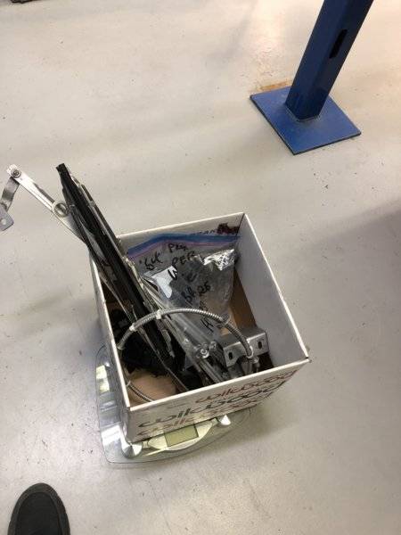

I finally decided to quit hauling the E brake and Wiper system down the track this year. Another 15 lbs gone. The ladder bar set up is also 30 lbs lighter than the previous cal trac set up so old gold is going into 2019 about 40-45 lbs lighter. I also planned on a modest 10lb personal weight reduction for 2019 and only have 15 lbs to go, so that didn't work out - yet.

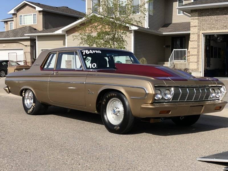

And a lower ride height for 2019. I also picked up rear Super trick rims for the rear over the winter, which will be going on when it's time for new rubber (got 2 sets of Hoosiers to finish off first). Will be switching back to the hemi hood scoop this year asap. Planning on knocking on 9.99's door first though.

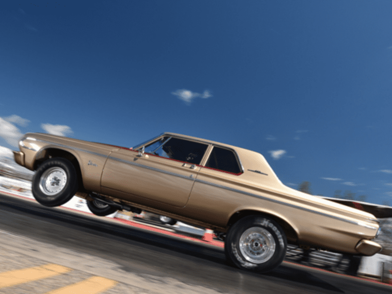

And a shot from last year when old Gold was jumping, throwing the diff out and yanking the rear tires off the ground on launch. Going to be getting out there quicker this year on ladder bars.

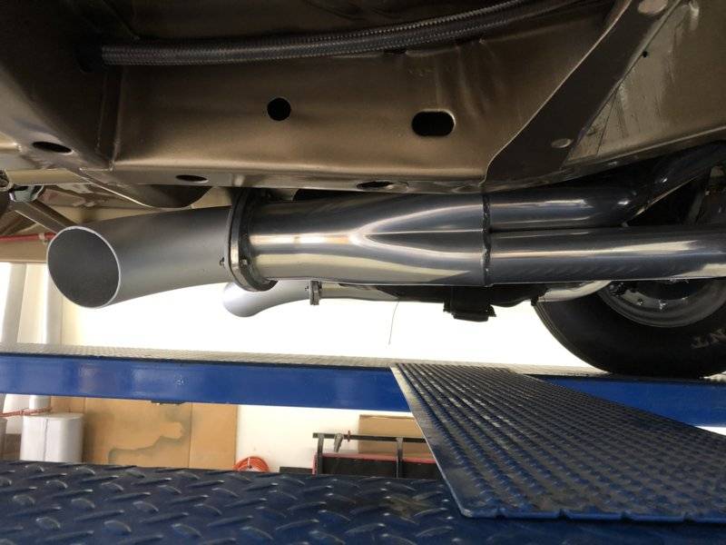

I bet these turnouts look sort of familiar Buddy! They went on a diet today and then on my car.

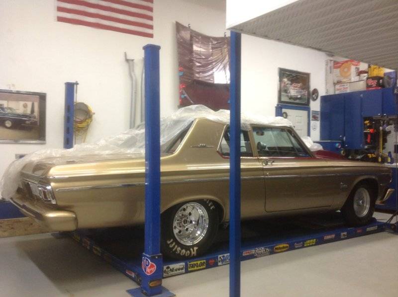

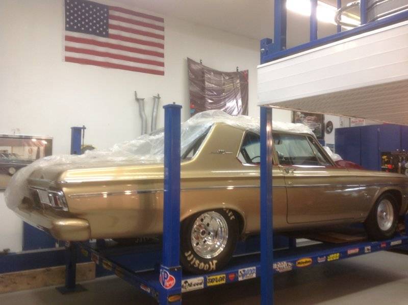

Loaded up Gold Rush yesterday and took it to the weigh scales.
3210 lbs with a full tank of fuel less driver. 3420 with driver and 52.2% front weight.
Raised the rear 3/4" and reset the pinion angle after this shot. The triple adjustable ladder bars sure make it easy to dial things in.
30 lbs lighter than last year, was running 10.12's (end of season). Will see what the new times are this year with the Ladder Bar upgrade and less weight. Chances are that Gold Rush could be getting right on the 10.0 line, and stepping over once would be OK. What I'm after though is consistency, which I never had at all last year.

Just a dumb question from an old guy— why not collector extensions instead of turnouts? It’s been a looong time since I raced, Jeff.
