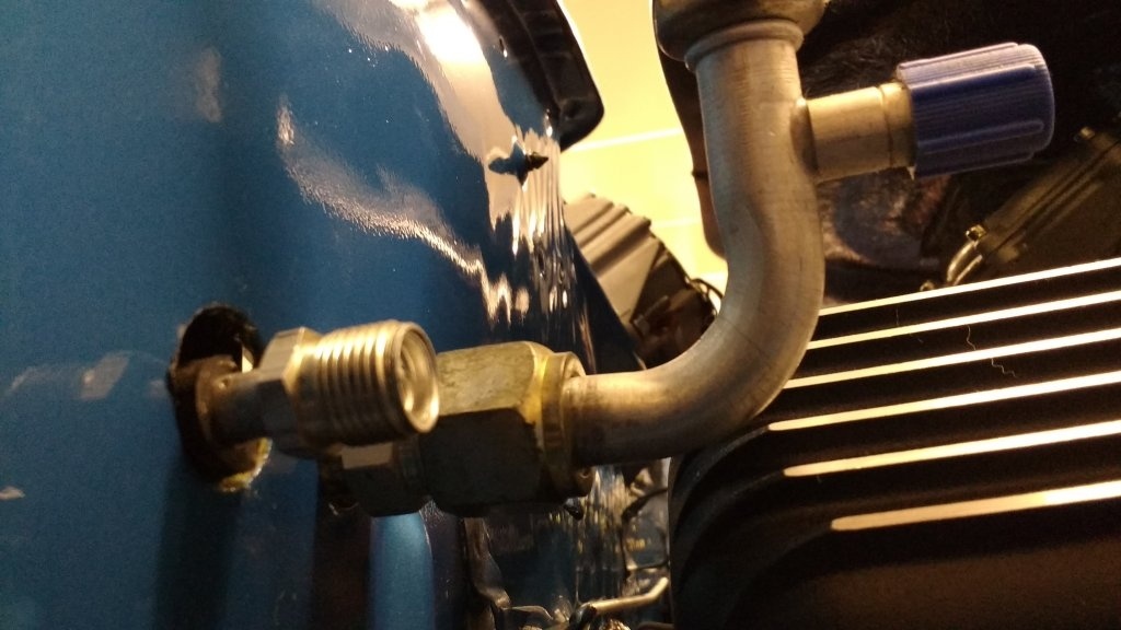

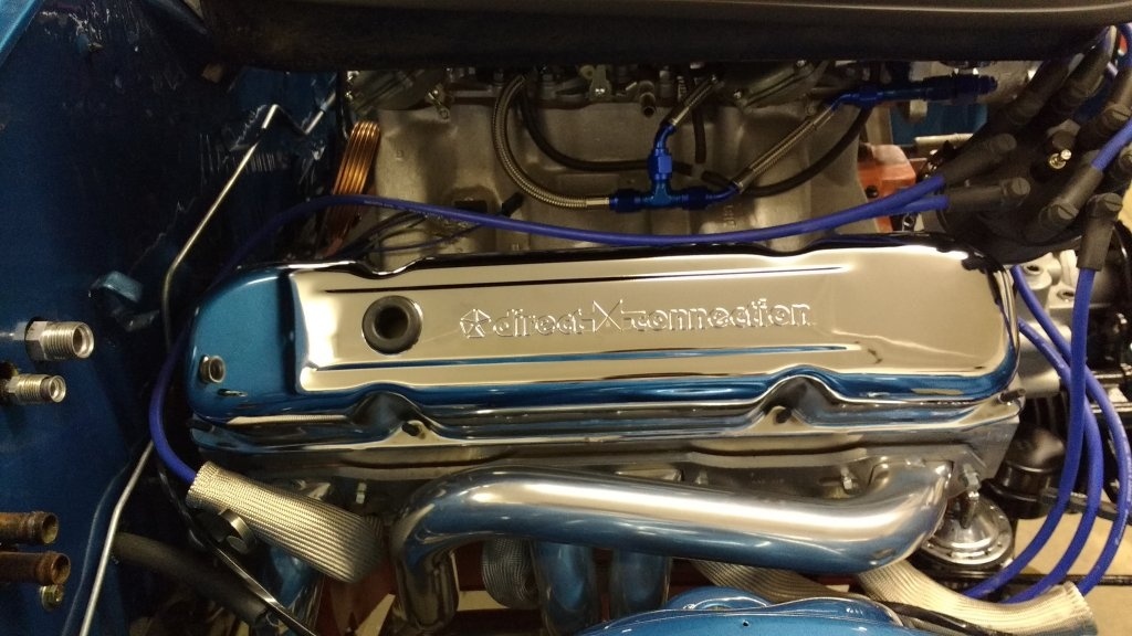

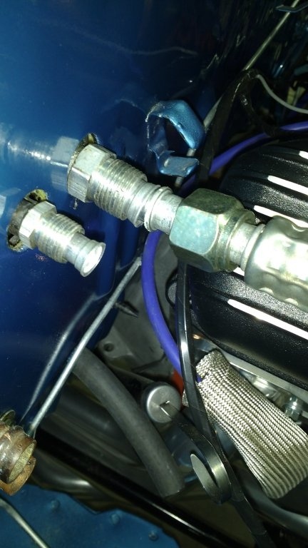

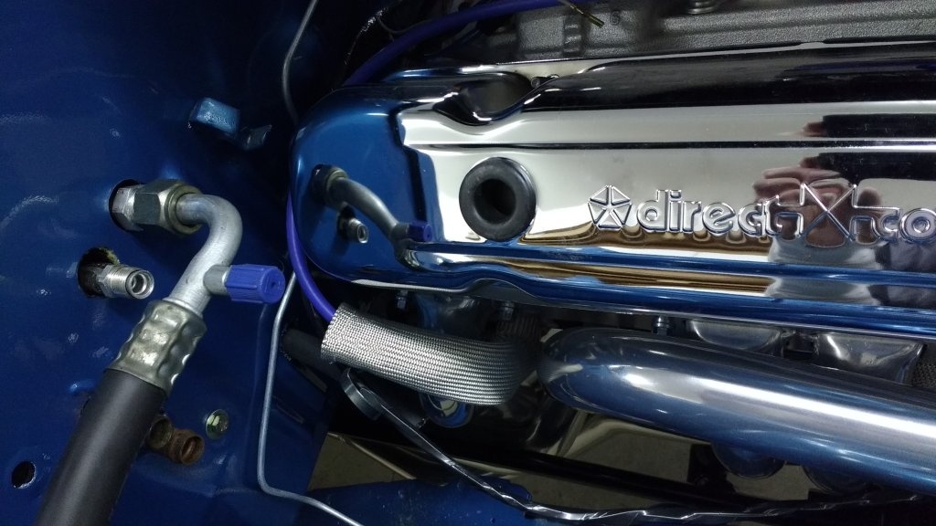

Ok a update for anyone that's going to run trick flows with AC on your car. The heads are about .750 taller. and with the original valve covers Jim had picked out for me I had a clearance problem.
Even with a 90 I couldn't get the valve cover off. I had these DC covers I had originally bought cause I like the old school look, they cleared fine and I can retain the valvecover studs. They cleared without a gasket so I should be fine. I'll roll the motor over to double check where the baffles are just to be sure. I think I'll see if a 45 will clear as that will make my routing of lines neater.
