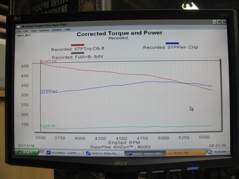

Haven't done anything but fiddle with the fuel mixture and a little bit of timing. This engine is going to run with a 6-bbl so we aren't wasting a bunch of time on these other combinations.
RPM..................Victor TQ/HP..................RPM TQ/HP..................6-pack +/- vs the RPM
3000...................472/269.......................495/283.....+23/+14
3100...................468/276.......................500/295.....+32/+19
3200...................483/294.......................515/314.....+32/+20
3300...................500/314.......................541/340.....+41/+36
3400...................513/332.......................546/354.....+33/+22
3500...................514/342.......................547/364.....+33/+22............574/383....+27/+19
3600...................516/354.......................550/377.....+34/+23............562/383....+12/+5
3700...................510/359.......................552/389.....+42/+30............564/397....+12/+8
3800...................516/373.......................555/401.....+39/+28............561/406......+6/+5
3900...................520/386.......................555/412.....+35/+26............560/416......+5/+4
4000...................528/402.......................558/425.....+30/+23............559/425......+1/+0
4100...................529/413.......................553/431.....+24/+18............557/435......+4/+4
4200...................532/425.......................553/442.....+21/+17............556/445......+3/+3
4300...................539/441.......................548/449.......+9/+8..............548/449........0/0
4400...................545/456.......................552/462.......+7/+6..............551/461.......-1/-1
4500...................550/471.......................554/475.......+4/+4..............552/473.......-2/-2
4600...................554/485.......................553/484........-1/-1...............552/483.......-1/-1
4700...................552/494.......................550/492........-2/-2...............554/496......+4/+4
4800...................562/513.......................558/510........-4/-3...............553/505.......-5/-5
4900...................560/522.......................556/518........-4/-4...............553/516.......-3/-2
5000...................562/535.......................552/526.......-10/-9..............556/529......+4/+3
5100...................561/545.......................558/542........-3/-3...............560/544......+2/+2
5200...................551/546.......................556/550........-5/-4...............556/550........0/0
5300...................554/559.......................548/553........-6/-6...............552/557......+4/+4
5400...................546/561.......................546/561.........0/0................555/570.......+9/+9
5500...................549/575.......................544/570........-5/-5...............552/578......+8/+8
5600...................541/576.......................532/568........-9/-8...............544/580....+12/+12
5700...................539/585.......................530/575........-9/-10.............534/579......+4/+4
5800...................534/590.......................517/571......-17/-19.............528/583.....+11/+12
5900...................526/591.......................508/570......-18/-21.............524/589.....+16/+19
6000...................512/584.......................497/568......-15/-16.............511/583.....+14/15
6100...................503/585.......................480/558......-23/-27.............502/583.....+22/+25
Me, I think I'll run the dual plane.................
So, next up is the 6-bbl. Unfortunately the 6-bbl fuel lines are a sprinkler system right now.............ooh, ooh, pick me, I'll fix it.
