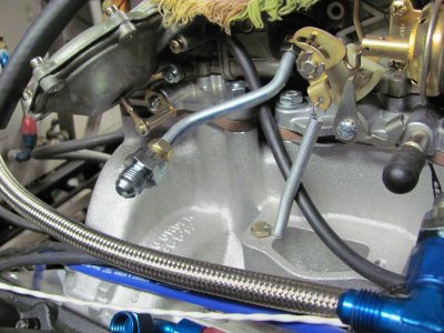

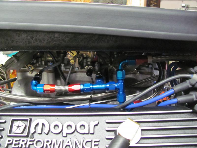

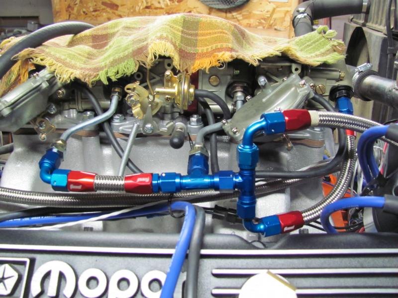

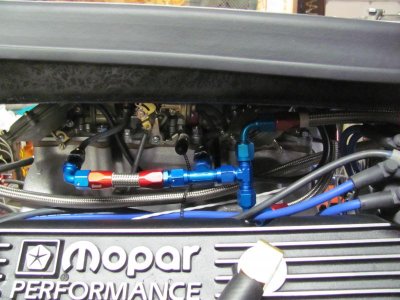

The 6bbl isn't ready to fire, I've got gasoline leaking everywhere. Got some parts on order to stop the leaks and make things easier to disassemble and tune.
Sorry Jim! I should of bought the Pro Maxx fuel line set up, I went back and forth on which one to get. I picked the wrong one I guess.
440Beep It's the 71 440+6 carbs I bought new from Jegs along with the intake ect. I had Jim port the intake because I had heard they could benefit from some port work. I added the Pro Maxx rear throttle plate with angled idle mixture screw. Also Quick Fuel metering plate with some extra emulsion circuits for more tuning. And lastly I add phenolic spacers to help with heat sink & vapor lock. Jim will have to share the mods after that. I'm guessing it'll be later in the week before Jim gets back to it. So be patient Jim will let us know the progress. Good things come to those that can wait.
68 Hemi GTS I hope it will run as good as your 69 RR.
My son Cody is 42 yrs old and can't tighten the inverted flare fittings on the fuel line enough to keep them from leaking. He has run from his house in Challis to the top of Hwy 93's Willow Creek Summit (25 miles). He won his age group in a 50km run through mountains. He will hike 7 miles into the mountains with a 60lb pack, load on 35lbs of elk antlers and hike back out the same day. He'll shuffle engine blocks around in the shop by himself.
I...ain't...messing...with...those...fuel...lines.
Check the flare for a crack or if it was not centred when rolled over
Is this a factory flare or one you guys did
Thank you for the suggestion, these things I already understand. One leak....then I'm lookin' hard for the problem. Seven leaks.....I'm goin' with sumpthin' else. Factory flares, my flares don't leak.
New flared lines from the rear and center carburetors, -6 AN the rest of the way. First hit on the fuel pump and no leaks.
