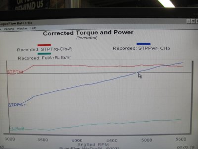

Torque Curve?
3 grand to 5,500 rpm.........

Is this with the 6pack??

If I had to guess I'd say there's less than 25 ft lbs difference between 3400 & 5500

Is the bottom blue line fuel ratio? Getting lean at higher rpms?
Yes Bad Bee, 6 bbl is on.

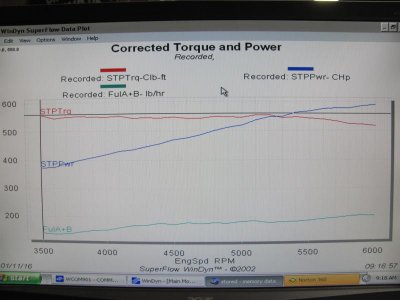

That is fuel flow not a/f ratio. Still rich on the bottom. 533 lb-ft @ 3,300 and 536 lb-ft @ 5,700. The 6-pack is getting better average torque and horsepower from 3,000-6,000 than the Victor or the RPM. 553 peak torque and 582 horsepower.
I gotta get in touch with SuperFlow. Miserable computer/dyno is still printing the date and time wrong ever since the first of the year. If I shut down for awhile it restarts at 1/1/16. This really was a run from yesterday afternoon.

So looks like the 6 bbl will be the best of both worlds. Better bottom end tq & I'll bet buy the time you get done, close to 590 hp. In the words of Hannibal from A-TEAM, " I love it when a plan comes together"!

Man I would sure like to have 8 more HP for bragging rights, but I'm not going to kid you, I said in the beginning I was shooting for 550 hp and anything above that was gravy. Well I got gravy, ice cream, & a cherry on top!!!!

I have never seen a torque curve like that. The motor just don't care what rpm it's at.
