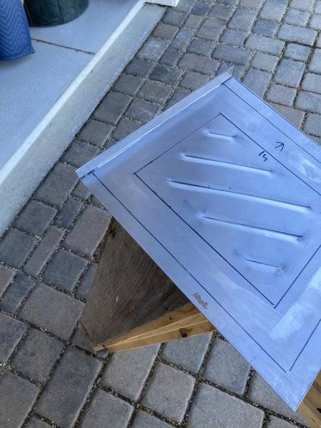

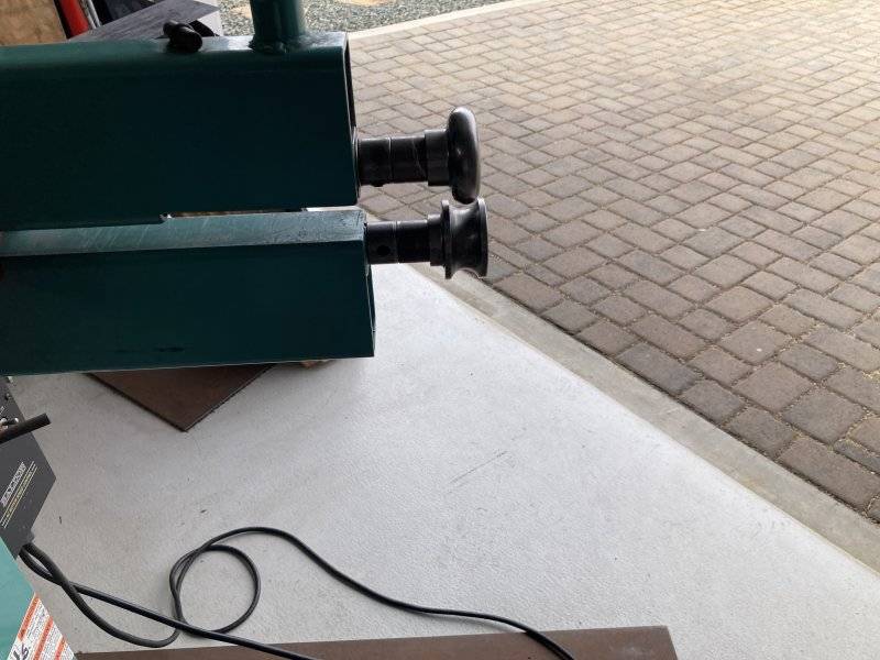

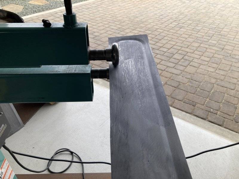

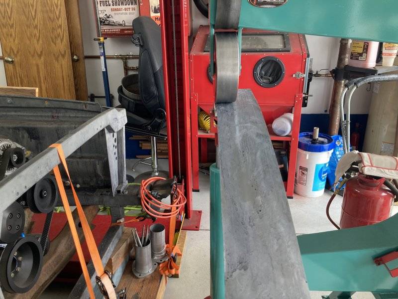

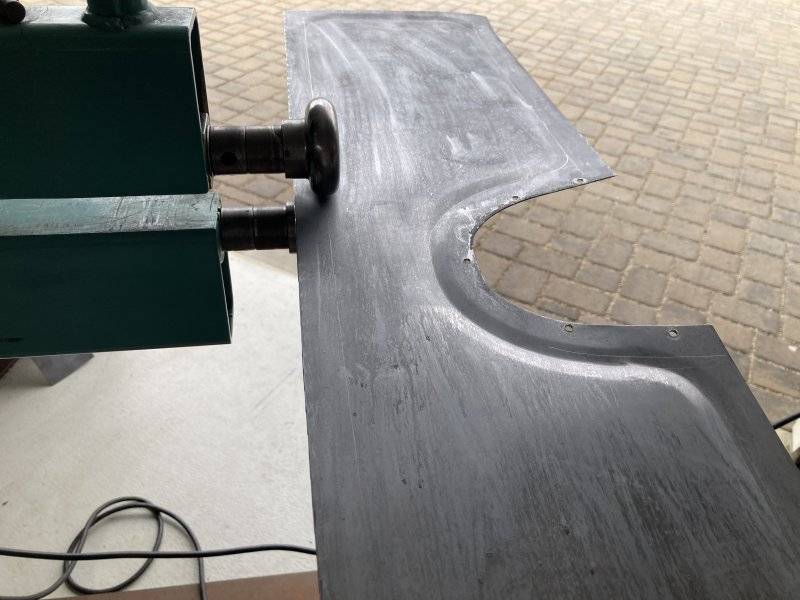

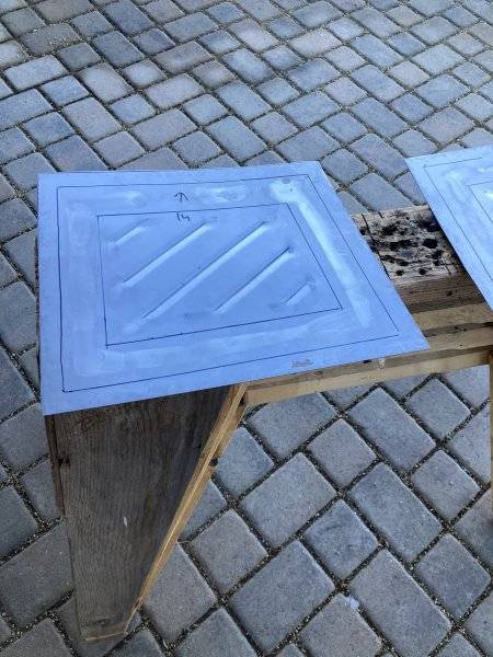

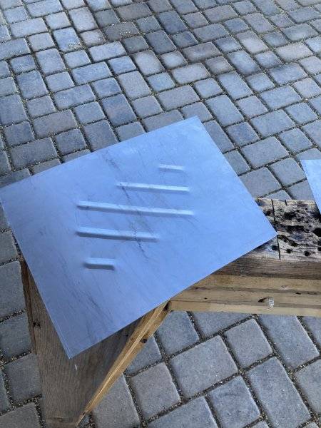

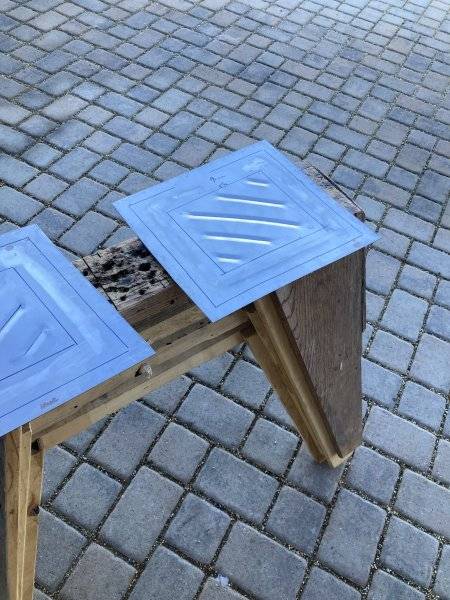

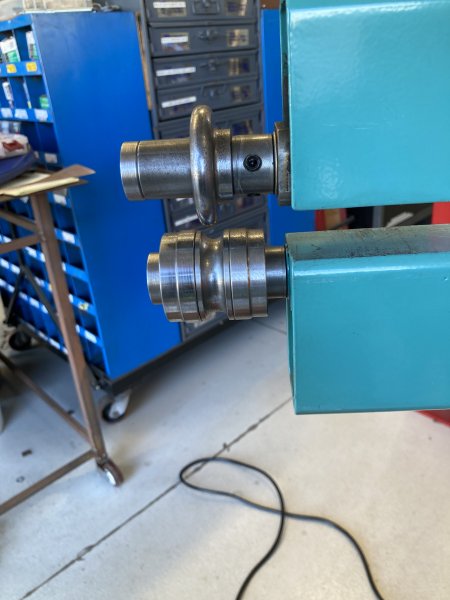

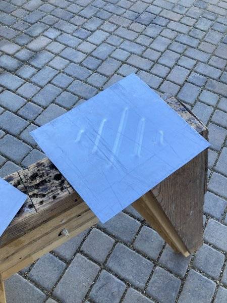

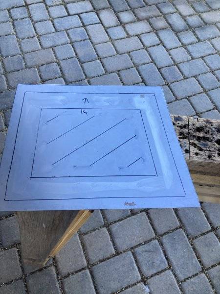

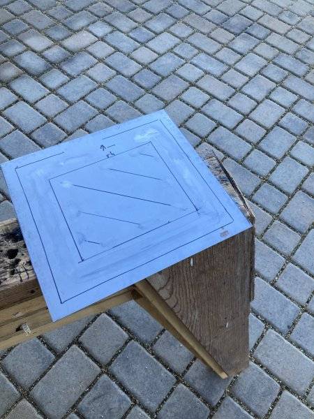

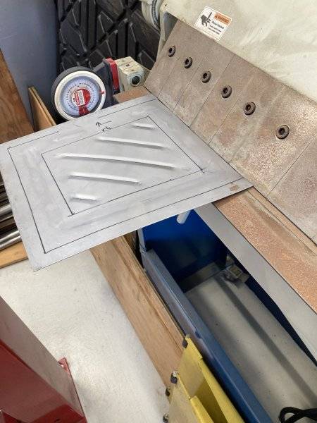

Today I ran the two pieces through the English wheel first for a little pre stretch of the target areas then ran them through the bead roller.
You sure have a lot of tools.Today I ran the two pieces through the English wheel first for a little pre stretch of the target areas then ran them through the bead roller.

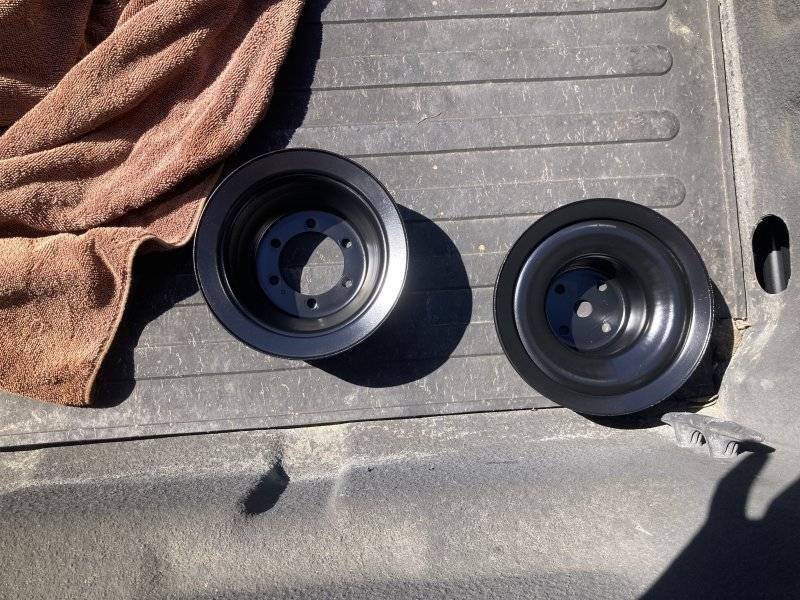

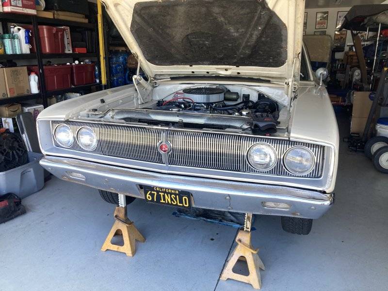

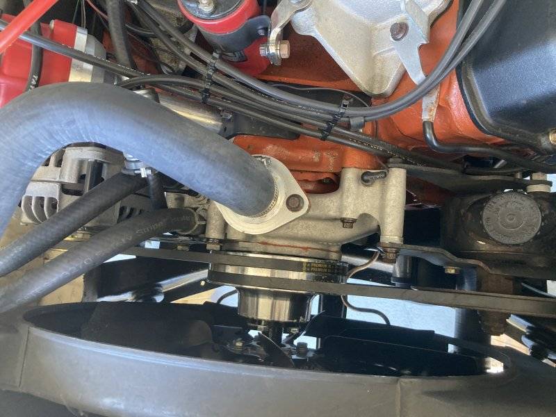

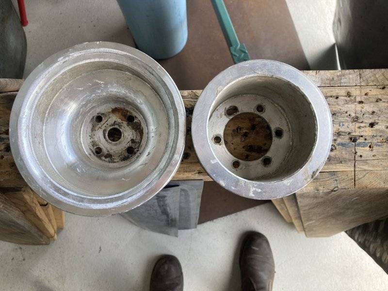

A bit of a deviation on the car. I'm going on the Power Tour West next month with my friend Darren. We were going to take his 46 Ford truck, but there are too many issues to get it ready so I offered up the wagon as backup. Getting the 67 serviced and checked before we roll. Up in the air for inspection and oil change. I got a pair of pullies from Vanessa at 5 Pointsparts in Oregon. Great gal to work with btw for finding goodies. Anyway, the pullies are getting switched out as the two on there under drive the water pump by a fairly large amount. Crank is 5.25", pump is 6.75". A 1.5" difference. That should help with the cooling! Blasted them a couple days ago, hit them with Ospho then paint once they were dry. Got the shroud out, fan/clutch etc. Started bolting the crank pulley down, got 5 bolts in but not the 6th. Then I remembered about the non symmetrical bolt pattern. So stopped for the day and I'll resume tomorrow.
Cool, just glad to see it worked ok.. makes me feel better. Would still prefer a steel one and peace of mind thoughFor you Greg, yes I have a lot of tools/equipment in my garage. But of course there are more I would love to have. On that stuff, I have access to them and do trades for usage. And many times I improvise with what I have available. Like that piece of EMT.
Icetech, there was hardly anything sticking out of that pulley to align the fan/clutch. There was just a bare minimum. All better now.

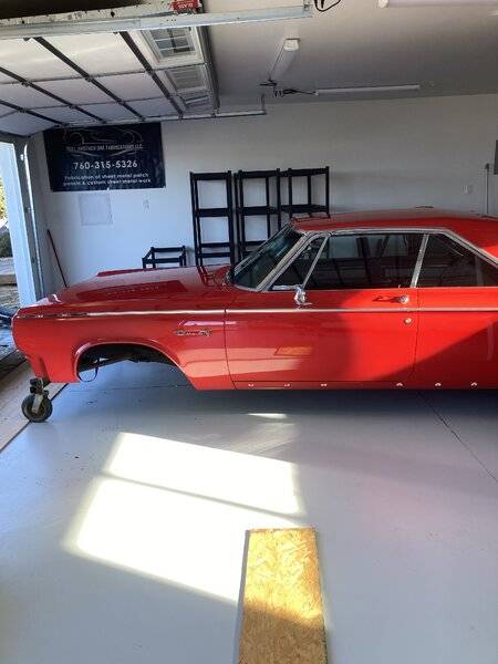

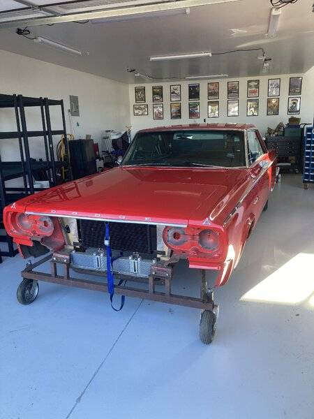

Looks to be a nice garage & some more panels on the car too boot...Just some updates to keep this current. My garage is built, still have a couple of tasks to do for the final inspection sign off. At least for now the car is in the new garage and out of the elements. Later this year I can hopefully get back on it. For the garage, see my thread "lessons in patience to me" in the garage section.

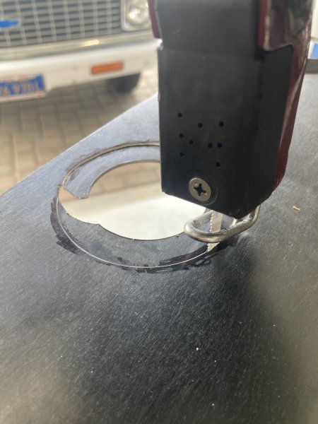

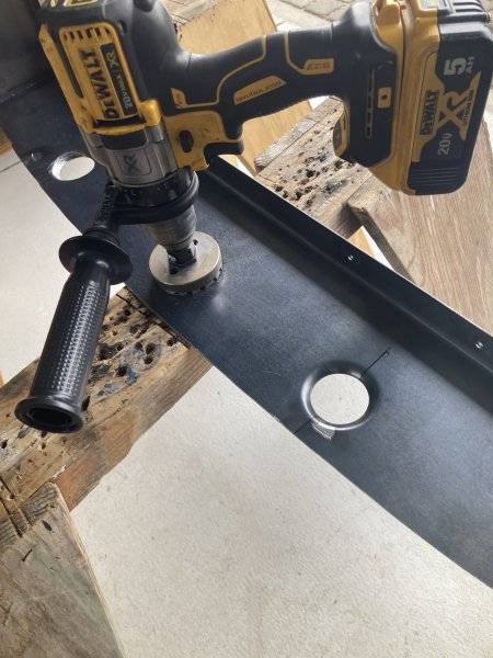

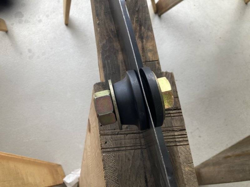

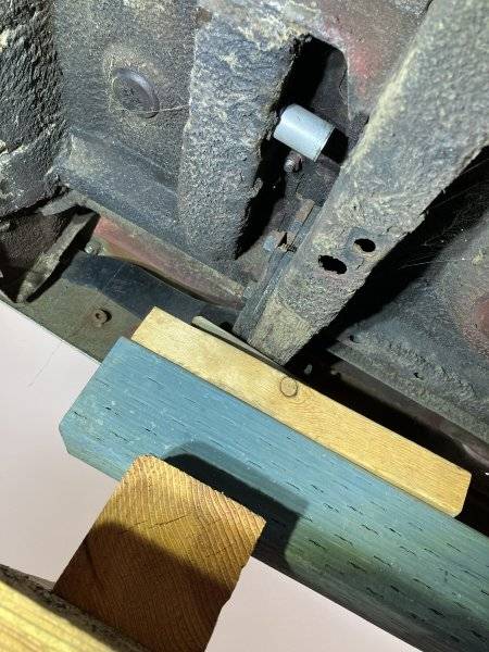

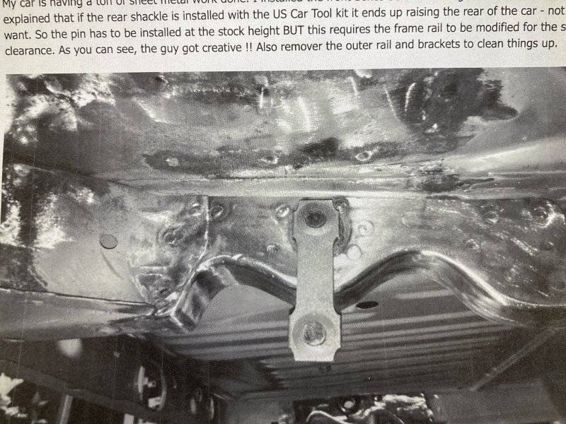

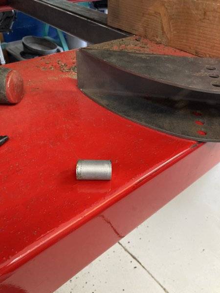

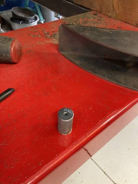

That looks greatSome more progress from yesterday. I was working on a 1" wood dowel to use as my drill guide for the rear shackles. Called a friend of mine, actually who owned the car before I bought it from another gent, to see if his wood lathe was able to put a 1/8" hole in the center of the dowel. He said no but asked what I was trying to do. He ended up having a 1" dia metal spacer from some other project in his spares box, he holds on to stuff like that too as do I. So got that from him and I can slide that in a fair amount into the old shackle tube from the fuel tank side. 1/4 panel side didn't want to cooperate. From there I glued some flat washers on both sides of the spacer to use as my drill guide. With the spacer in place I'll be able to go through the walls of the rail with a pilot hole enabling me to come in from the tank side with my Rota Broach cutter to cut through both walls. I cut a couple of tubing sleeves to weld in for the new mount. The USCT pack came with new shackle mounts but they will make the car sit higher which I don't want. Another one of the FBBO bros did the USCT pack on his 66/7 and ran into the same situation. His remedy was to do what's in the fourth picture.

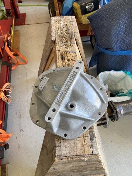

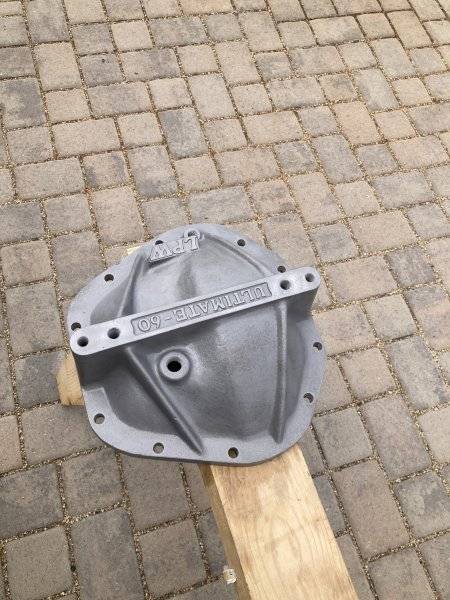

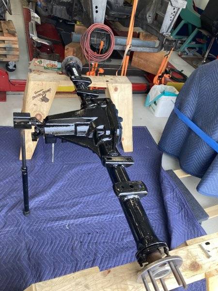

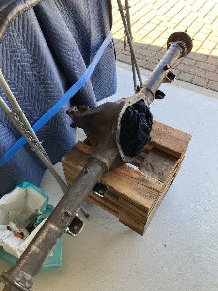

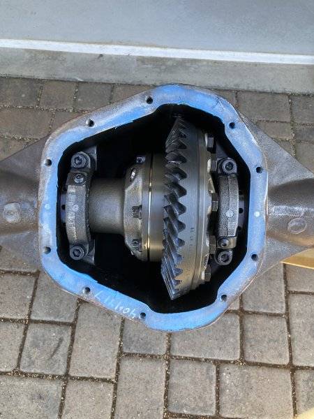

Looks good 1/2 way thru, still reading your posts...Yesterday I was able to finish scrubbing off any of the rust that could be gotten at without full disassembly of the unit. I took the wheel bolts[ these screw into the axle flange] out, used a hamburger wheel on the axle flange to clean off rust so when the rotor goes on, it's flat. Cleaned the threads of the bolts, put them back in with some red loctits. Removed the cover, cleaned off the sealing surfaces, blasted the cover, cleaned it off then coated it with Sharkhide for protection. Today I'm painting the diff with POR15.

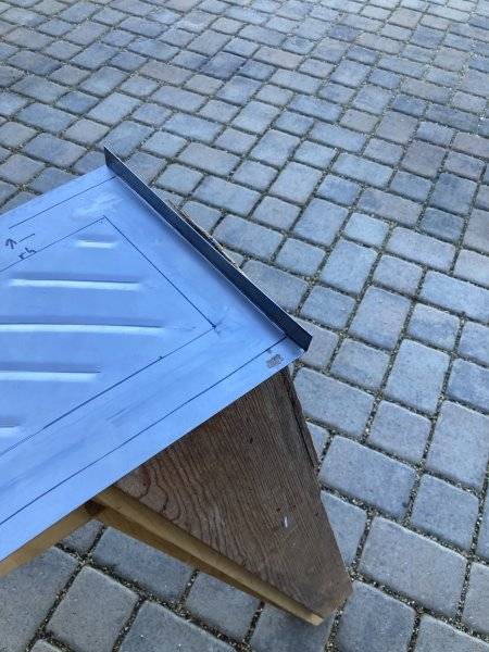

I like the bead rolling detailsToday I'm forming up the panels and fitting them to the car.

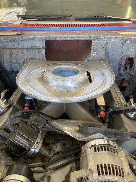

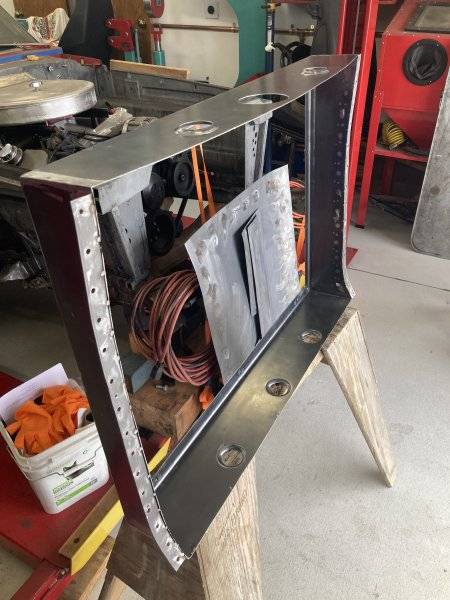

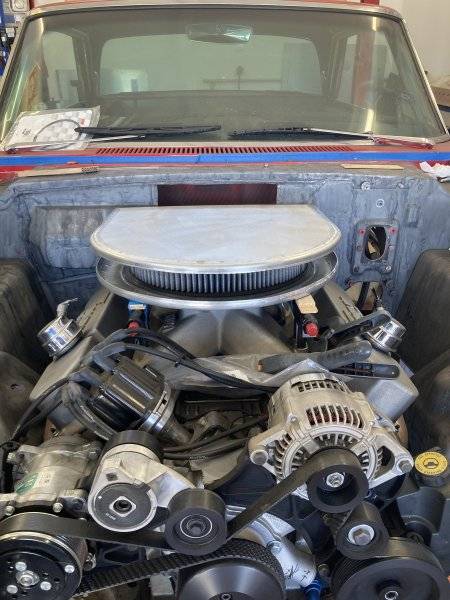

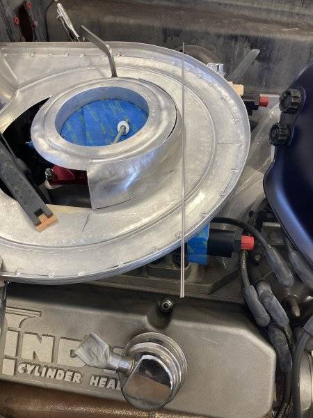

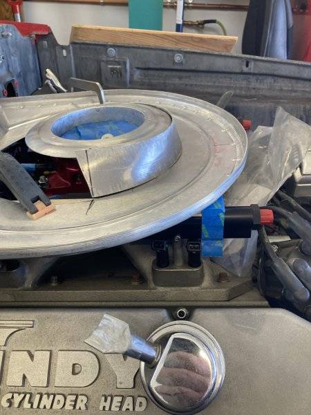

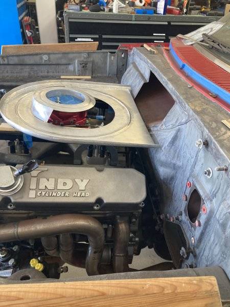

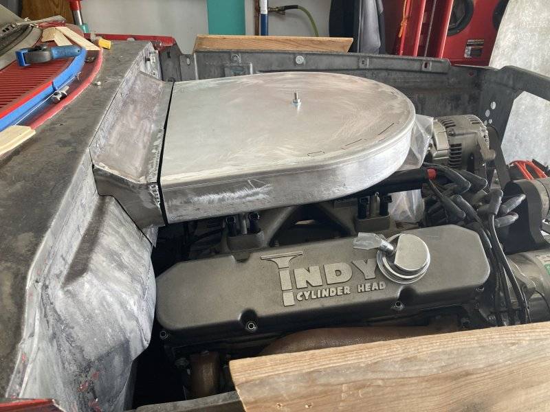

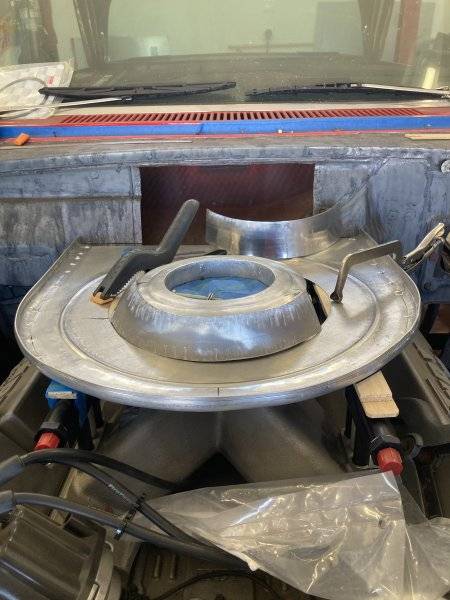

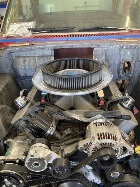

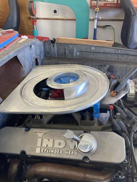

A ton of work in that Air-cleaner housingLast week I was only able to cut out and work another filler piece. My working on the car was postponed as we needed to get Rheemed. Not to be confused with reamed. LOL! In English I needed to replace our water heater. The GE unit would not stay lit, but hey, it was 12 years old. So got a new unit from Depot. The house looks like 2 story but its on a perimeter foundation with stilts and cross braces underneath in the "crawl space" which is 12' high on the north end and about 6' on the south. The access hole to the space is 26"x36", so a neighbor helped me get the new unit through the hole. All good now, have nice hot water. Man I forgot how heavy a full unit plus sediment etc can weigh. I let it drain out under the house onto the sand, we're on a massive sand dune out here and the next time its yard/garage cleanup day with the trash company, I'll drag it out from under the house. For now its out of the way.

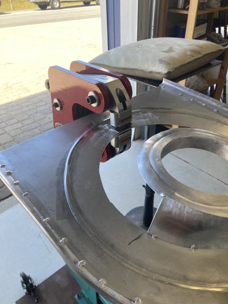

Today I worked on the new filler piece, 3rd times the charm and got it to where I could get it tacked. After I got it tacked I noticed it had some oil can going so I put it in the shrinker and tightened it up. Next go around will be making the back filler piece/pieces. After that I'll get the vertical filler tacked on and from there start working on the firewall ducting.
He coulda just went with this and some foil tape (fancier than duct tape) but he had to show off...A ton of work in that Air-cleaner housing![]()

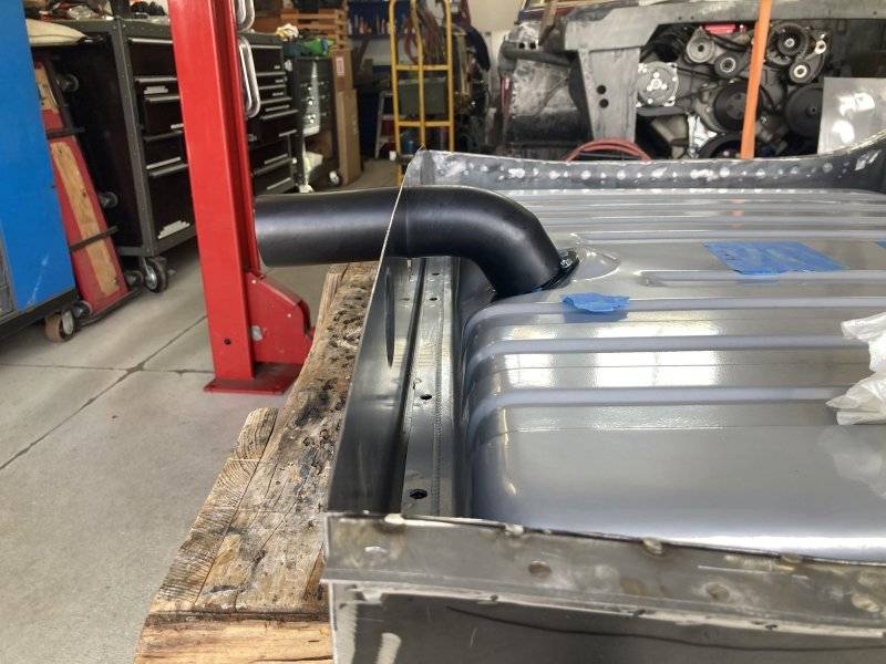

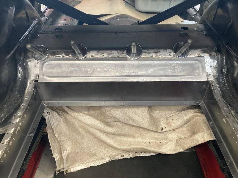

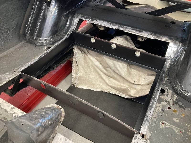

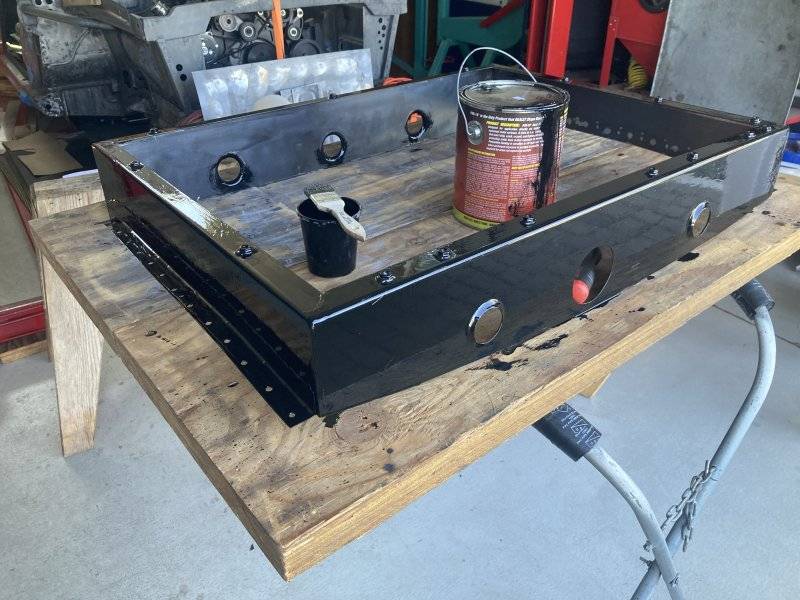

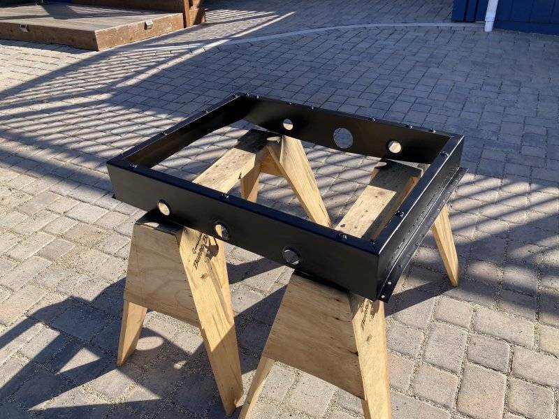

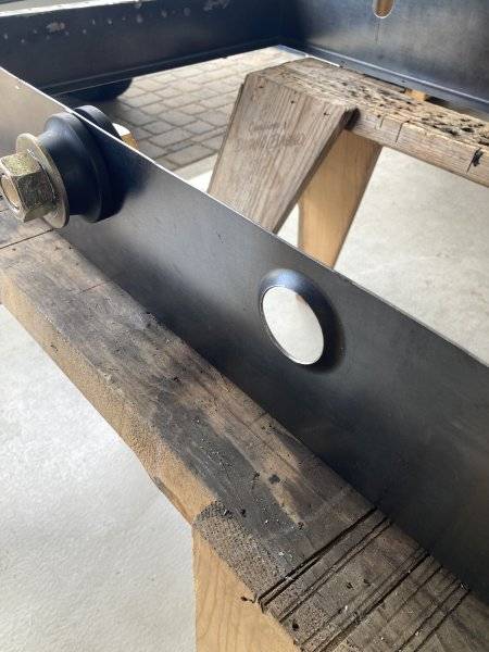

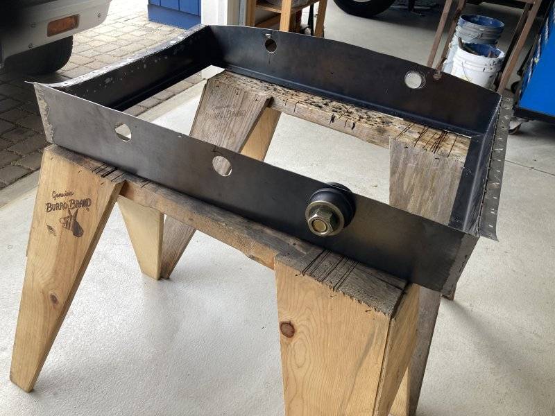

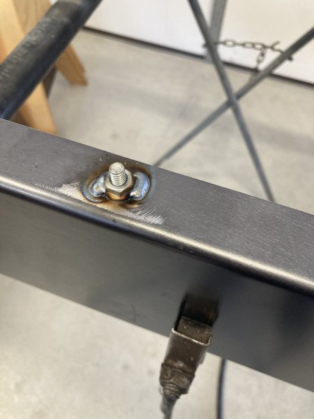

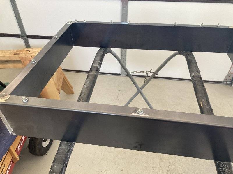

Looks "Marvelous"Today I marked out where the holes needed to be to bolt the tank to the nest. Drilled them out, ground off the burrs, ground the welds in the inner corners. Rustled up 15 1/4" bolts, got the flange nuts on, welded the nuts to the nest. Also here is a picture of the somewhat finished filter unit.
