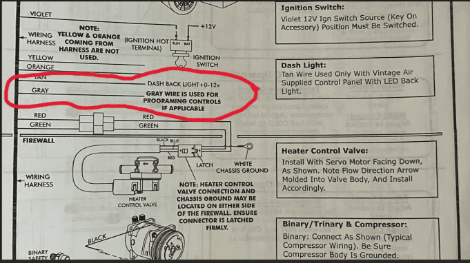

A quick search and... https://www.vintageair.com/instructions_pdf/909950.pdf
the controller I just shipped has a mini set of instructions for its installation included in the box.I'll bet it doesn't state it in the instructions that I have.

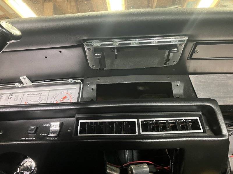

Actually no... When you install the new system you block the fresh air inlet... From that point on you only have recirculated air...it helps clear the windows
Running the A/C through the defrost vent works but not as well as fresh air... One of the reasons on a factory A/C car I tend to keep the stock under dash components & replace the stuff under the hood...
Yeah, it still works.. Just never been a fan of eliminating the fresh air option..

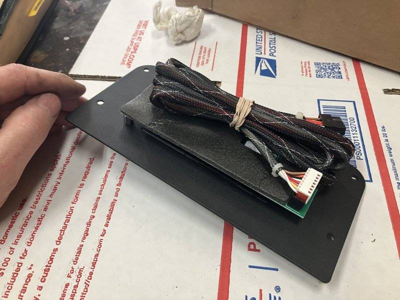

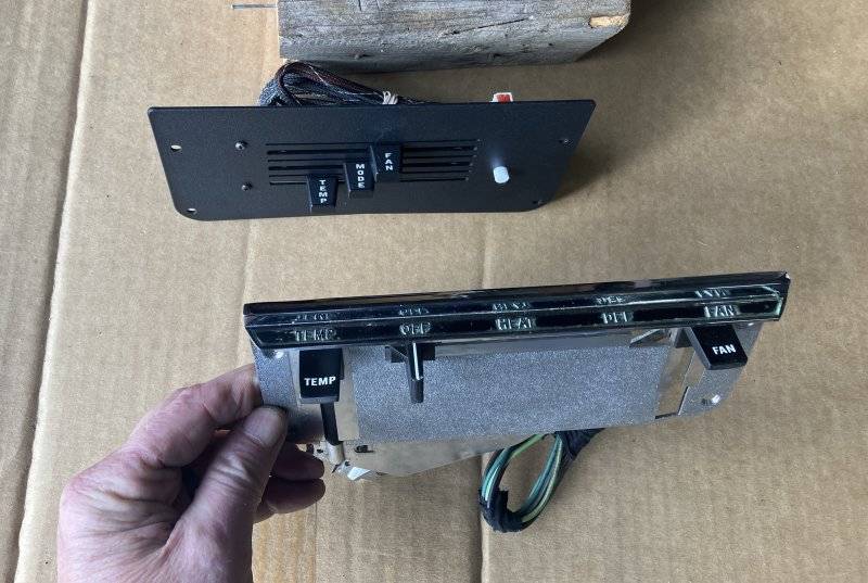

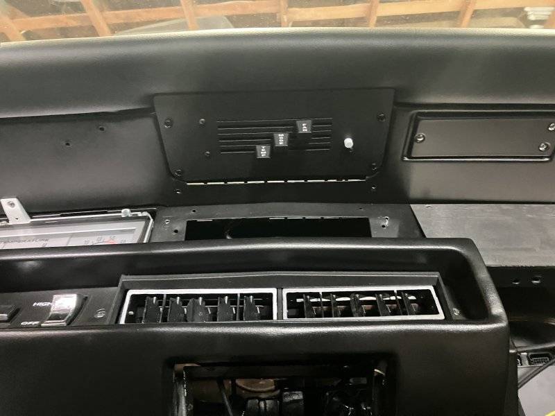

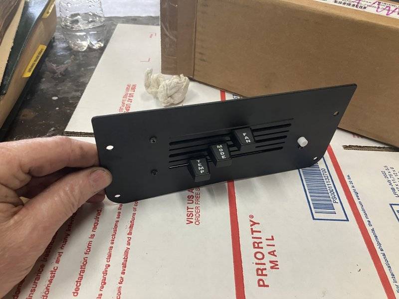

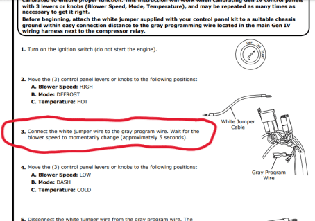

I’m assuming this is only for the control knobs. I didn’t program anything for my 70 Charger and it works perfect. Whatever you guys decide to do, y’all are doing a good job. We can all agree to disagree but I’m sure the end product will be nice and everybody that’s involved will be happy.Well, this is all news to me.
No problem, just nothing I've seen until now.
Like other things, I didn't know what I didn't know.
Why should the installer even have to do this? The Classic setup didn't require it.
