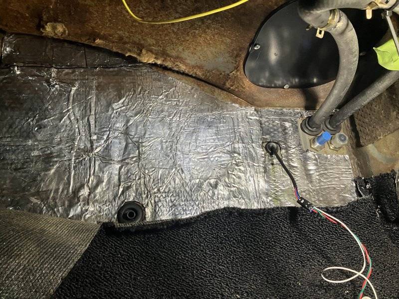

They say you don’t have to cover every square inch with this stuff but..
I covered the firewall.
I’m up to the cowl, which had me curious…. Is there any benefit from putting this stuff on the underside of the cowl?
I’d need to know before the evaporator goes back in. It is much easier now.

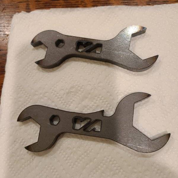

Check out these wrenches from Vintage air. Definitely no room at the evaporator. Don't know if it was an option for your install but Vintage sells an evap hard line kit for the E body sure fit package. All lines protrude through the fire wall and are connected on the other side. Search Results - Vintage Air
Those wrenches may work for someone with smaller hands and more flexibility.
My hands are a bit over average size and I don't bend as well as I used to. I'm not arthritic but I can't bend like rubber in strange positions. The heater hoses will be reasonably easy to hook up since they aim parallel with the firewall.
Secondly, The "E-Body hard line kit" may work for a 71-74 B body but I suspect the 66-70 B is a bit different.
Did I misunderstand you?

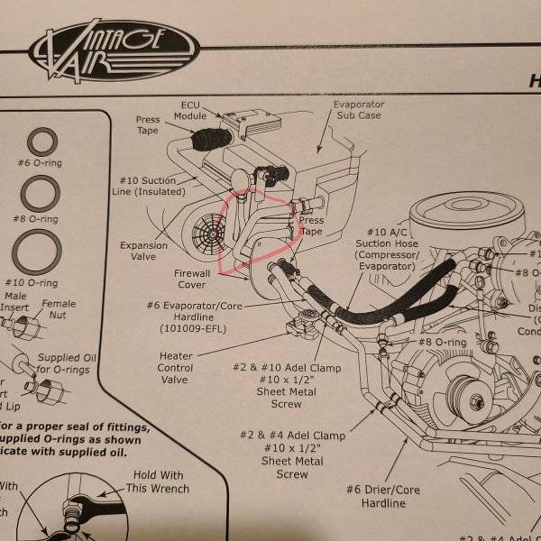

on the phone with Vintage Air several months ago the tech told me the under dash evaporator lines are rigid for the heater lines and rubber for the A/C lines (the opposite of what is under hood with rigid A/C lines and rubber heater lines. Not sure why). From your snapshot above, does this mean if you use the Evaporator hard line kit that all 4 under dash lines are now hard lines? The tech made no mention of such a kit to me.
That may provide help for the next enthusiast that embarks on a project like this. For this car, it is water under the bridge since we already found a workaround.
I don't mind that though. It stings a bit when something you just bought suddenly is seen on sale at a lower price but it happens.
I can see it being like brake or fuel lines where you have hard line to the point of movement, then going to a flexible line. But like you said, why one way but not the other and the opposite on the ac
In the drawing circled in red the lines are hard. On the firewall side you can run hard lines or rubber. It's certainly frustrating trying to get the right fittings, lines and location to make it work. I purchased the recommended parts from Vinatage air for a 71 road runner. After deciding on hose route I thought that the E body kit would be a cleaner look by getting away from the hard lines over the radiator yoke and running along the fender. I ended up buying another condensor, dryer and miscellaneous fittings.

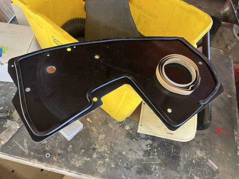

Today's progress seems like little was done but it was partly because each move had a few steps to it.
First up, I had to cover this:
With this:

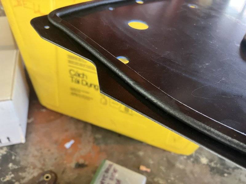

The Vintage Air instructions state to put a bead of silicone sealant around the perimeter of the back side to seal off water and vapor. I used 5/16" butyl tape normally used for setting rear window glass.
I had some left over from when I had to replace my rear window in this car:

This ought to seal out the elements.
Looks good to me.
The evaporator is back in and the lines are in place.

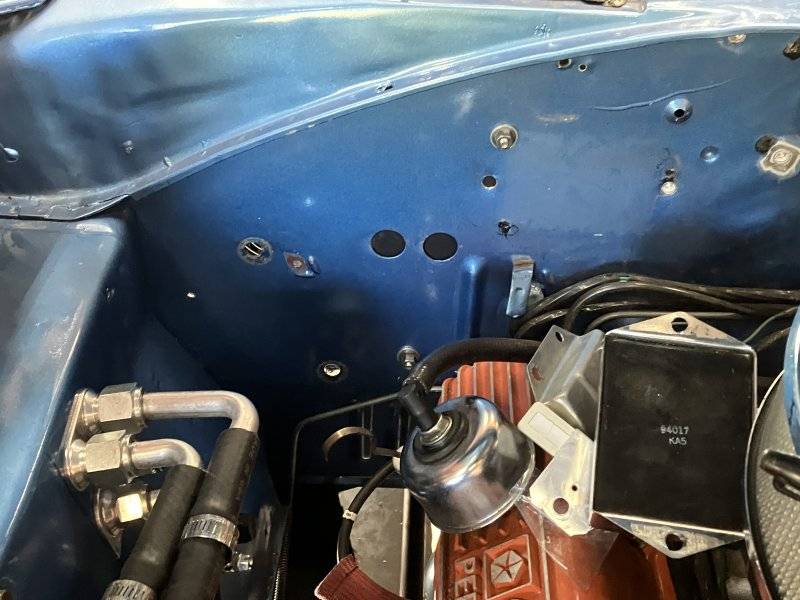

One thing I have to do underhood is to mount the ECM, Ballast Resistor and Voltage Regulator.
I should have taken a direct "before" picture but I failed to do so. The best I have is this:
This is what I see: BR= Ballast Resistor, VR= Voltage Regulator.

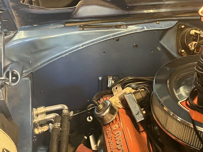

There are a few ways that these can be mounted. The first arrangement had them almost even across the top.
I like that except there is an exposed hole visible above the voltage regulator. It is blocked on the back side by the sound deadener but is unsightly. I ran them like this in my Jigsaw Charger:
Staggered a bit to sort of follow the underside of the cowl pinch weld. On my other Charger:
I used a standoff bracket for the ECM and Voltage Regulator so the stagger isn't as even as it is on the car above.
With the firewall plate not actually touching metal on the firewall due to the butyl rubber tape/ribbon, I'll have to put a ground strap on the ECM like I did here:
I test fired the engine a few days ago and without the ground strap, the ECM doesn't produce spark.
Dwayne likes the layout that has the components staggered to follow the pinch weld. I'll mock them up, take a picture and make sure he likes it before I drill holes and mount everything.

The tape starts out at 5/16" and then is squished a bit in the roll. You can see where it flattens out slightly here:
Once compressed, at best it compresses to 3/16". I could pull the firewall plate and put actual gel/liquid sealant on it if you prefer. As it is, it sits close enough to look good. Your call. I used this because it was free and because I had it here already.

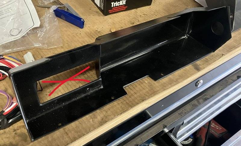

Next up is to route the wiring and run the ducts. Awhile back, I was curious as to why VA sent this plastic glove box liner:
It also has that rectangle hole, I'm guessing for access to the fuse panel? It is wider than the fuse panel and in the wrong spot. This fuse panel is attached horizontally along the bottom of the dash frame. If I used this liner, I'd need to block off that hole somehow. I did test fit the original liner awhile back...

Back when I test fit this, I just figured they included that plastic liner as an option. It is a lot thinner than the stock one:
You might fit a bottle of water and some napkins in the plastic one. It is not big.
