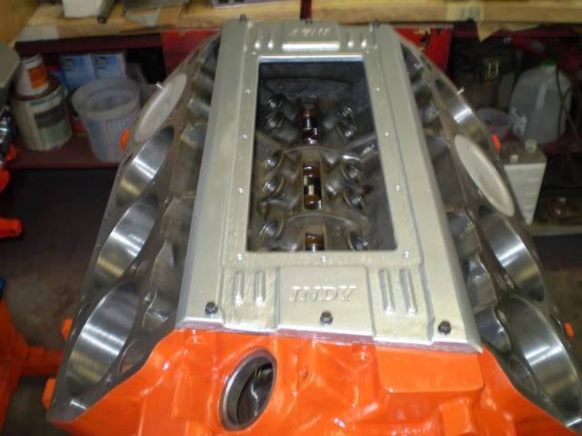

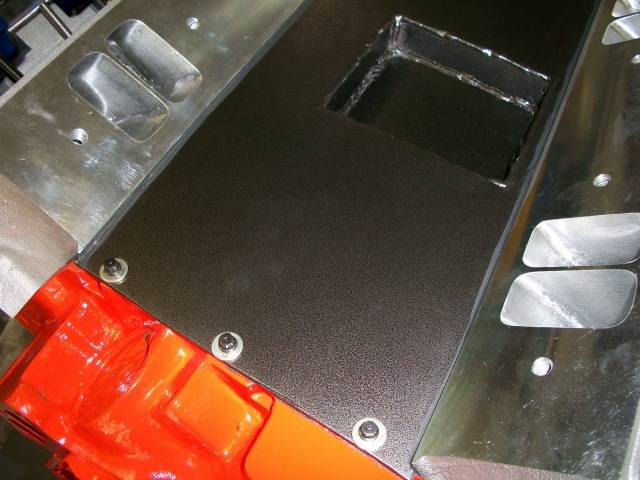

sounds like its time to eliminate the valley tray all together. i ended up making my own so i didn't have to cut the heat crossover off my six pack manifold. only down side is your looking at pulling a head for a cam swap. if your looking at leaving the single plane on i would invest in an indy with the removable top.

The one I took off was like the one in the top picture. It was a 440 source unit. If you made it out of a heavier gauge metal, I think it would work. I have had minor oil leaks with mine all season. It worked fine on the street, but always had oil when at the track.
I have the Indy 2 piece valley pan and to is trapped by both heads so one does need removal to take it out.
I'm seriously considering adding a plate under my present intake like the one I had on my old M1 for ease of sealing and removal.

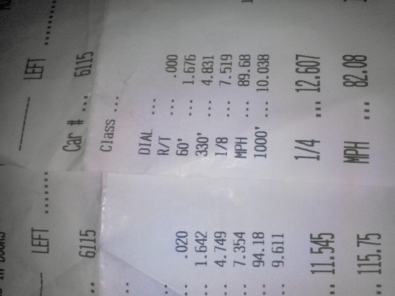

Well, I had nothing for today. First pass was a disappointing 11.54. Unfortunately that was my best pass. I have a lot of work to do. Time is almost out for this year.
Silver lining for today was reaction times

i wouldn't be to disappointed. just shows how well you had the dual quads tuned. my experience on a street car its pretty hard to beat a dialed multiple carb setup on a dual plane no matter what everyone says. looks like the single plane hurt the 60ft.

spun the tires a little on both passes. I hate going backwards with improvements.
