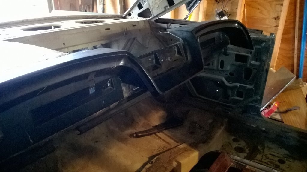

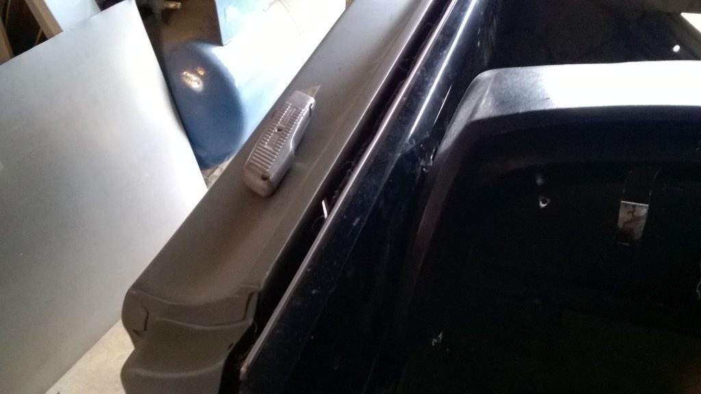

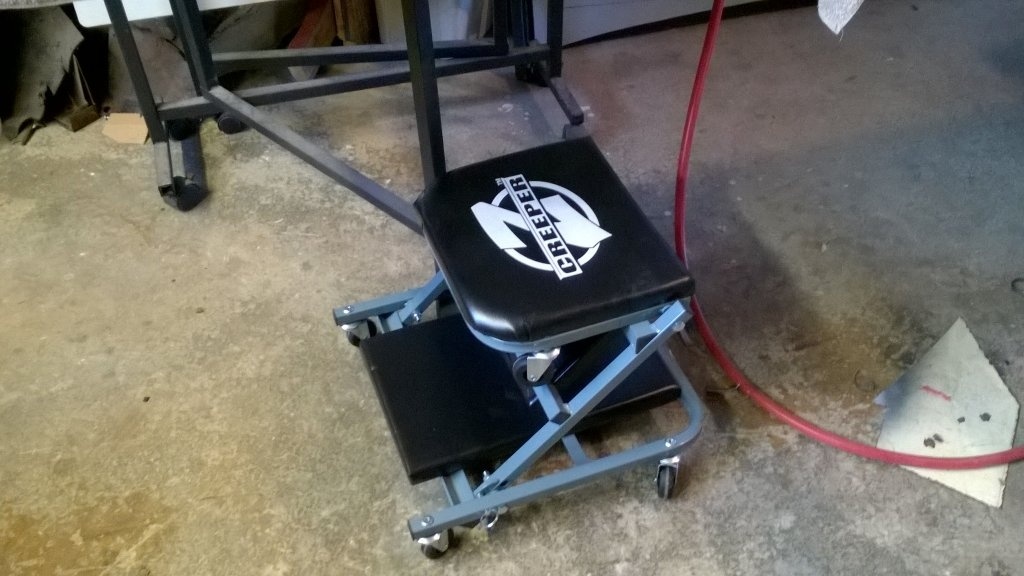

Put together my new Z-creeper and hung up the new metric shorty articulated ratchet wrenches I got for my birthday. Primered the trunk deck and touched up some spots around the door frames that had gotten scratched. Began cutting a template for the roadster panel behind the buckets. Using the 67 Satellite seat topper as a starting point and deciding on an overall shape on both outer ends and the middle section. Also whether it needs to be several sections welded together at different angles or a one piece that's bent to shape. I guess it will be several because of all of the angles involved. I might shape some bars in the silhouette I need of the panel , kinda like a buck for fiberglass molding and body clay. It will take several as the shape tapers off to rear. Once I have that done I can set them out on a flat surface in the correct positions and elevations and then make templates for each section and build it that way. Tacking them to the bucks and then to each other after final checking and positioning. I want to be able to set the entire panel down in place and then the Satellite topper over the leading edge and bolt it down. I have already cut the upper rear door / window inside panels that go above the vinyl door panels, to fit down over the fastening points of the wing. Now I need to get the roadster panel done so I can see how it will have to be fitted to the panels on both sides. I would like to use aircraft DZUS fasteners on the underside to sandwich both panels together. If you can visualize, or Google, what a 66 T-Bird trunk lid looks like you will be looking at the basic shape of my roadster panel. The rear edge of the t-bird panel would be the front edge of my panel and the taper faces to the rear. The Satellite seat topper is shaped like a wing too and the T-bird shaped deck lid is very similar.

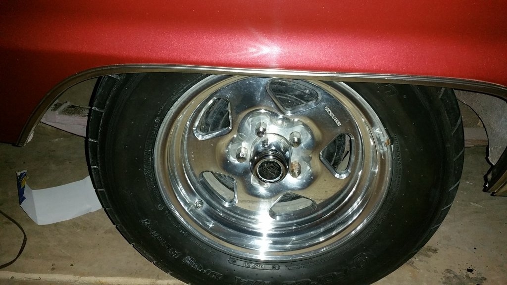

Today after work I started to get ready for a benifit car show this Sunday. It's a toy drive for under privileged children that a friend of mine puts on every year. I support his cause even though it's a Corvette club.
I started by checking the passenger side for any spots I missed when I buffed the paint. I redid the passenger side sail panel and started polishing the rims. After three hours here's what I did so far.

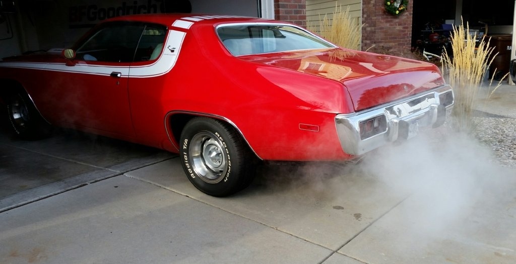

The last run for the season before she got a bath and tucked away under her cover for the winter. This however, is the latest I have waited to put her away, because of all the warm weather. You can however tell its getting cold here finally with all that condensation in the air it was about 35 degrees when I ran her today.

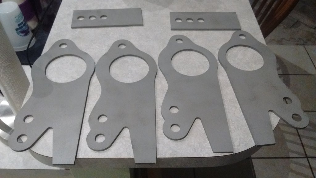

lazer cut and blasted 4 link brackets. This week narrow housing 4 inches.
