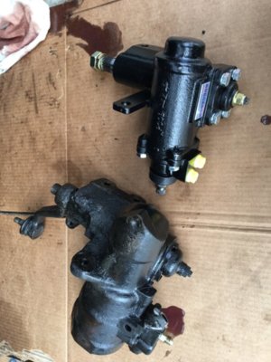

trying to get steering link off to remove old power steering box and slide in the Borgeson
should the steering link just slide off after four bolts are removed?
had to call it a day. so close yet so far. i'll start a thread to cry about it :D
watermelon
old one out. came out the bottom. had to disconnect exhaust at bottom of stock exhaust manifolds; added about 5 mins

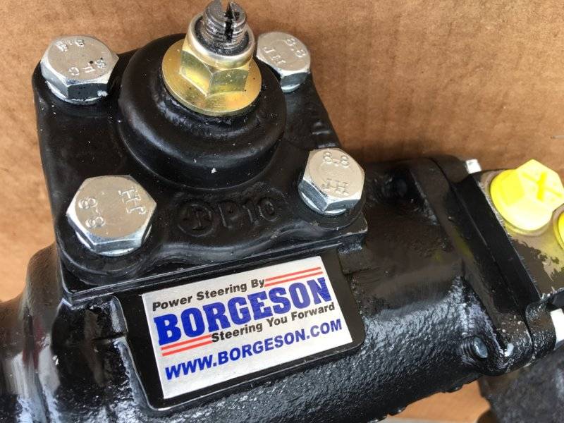

new borgeson box ready to go in

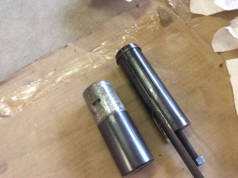

Pulled rear trans bushing today, tool worked great. Not to optimistic about driving new one in without dropping H-pipe. Not much space between pipes and crossover pipe is right below end of tailshaft. Old bushing had about .015 play it's on the right. Picture of tailshaft crossover pipe blur on right. Puller and bushing driver.

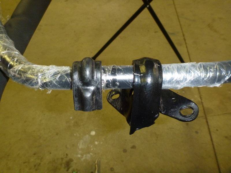

Well, I was a dumbass! I fired the charger up after complete rewire and many other things. Car has been in the garage since last June. Got it out for the big test drive of all electrical systems including new gauges and new digitail rear lights, firm feel stage 2 box, steering column fix, front sway bar bushings, and rear sway bar install. By the way the front sway bar bushings were a pain in the butt! After messing around, took to a friend, he cut brackets open, we slid bushings in and welded them up. By far the easiest.

Drove in my trans tailshaft bushing. Yesterdays pessimism was crossover pipe would be a problem. The bushing driver is 2" to 3" longer than the bushing. The extra length gets it past c-pipe. Picture with bushing on driver, mostly hollow except where you hit it.
