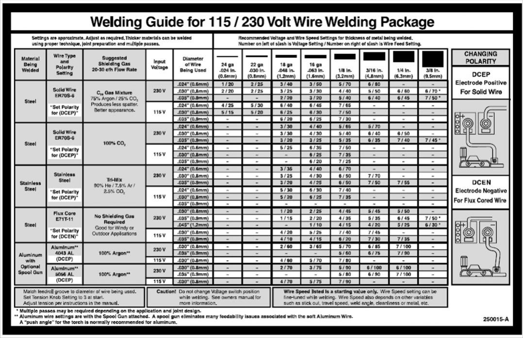

220 should be able to handle larger material for one and may or may not be a little cheaper on the electric bill. This chart is from a Hobart MVP.............
