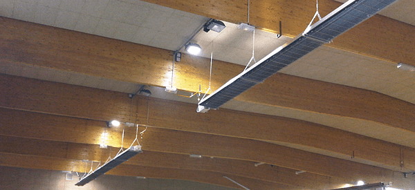

Use a radiant tube heater above your main work space at 1/2 the BTU's your are told you need for the whole garage
It will keep your tools nice and not let garage freeze

Those things are neat. Doesn’t warm the air really, the radiant energy warms surfaces. They used to explain it to us that in a warehouse it warms the people not the warehouse. How much maintenance are they / service life?
Something like a microwave oven. Doesn't heat the oven just whats in it.
Kinda--Microwaves shake up water molecules and that makes heat. - Radiant is felt on the surface. -Neither one warms the air it shines through.
If you want a warm breeze you need to warm the breeze.

My brother in law has it (radiant floor) in his basement so I'm aware of it's comfort just not for me. The whole warming the floor idea is great I just don't like the cost and the fact that you can never access it after spending so much on it. I'm liking the radiant tubes because they do heat from the bottom up and I have the ceiling space.

One thing I hate about researching is all the conflicting information.... err. Anyways after actually talking to a local company that sells Radiant Tube heaters along with many other options I'm shying away from the Tube heaters, says they aren't anywhere close to being as efficient as the ceiling mounted heaters. He recommends an 85,000 BTU Modine, it works just like a home furnace with fresh air and exhaust piping and are 93% efficient.
