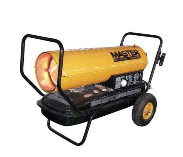

Loving the smell of diesel in the morning
I use K1 and no smell. Heats the air and that's all you need. Heats 30 x 50 x12.5 (3) bay garage in 30 minutes just fine. Run ceiling fan to keep heat at floor level. Walls not insulated. Doors insulated. Ceiling insulated with 3'blown in fiber.

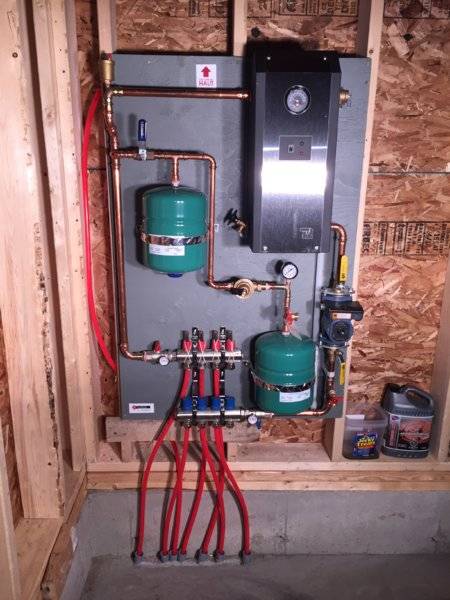

One other benefit of in-floor radiant heat no one has mentioned is the reduction in insulation costs. Heat loss increases as the indoor/outdoor temperature differential increases. With radiant the air temperature will be the same at the ceiling as it is 12" above the floor. Hot air rises so direct air heating sources cause a greater floor to ceiling temperature differential and thus a need for heavier ceiling insulation.

Just trying to understand. In floor is radiant heat and the overhead tubes are radiant heat. How much more efficient is the infloor? I know the initial cost difference is huge for a project like i am going to undertake. So thinking short term and long term.

The water does not require much heat to provide a comfortable temperature. 85* is about the maximum temperature for the floor surface or you will become uncomfortable. Therefore less fuel is used heating the water, depending on the efficiency of the heat source/boiler.

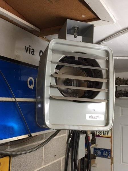

I use electric 220v ceiling unit. I installed this over 10 years ago. I works great and I keep the garage about 50 till I work in there. As a bonus I unhook the heating element so it's a fan to move air in the summer. This was about 2k cheaper for me at the time over gas. If I was going to do it over again I would use a 2 piece wall unit. AC plus heat because as I get older the heat is starting to get to me more and more. Now the garage had R40+ ceiling R15 walls with drywall and insulated garage door with seals when I moved in. With all that insulation the side door had no seals and a dog door. I installed a insulated pre-hung door that made the garage easy to heat.

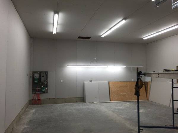

If you want to add a lift of some sort or anything else that you need to sink anchors in the floor how do you know you wont hit a line?
That is my concern.
Run a wire beside the line in the areas where the lift might eventually end up. A metal detector will find it.
Good idea. Tracer line like my buried LP line. Hadn't thought of that. Thanks
you can use a hot water heater for a boiler in a barn seen it done works good and cheap we found lines in concrete with an infra red camera, was attatching wall plates to the floor didn't wanna hit them, no more than 2" deep in this application standard concrete. these tubes were about a foot apart.
