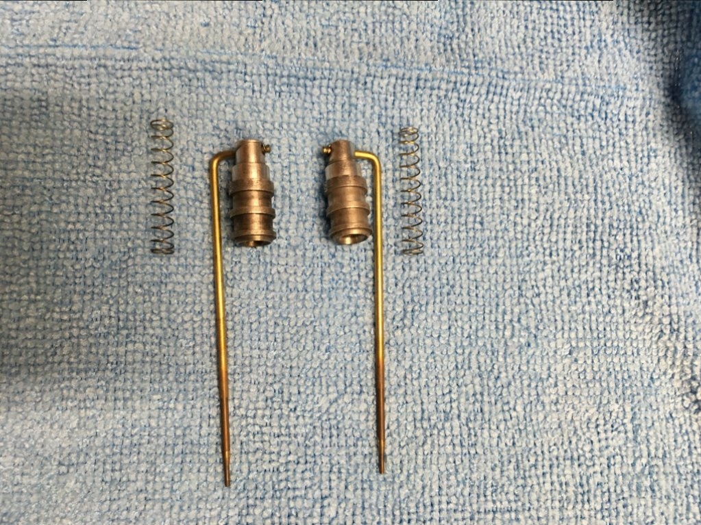

Carb metering rods and springs are clean.

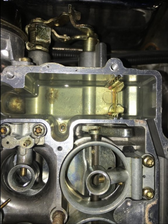

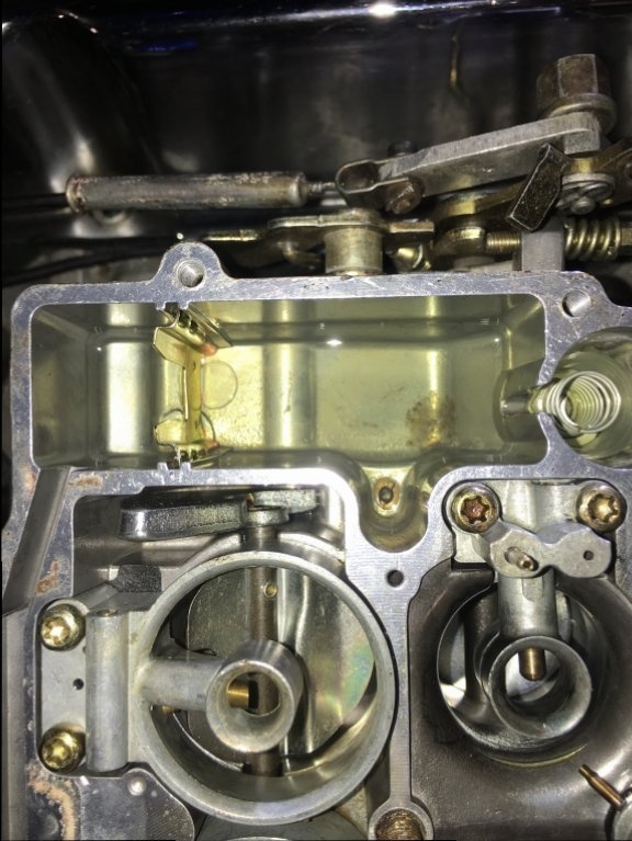

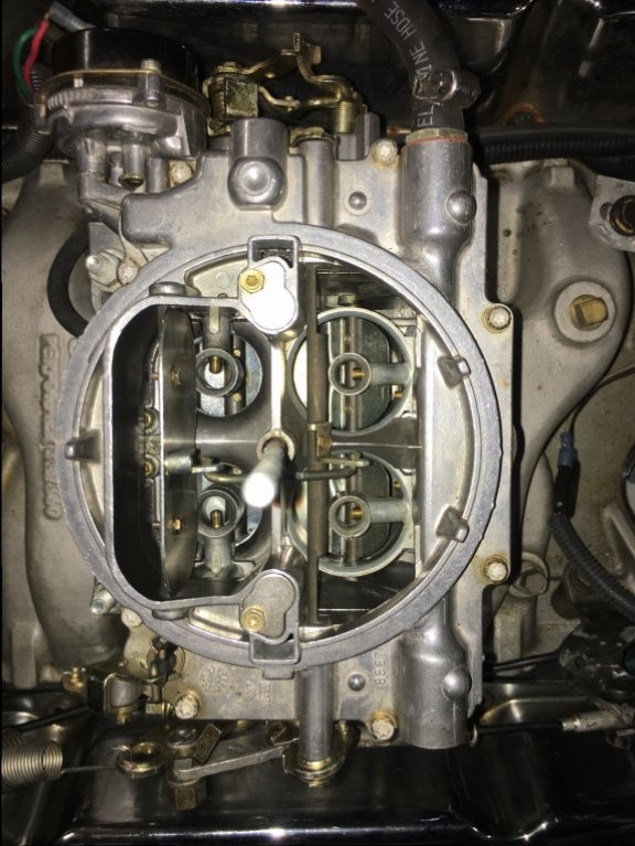

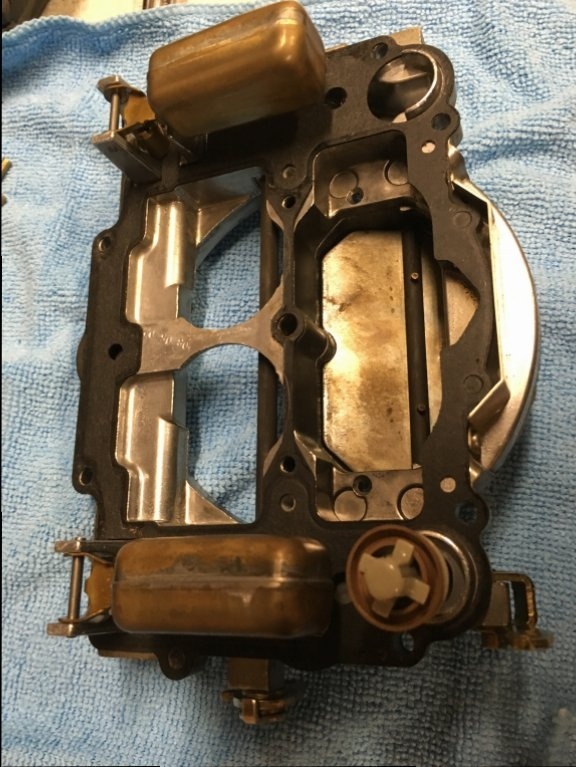

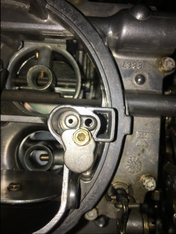

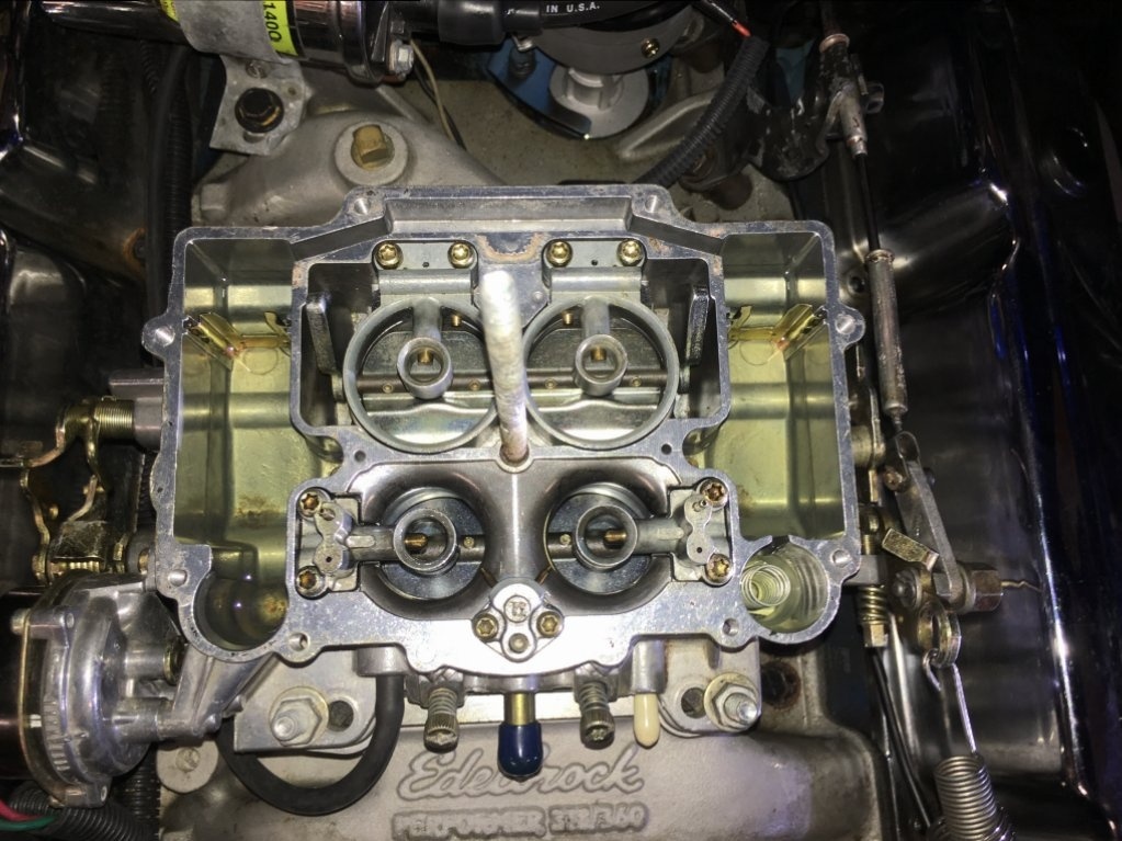

Ok I really don't see anything wrong with the carb.
But, not sure if gas is supposed to sit in those areas like that. Look at the pics. This has been sitting over night.
I see you said the idle mixture screws are clean but it's the passages that usually cause the issue. Spray carb cleaner into the holes that the screws came out of. You need to use the little straw.
Gas is indeed supposed to sit in there.
Check your float height while you have it apart. 7/16"
Yep I checked the float height it's right at 7/16
Do you have a fuel filter on the line? Could be as simple as that being clogged.
