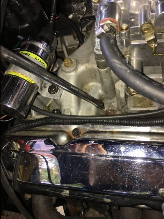

Found an area that decreases rpm. Passenger side, rear, by the solenoid.
Intake gasket maybe? Check the plugs on that side, especially #6. See if it looks leaner than the others.
My bad. I meant ignition coil. Anyway, there is a pic of if.
