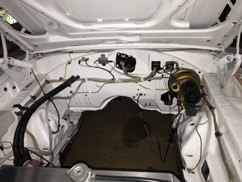

Hello guys!
Here are some pics of the progress so far.

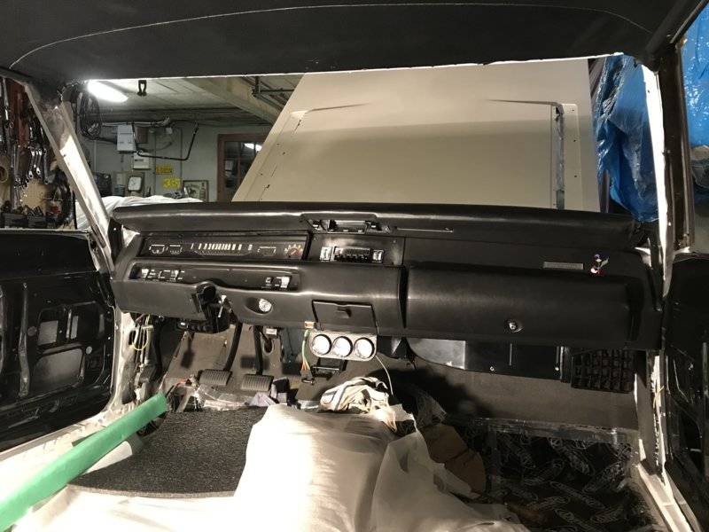

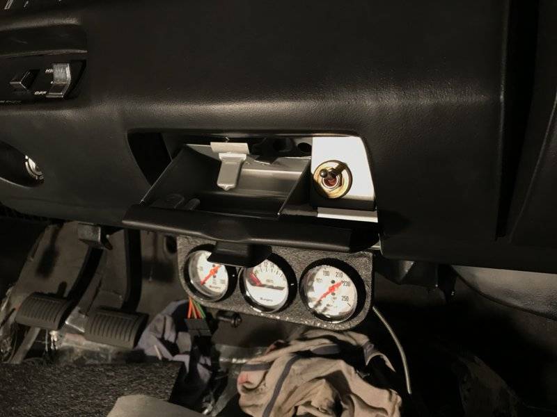

The little switch you see in the ashtray is the switch to force the electric fan if we wanted to make it run manually. Replaced the lighter by the switch so it's hidden and the dashboard will still look stock.
All the wiring harnesses have been put in a "girdle" think this is the right word lol

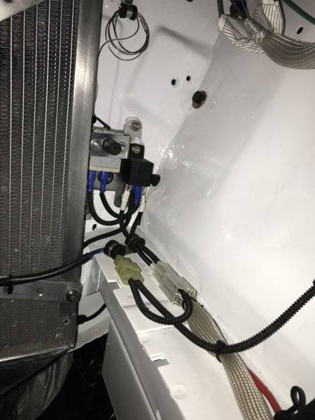

The last pic is the wiring for the electric fan.

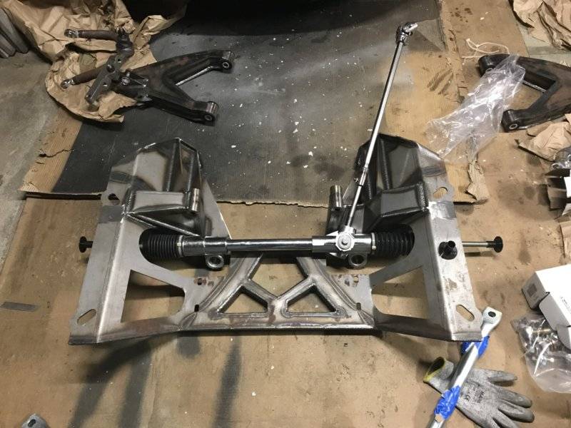

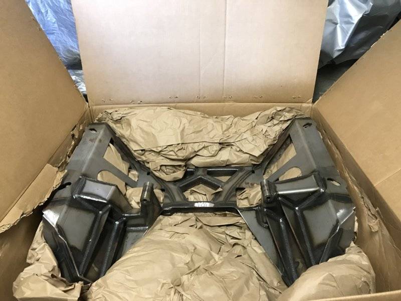

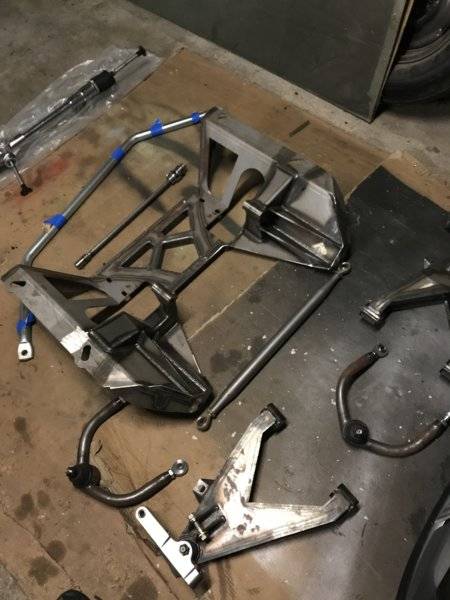

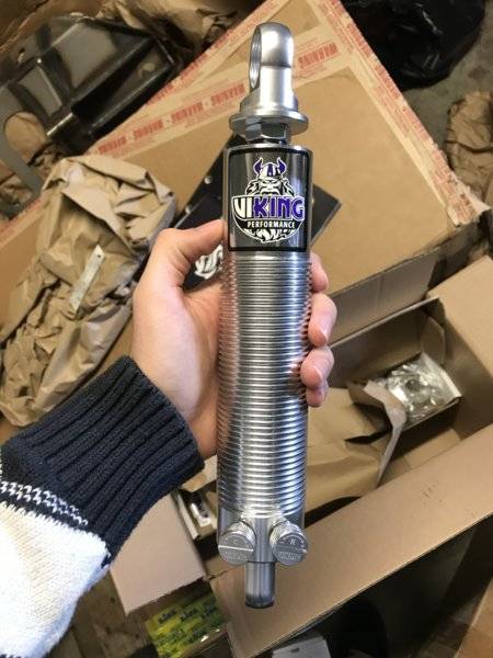

First of all, we finally bought a tranformer Kmember form Magnum Force, with manual rack and pinion, double adjuster viking coilovers. It was a real pain to get it. It was during their moving to Las Vegas, so it added some delay on the preparation etc etc. After 5 months it finally showed up here in France what a relief especially after such an investment. The only thing was that the rack and pinion bushings were missing... So I called them letting them know about that, and I would say that it was pretty cool from them as they recognized their mistake and shipped some right way to me free of charge. Even after 9 months so I was pretty happy about that.

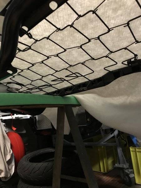

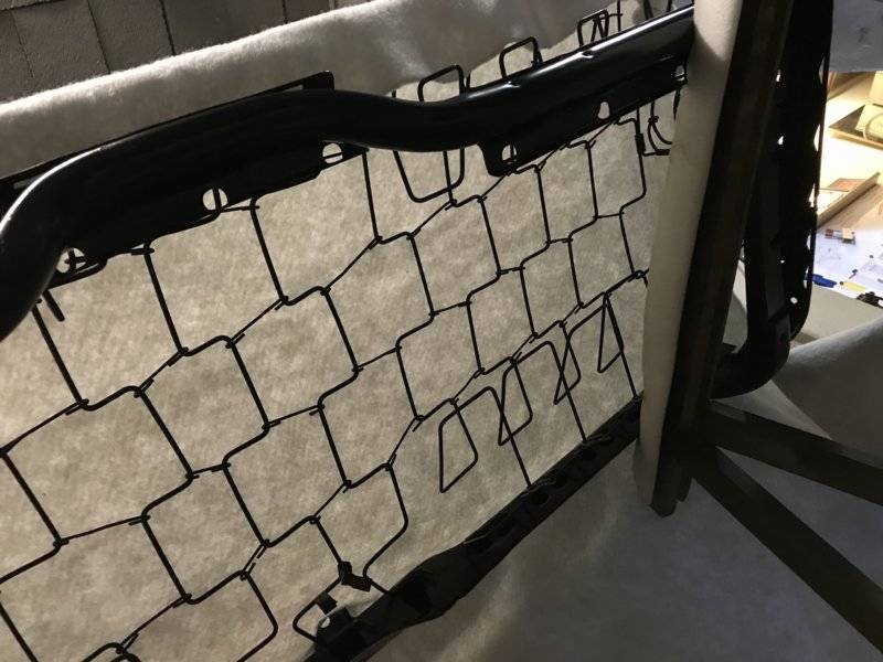

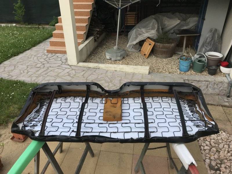

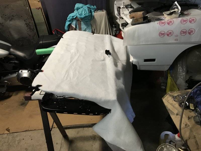

- Bench seats :
Front one, has been tore down completely
Sanded the shell
primed it then painted in black
Bought some new foam
rebuild it and reassembled it
Put back the upholstery on it as it was new when we bought it
strengthened the spring on the shell to get a firm sat
Same operation for the rear bench seats

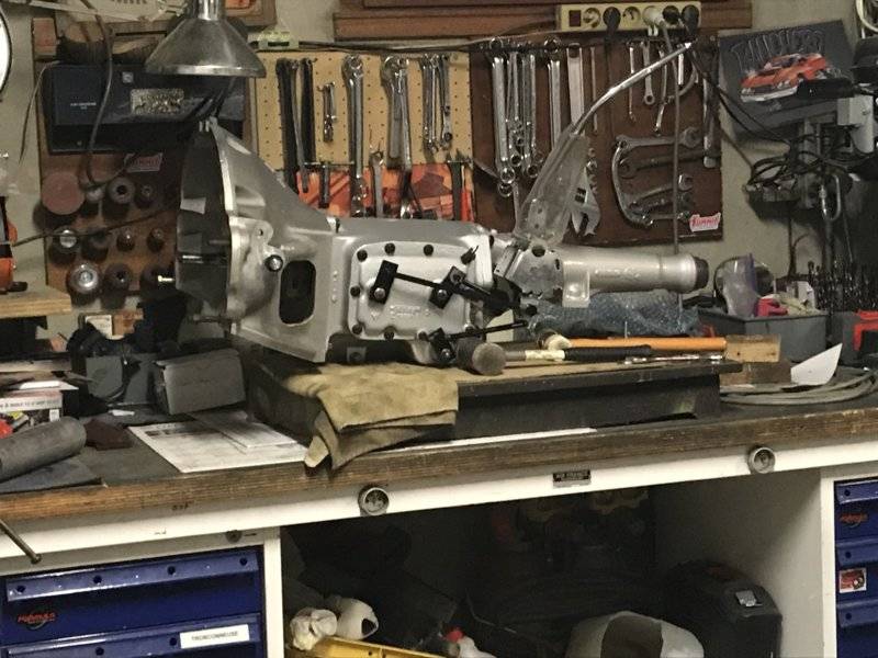

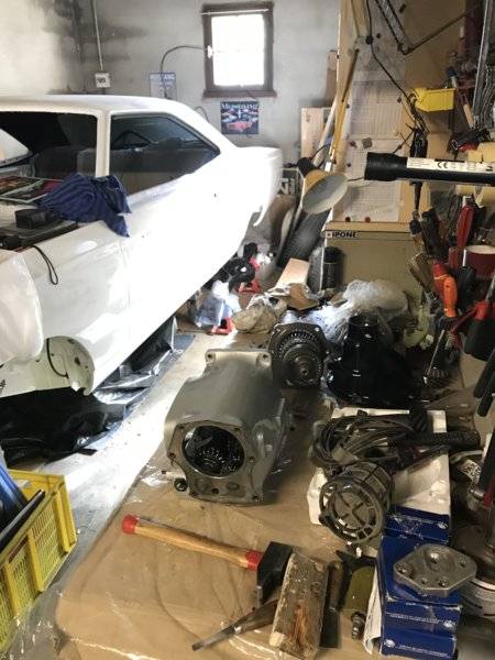

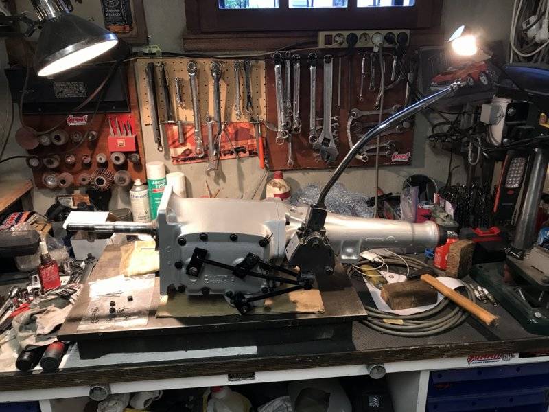

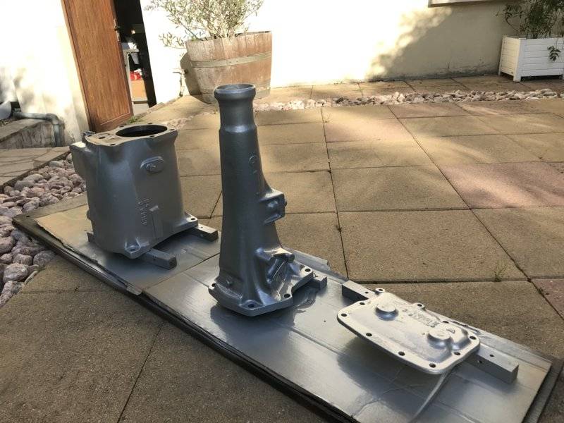

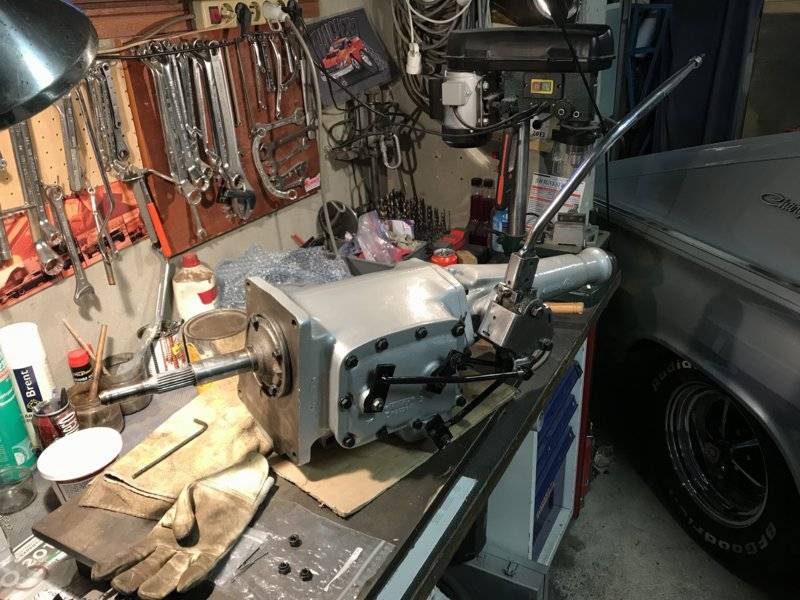

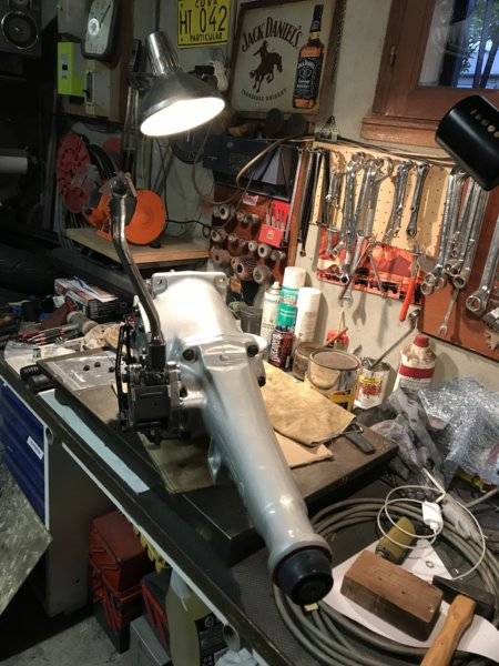

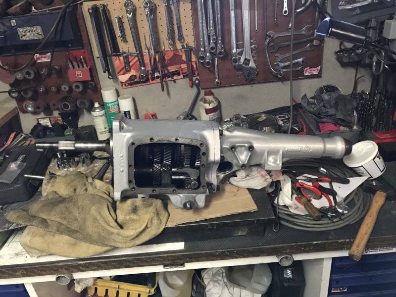

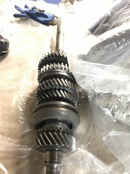

- Transmission :
Disassembled (except for the countershaft end play was good and rotated freely)
removed all the gears from the shaft
Changed the bearing as well as the needle bearing in the input shaft
Every single seal has been changed on the levers and so on

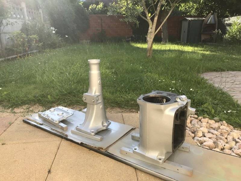

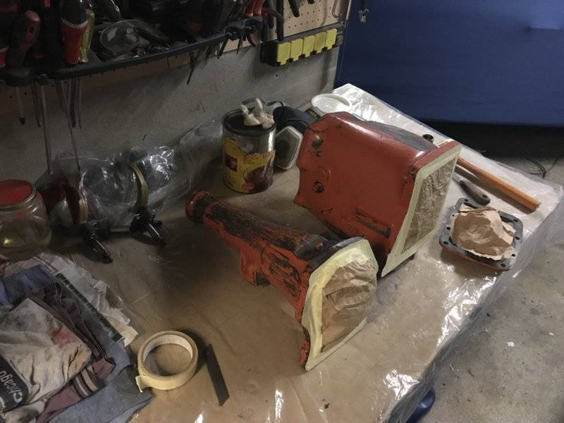

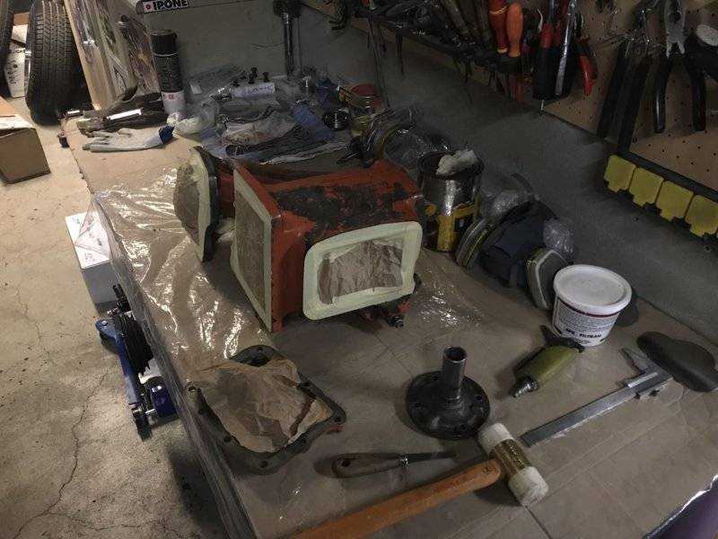

Sanded to bare metal the case and the tail
Epoxy primed it
Painted it with metallic grey then clear coated
Fully reassembled
The shifter mechanism is back on and adjusted properly (I presume lol)
Installed the bellhousing too

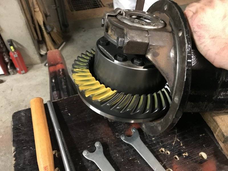

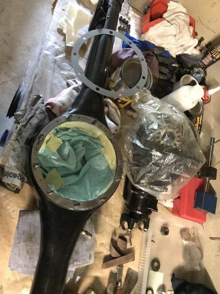

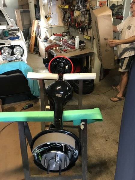

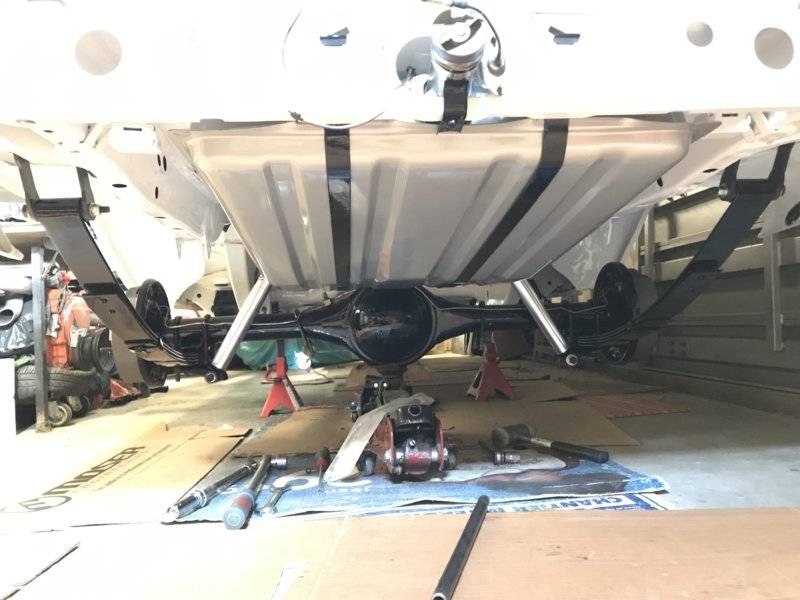

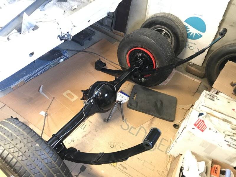

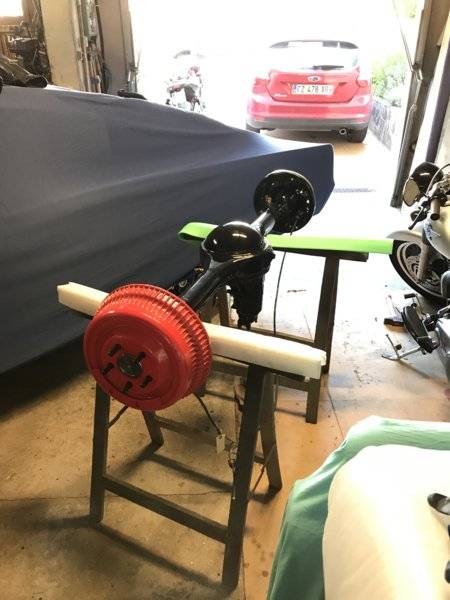

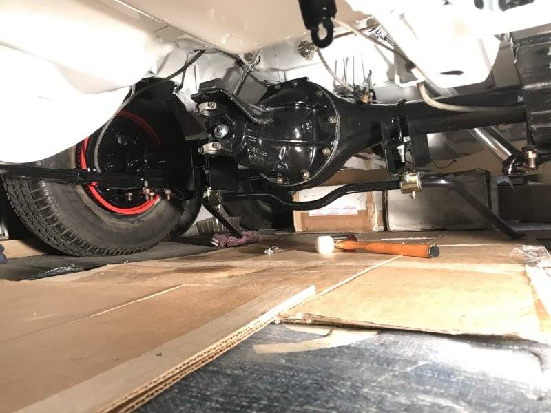

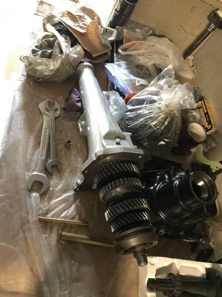

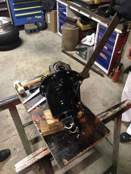

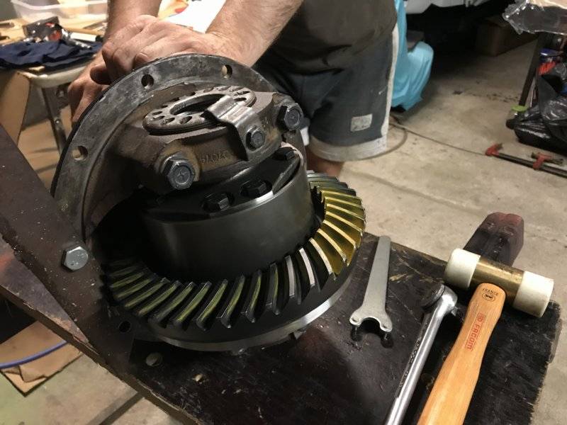

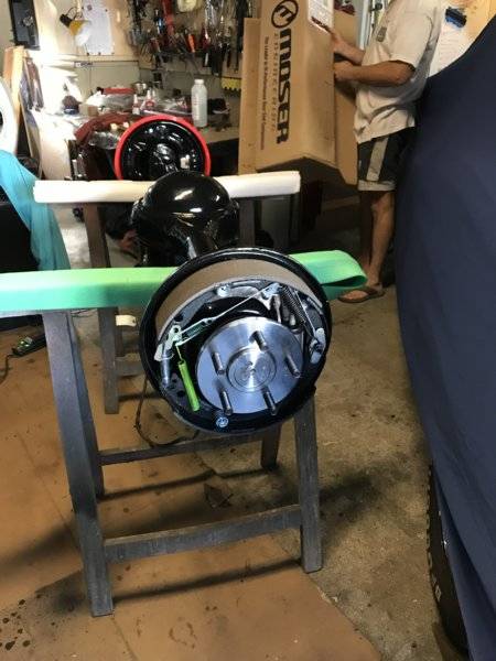

- Rear end :
Bought everything new except for the main case and third member.
Every internal parts are new
New tapered Timken bearings
New axle shafts from Moser
New axles, flange, plate, carrier seals

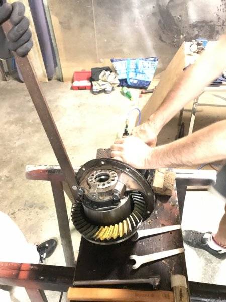

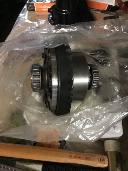

New ring gear and pinion from Richmond : it's a 3.73 ratio
New Eaton truetrac
Assembly of the third member is finally done with a good centered pattern on the ring gear tooth
Back lash is set good too between the tolerance of the service manual
With the third member installed we installed the axle shafts in
Set the end play between the tolerance of the service manual too
Rotates freely
- The car :

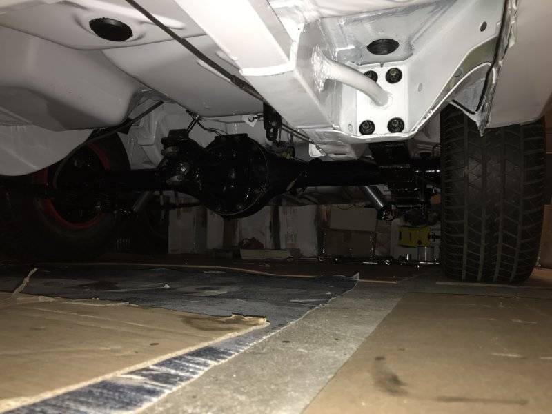

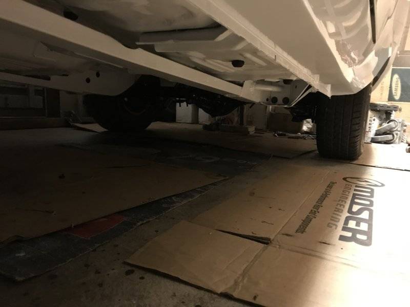

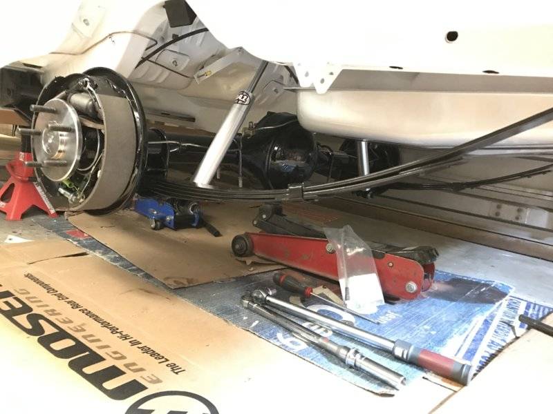

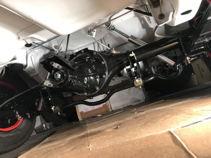

Put back the leaf springs on the rear end
installed the rear end on the car
Suspension attached to the rear end

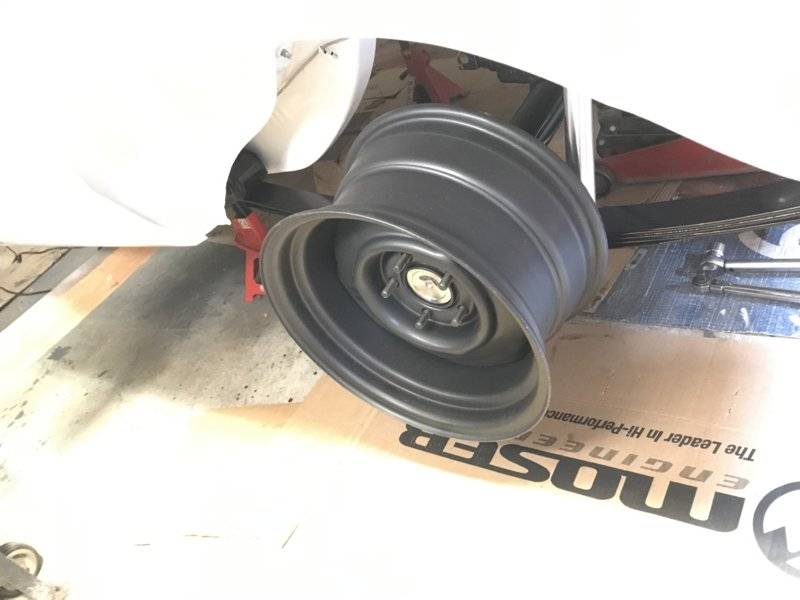

Put back the drums & the old wheels
The old wheels will stay on the car till we finish it completely
Once it's one will put the new rims on it! can't wait to see that

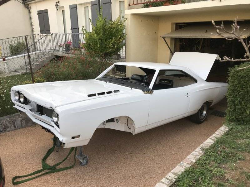

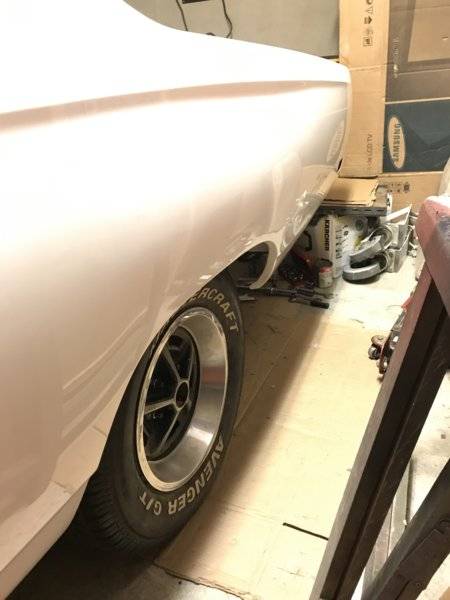

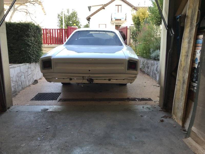

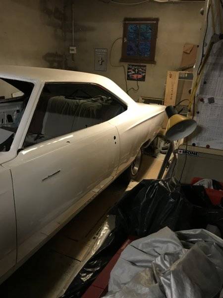

Finally the car is back on the rear wheels after 4 years!! What an emotion it was to see her on the rear wheels!

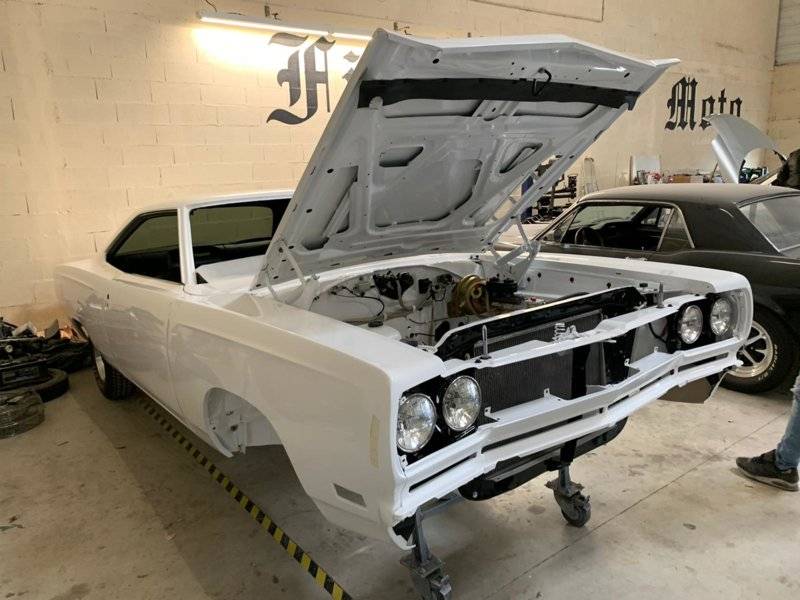

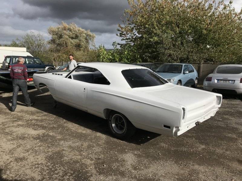

With that done, the car is now in the paint shop for the final stage, which is the flat black hood stripes and the clear coat on the rest of the car.
Then once the car returns from the paint shop, we can start the reassembly process. :)
Next part of rear end pics :

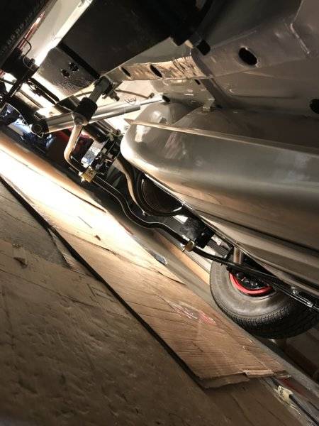

Rear sway bar installation :
This is the original front sway bar that we modified to fit the rear end. We also made the support for the bushing. The end links, we bought them here in France, they come from a VW Golf if I remember correctly.

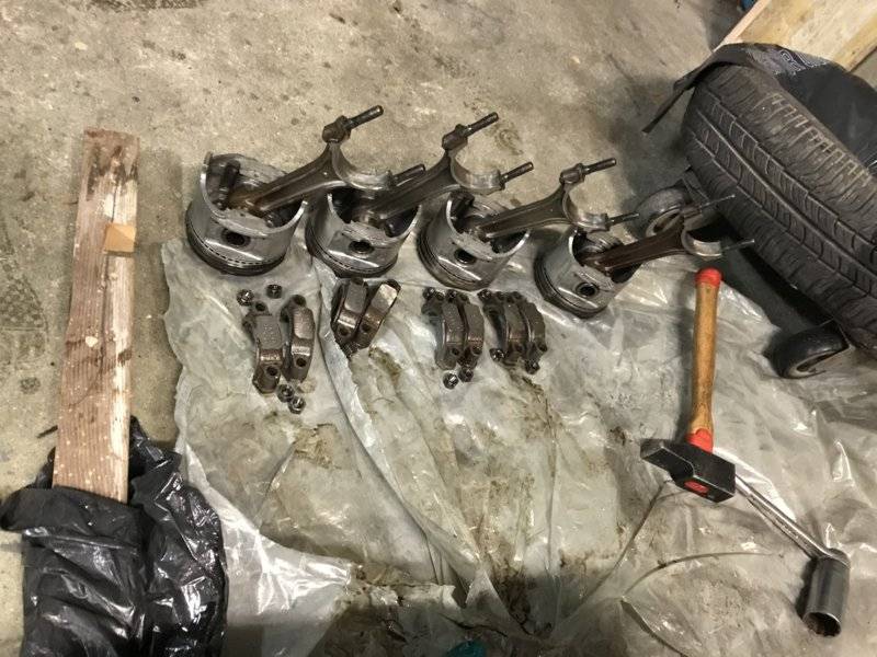

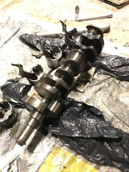

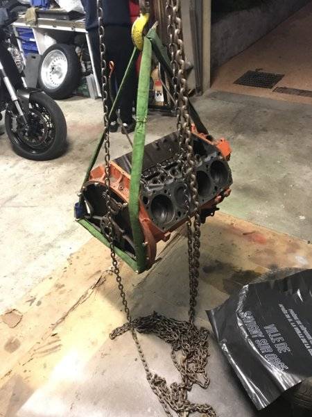

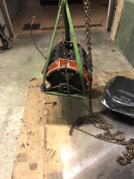

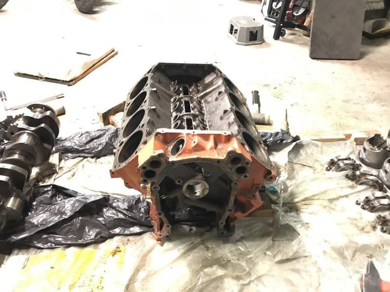

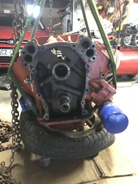

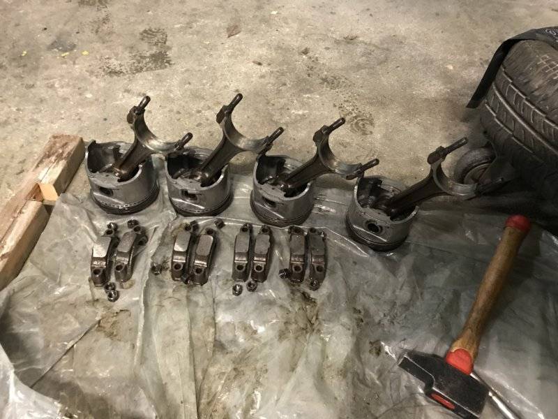

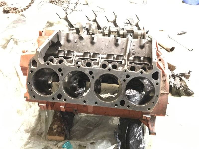

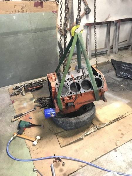

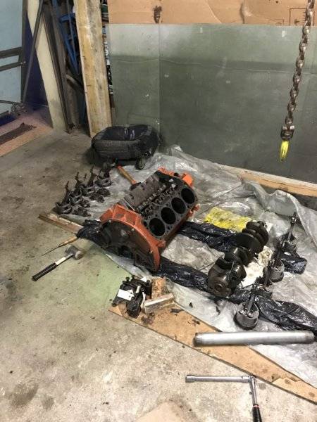

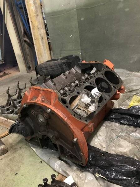

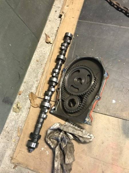

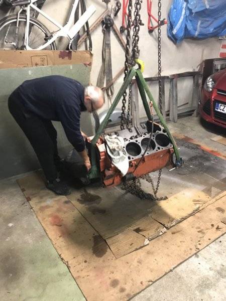

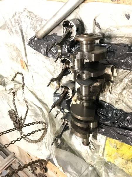

Now that everything is done on the car, we repair everything we had to repair or refurbish or everything else we could think of, it was time to talk serious and start the engine disassembly ^^
We knew that the motor was shot, the internal parts more precisely. This is our first Mopar true, but we knew when we rode it, that something was wrong with the engine lol.
But we didn't think it was that bad lol.
The engine will done by a French Mopar guru this is the only thing with the paint that we won't do on the car.

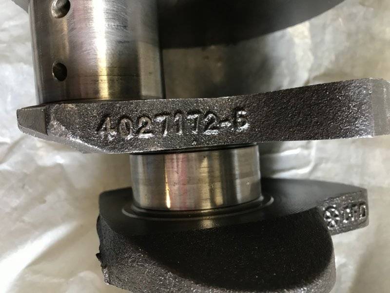

When we tore it down, the more we digged the worst it was lol the crank is shot, the pushrod one of them was longer than the others. The crank shaft pulley was shot, the output crank shaft bearing was shot were we slid the input shaft of the trans in (don't know if it is called like that).
We were lucky by doing so "much" kilometers with an engine that shot. We used it like that for almost a year...
here are the pics :

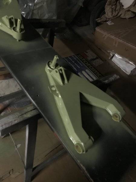

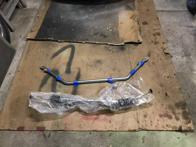

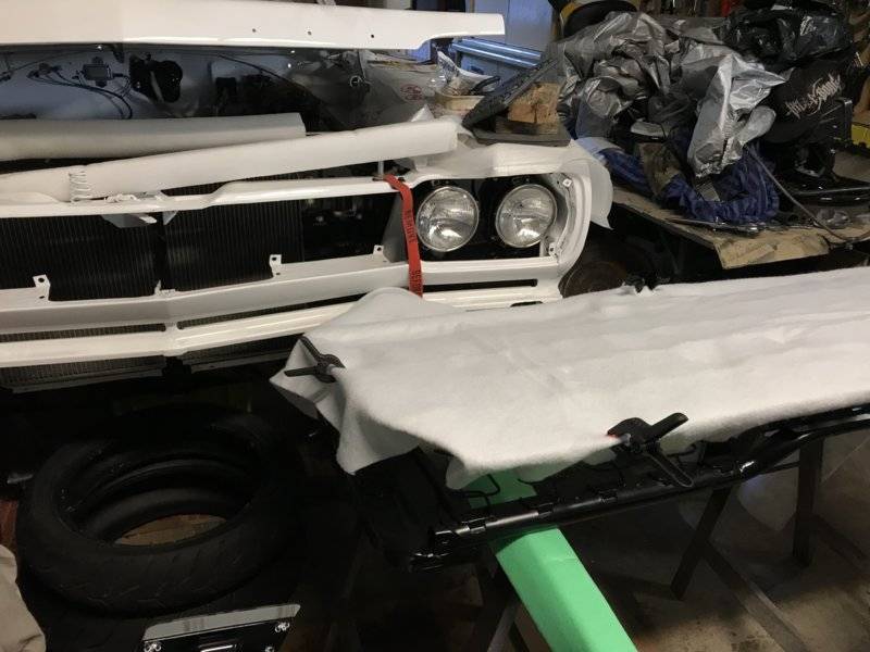

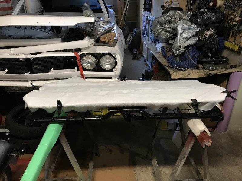

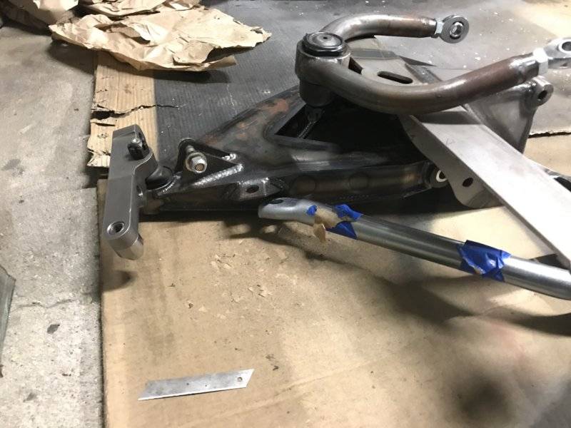

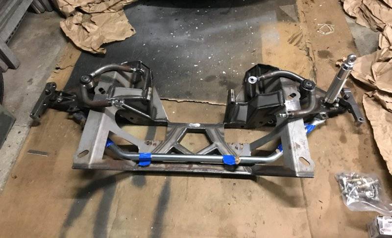

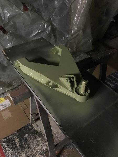

Now lets see some front end parts :
We ordered it bare metal so we could save like 700$, which paid the import basically. We have good epoxy primer and paint so we wanted to do it on our own.
